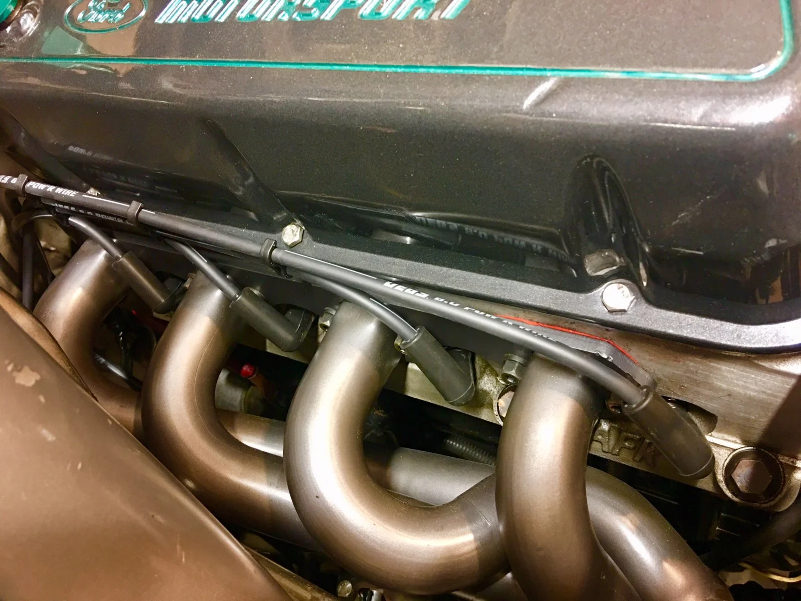

Ok, maybe not. I love how the plug wires came out. Nice and neat.
