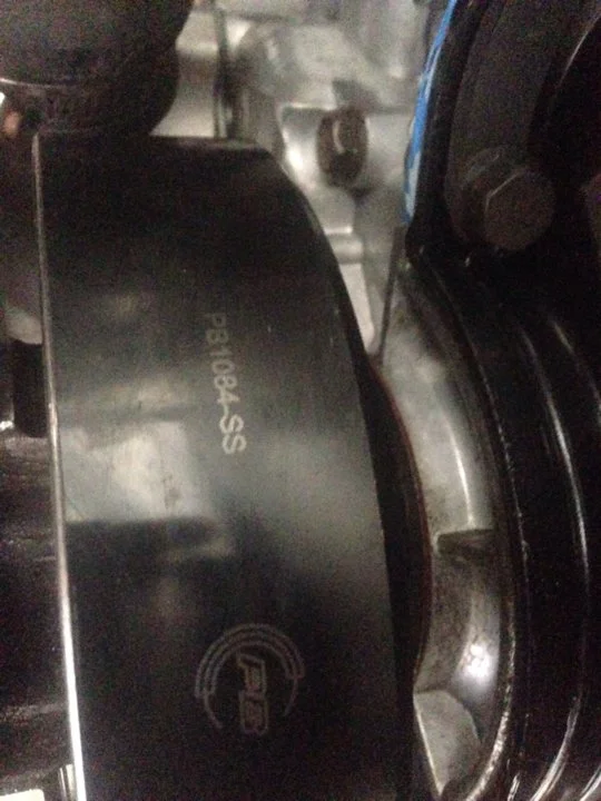

50oz Power bond (dayco) 1 peiece sfi balancer .

I have checked balancer bolt it's tight as well as my crank pulley . ran car and checked in inspection plate and the pressure plate and flywheel do not seem to be wobbling . Drive shaft is tight . Aluminum ford racing .

Here's balancer incase anyone was wondering , sorry this is long winded

I may have not wrote it lol - There is a very very slight one almost to say that it could be coming from the hard urethane mounts . Thanks guys for the responses so far I am glad I am not the only one . I keep thinking balancer but how could this thing go bad I don't see fluid or anything leaking?
