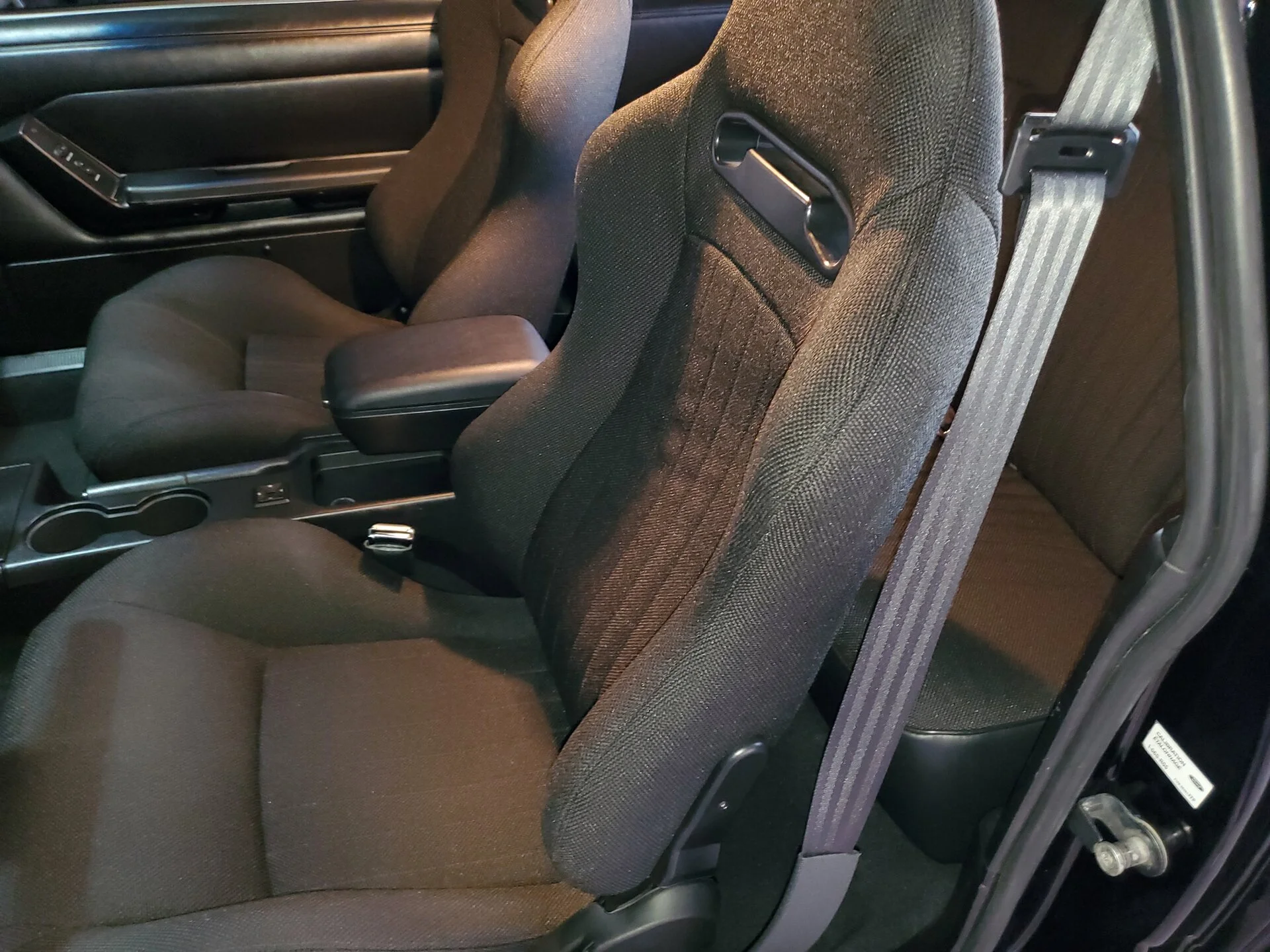

Yea, I removed similar seats because of the color discrepancy. Sometimes I wish that I had black interior.. life would easier.

I understand,just play the hand your dealt. I do love my black interior, and even though I daily her I always get comments on how new my interior looks. I enjoy my ride and hope you do the same.
Swapping to a black interior is very easy.

I know.. I also don’t have much interest is swapping. I’m difficult. Plus, someday I plan to repaint the car the original twilight blue and I think the blue interior will look great.

Oh the feel of these will blow you away, like stock on steriods. Seriously best seats I've had my arss on in a car, going into a 25mph turn @55-60 inspires confidence.
My car came to me with Cipherauto race seats. I recently had them reupholstered to match the stock style fabric. They are less than $500 new for both and are very good for spirited driving.

I still loved how my SN95 seats looked in the interior. I just wasn’t a fan of the lack of support and high seating position. Comfortable though.

I have nothing against gray. In fact, I almost added that to my original statement. I like gray a lot actually... when it’s fresh. I liked your sn95 seats too. But, I must say, the recaros are the ticket.

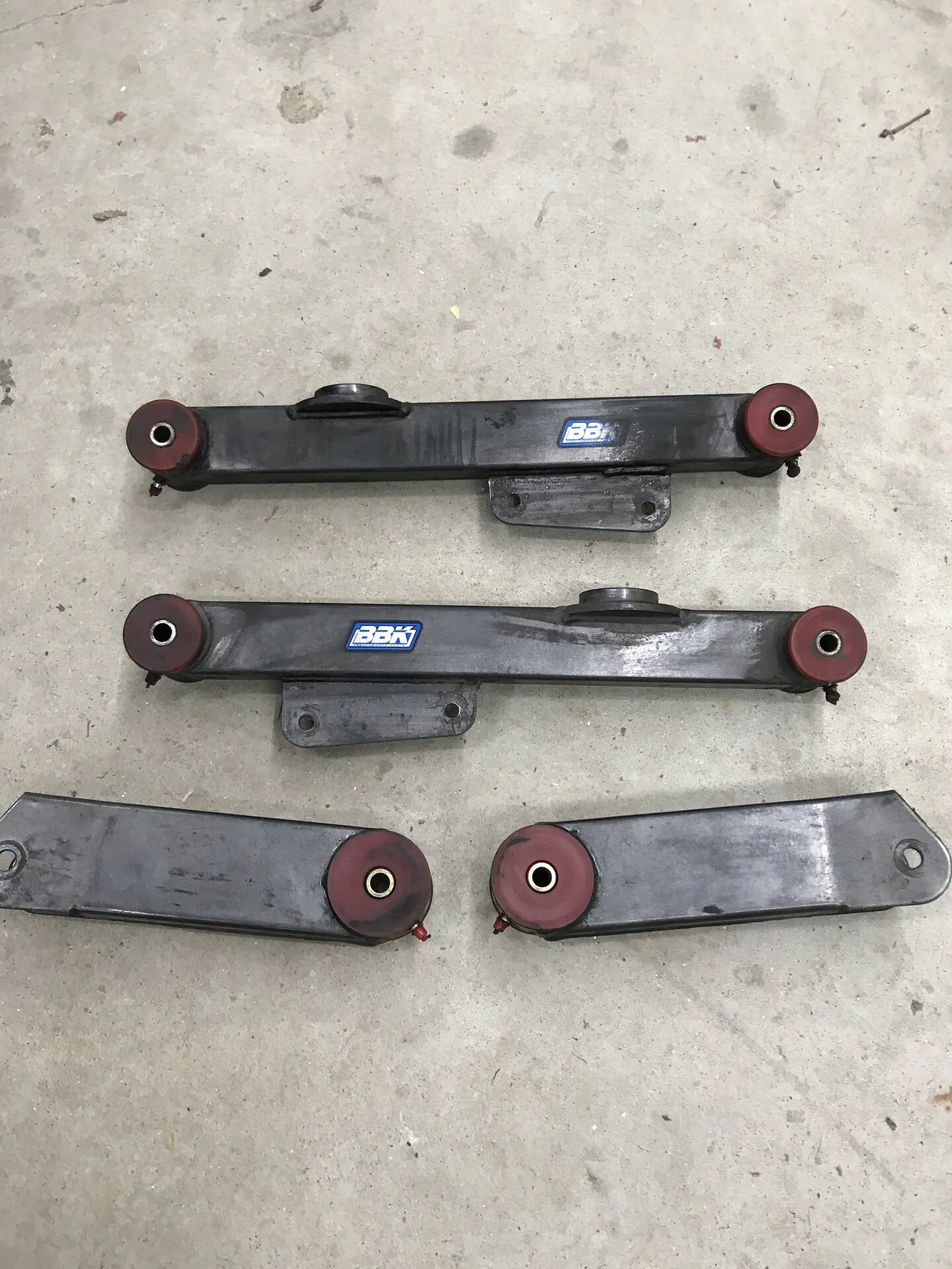

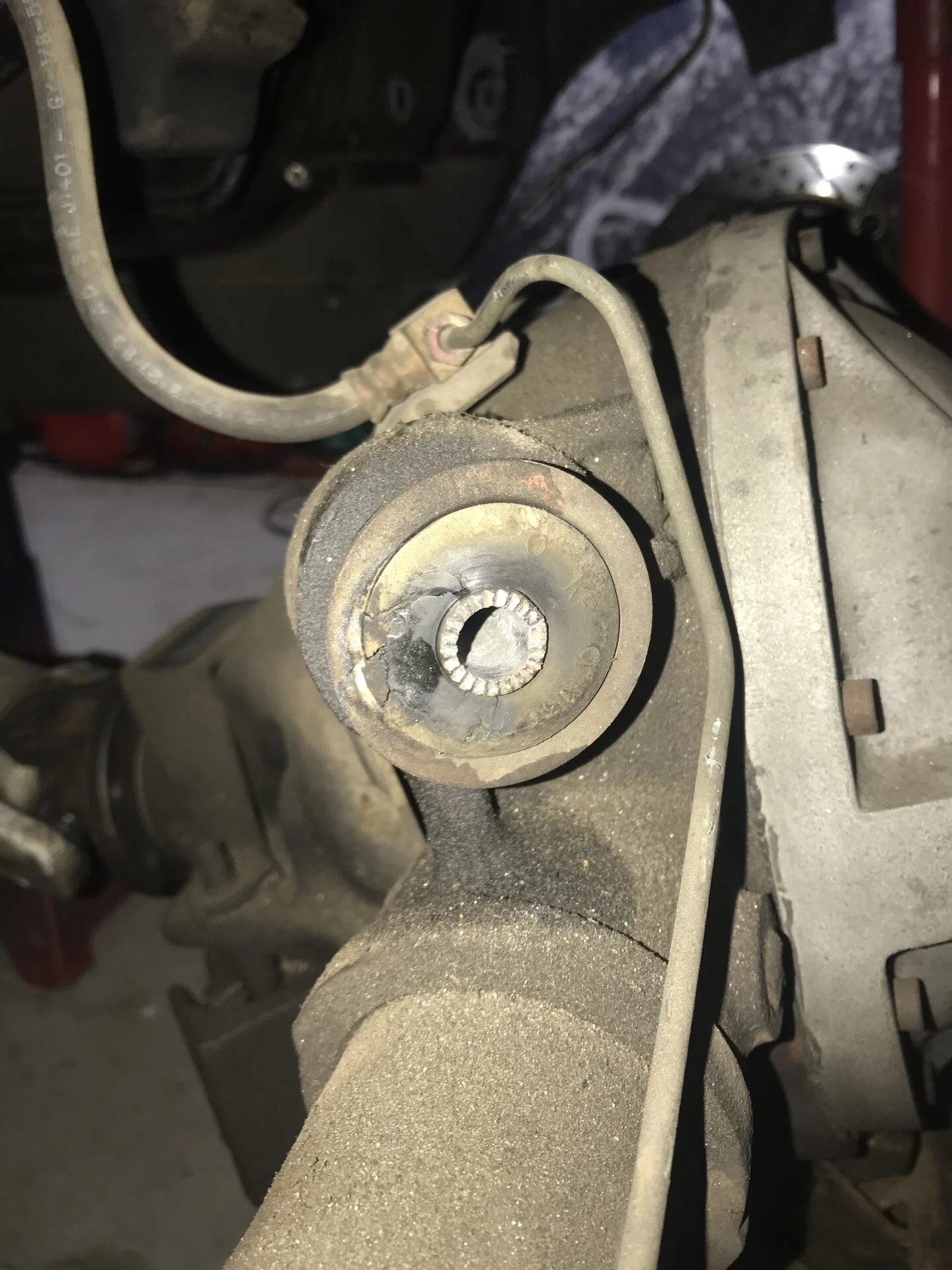

Worked in the garage today. Got a bit done but most importantly, I LEARNED A VERY IMPORTANT LESSON. I was finishing up welding my right SFC. When welding the front corner a piece of slag landed on the fuel supply line and burnt through, causing a fire. Fortunately, I always set a fire extinguisher close by when welding but it could’ve been A LOT worse. I extinguished the fire pretty much immediately but it was growing quickly. Now this is pretty much negligence on my part. I should’ve shielded the line with a piece of metal but assumed it was moved low enough out of the way to not be a problem. I’m very happy I didn’t burn my car.. or my house, considering my garage is in the basement. This has caused me to reassess welding safety while in the garage. I’m going to buy a welding blanket, a couple more fire extinguishers and try to be more careful. I feel so lucky! I’m bummed cause now I need to buy a new fuel line and install it but I guess that’s a small price to pay. I’m also thinking this is part of welding with fluxcore wire and I need to learn the proper precautions to do it safely.

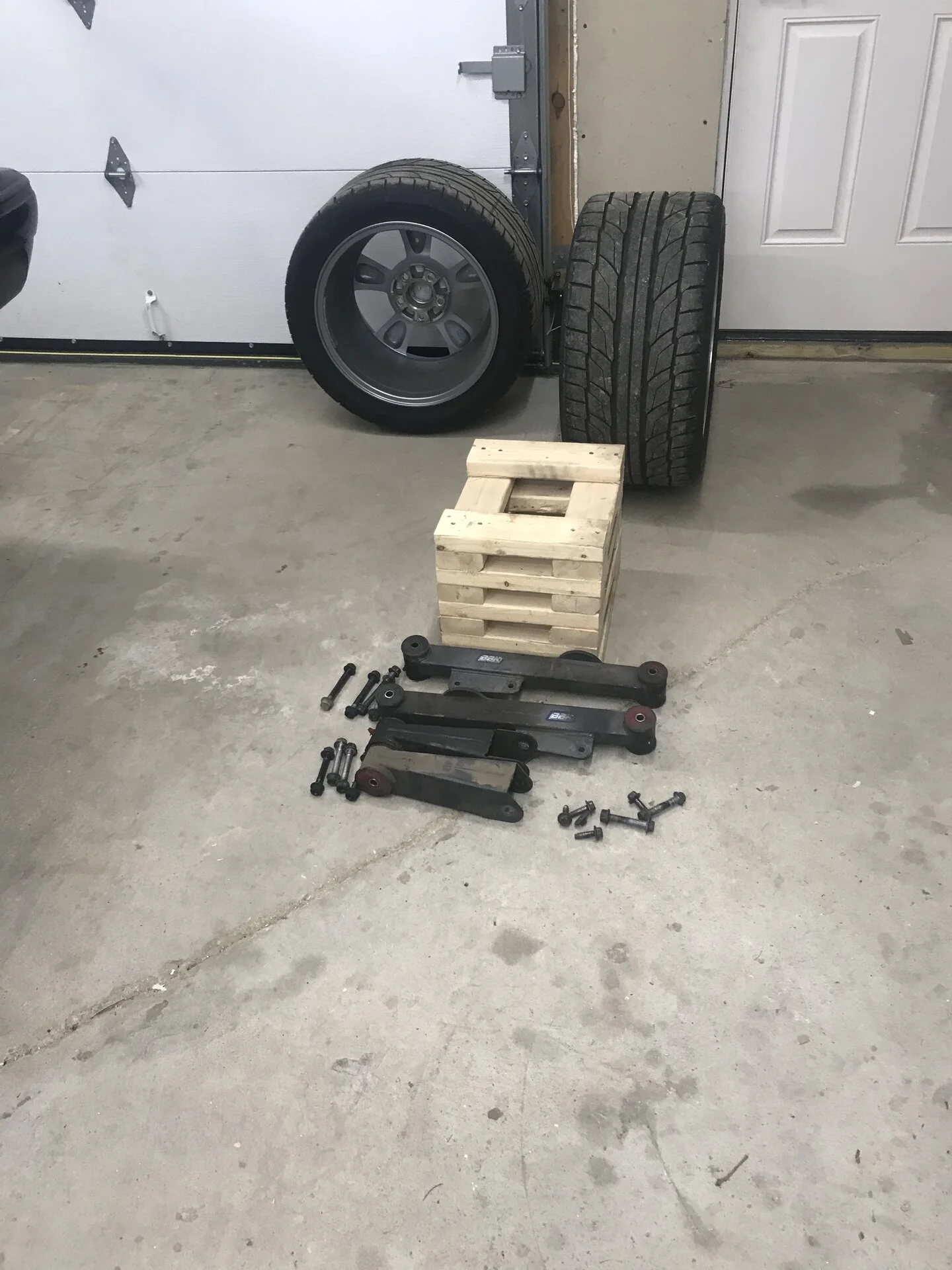

I did manage to remove the rear upper and lower control arms. Not much of a feat but jacking up the car and such takes a while. My axle side rubber bushings are starting to tear. Fortunately I ordered MM upper arms, axle bushings, and spring isolators yesterday

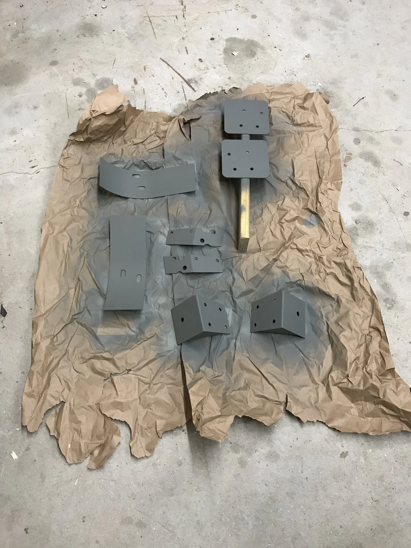

Im doing some work on a friends truck tomorrow but if I have time I’m going to try to get the torque box reinforcements bolted in.

Replacing the upper control arm bushings while utilizing the Maximum Motorsports removal tool was one of the most difficult things I've done to my car to date. The alignment has to be perfect. Wow, that was a pain.

Hopefully it doesn’t fight me. I’m going to attempt using a ball joint press.
I did not get the tb reinforcements bolted in. I figured I should paint them first, so I took care that. I also disassembled my drivers seat. I’m going to sell the seat tracks. I’d like to sell the frames but I don’t think there’s a market for them. They’ll likely get tossed. I cleaned up my old BBK control arms too (kinda). I’ll prob sell them but I’m thinking I may hang on to them until my new set up is installed and works properly. I also made a trip to HF. Welding blanket, fire extinguishers, and a new respirator for painting.. I’ve been needing one for a while. And by that I mean forever lol.
