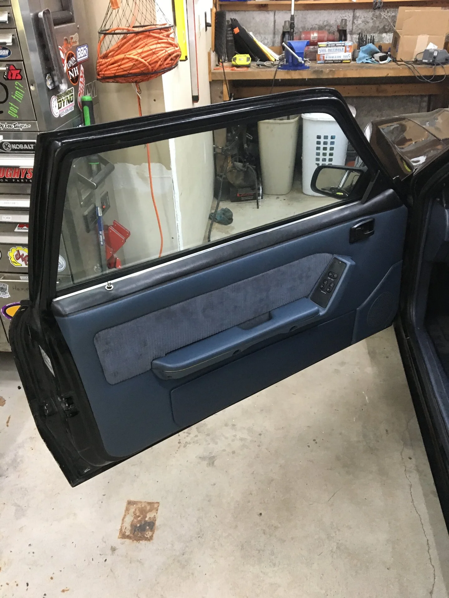

Got the left door panel painted and both completely fastened. Both panels were missing various screws. I only used about a half can of the paint and have an entire other one so I should have enough to freshen up the entire interior. The door locks work AWESOME. And the f-ing gas gauge appears to not work. I’m at a loss. Now it’s pegged full. I’ll need to dig back into it when I get the motivation to look at it for the 3rd time. Oh well, my speedo/odo is working now so it’s not a big deal. Did about 30 miles today and the car ran great.

Ya, these cars don't like sitting around for long. Once modded they need to be driven. Lookin' good.

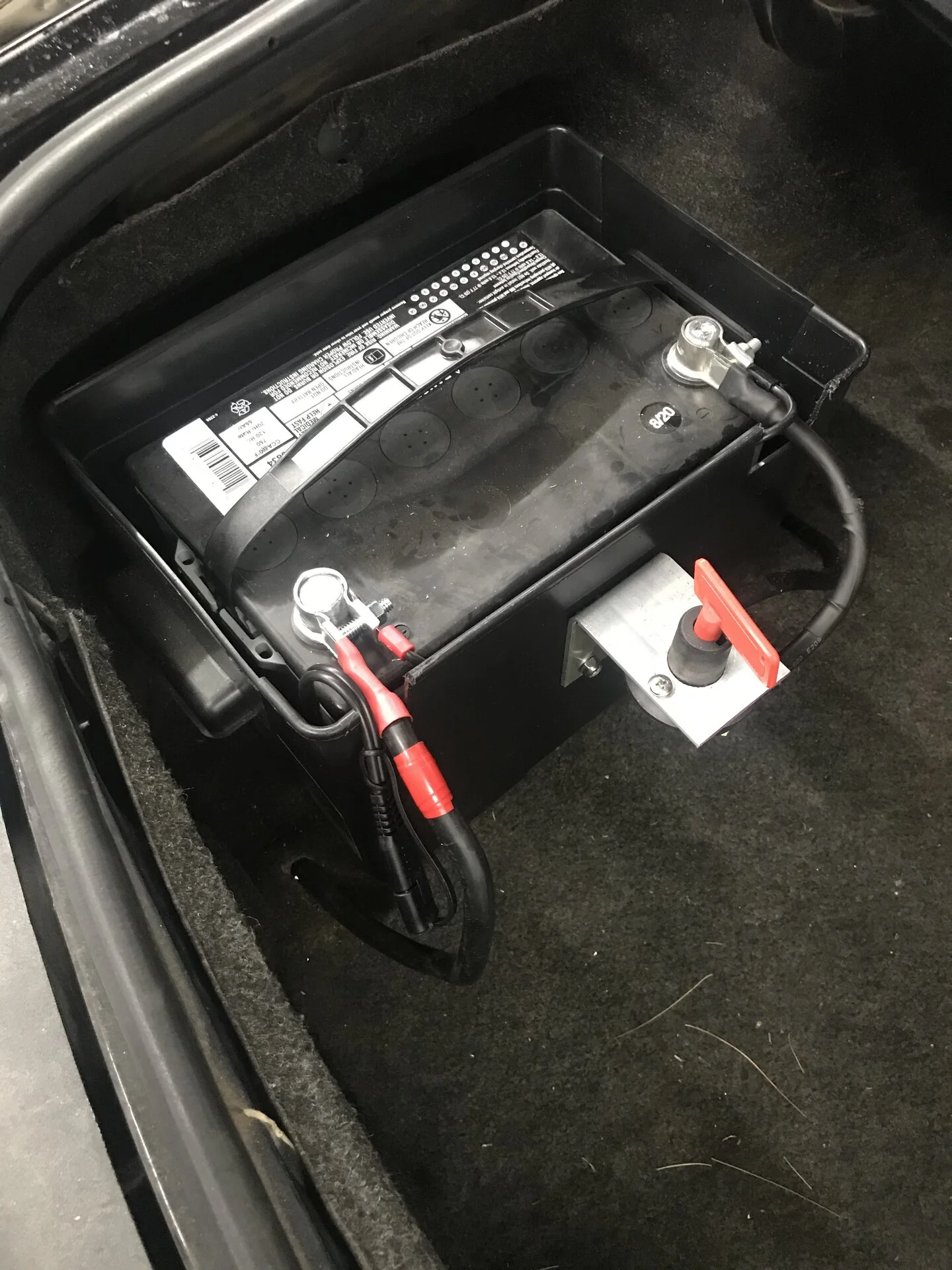

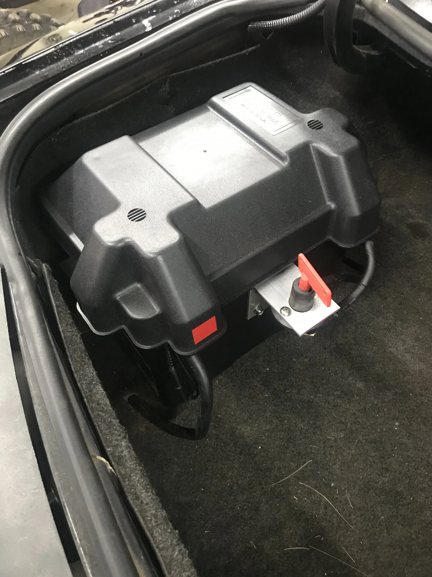

Not really a huge update.. but I had my battery die about two weeks ago. I thought maybe I left something on so I threw it on the charger. A couple days ago I was going to go for a drive. Took the charger off and went to start it.. nothing at all. Completely dead. I then jumped it with my truck. It started right up so I went for my 20 mile drive. When I got home I immediately shut it down and it didn't have enough juice to start again. Battery had 10v. So I jumped it again to get it into the garage and measured the voltage when it was running. 14.2v. I got it back into the garage and through it back on the charger. At that point I didn't really trust the battery.. it was 2.5 years old anyway, so I began looking into other batteries. I found a group 24 would work well for me and settled on either a Die Hard or optima. I wanted a AGM if i was going to upgrade. I decided to bring the battery to NAPA to get it tested, I've made friends with the counter guy there and I explained to him what happened. He tested the battery to be good, but decided to warranty it anyway. I upgraded to NAPA's Legend AGM for an additional 28$!! SCORE. While I was at it I installed a new battery cable end on the positive side and a battery tender. I figure I probably reduced the life of the old battery by not keeping it charged over winter, even though it stays in my heated garage.
