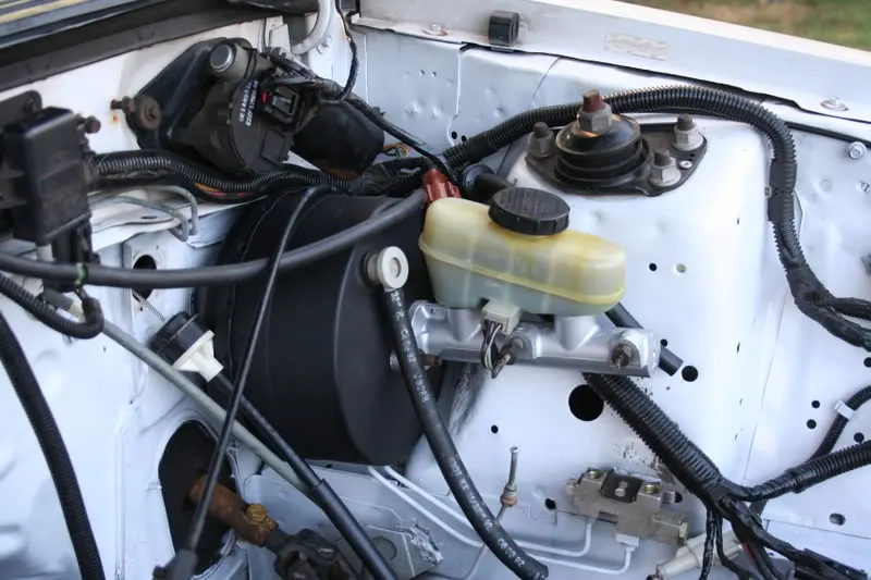

5. Pulled the Booster and Master cylinder and installed the SN95 booster and MC

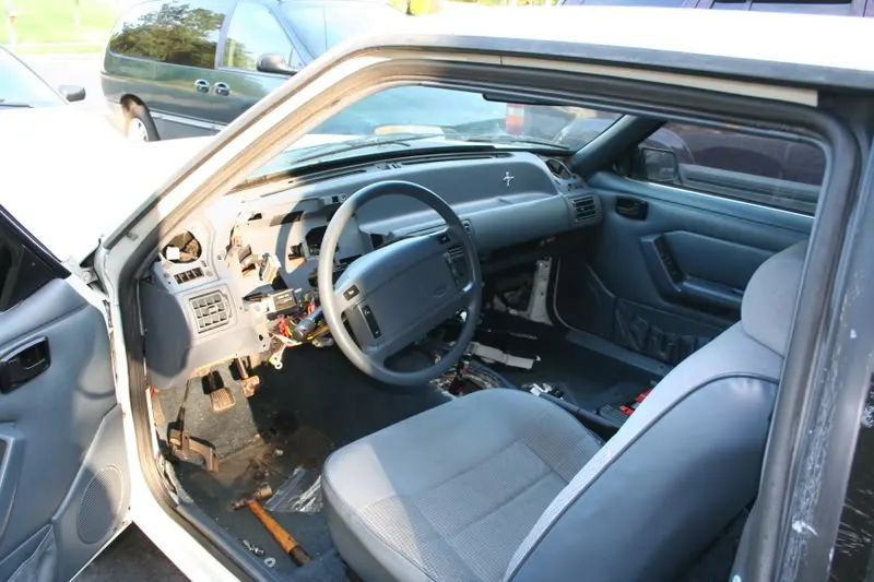

6. reinstalled the dash, putting about 70 percent of the bolts/screwes back in it
before calling it quits for the weekend around 6 yesterday

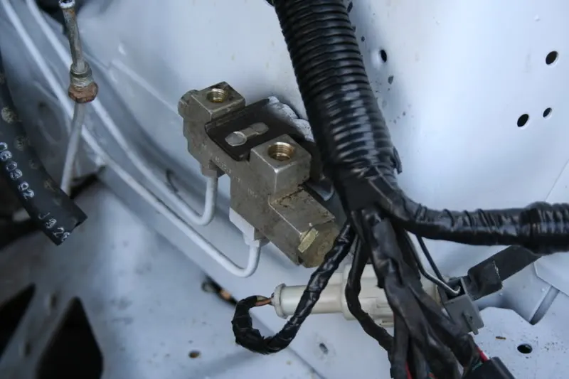

The purpose of "gutting" the porportioning valve is if you want to run rear disc's.. I am, so to gut it you remove that front cap on the combination block/PV and take out that spring, and the seat thingy that sits in the middle of the spring. Then you replace that front cap with a solid one, which gets rid of that rubber. Then you install an adjustable PV on the passenger side firewall (there is a connection where you can just slip right in, i'll show pics of this later). This will be the new means of controlling the rear bais to the rear disc's :)

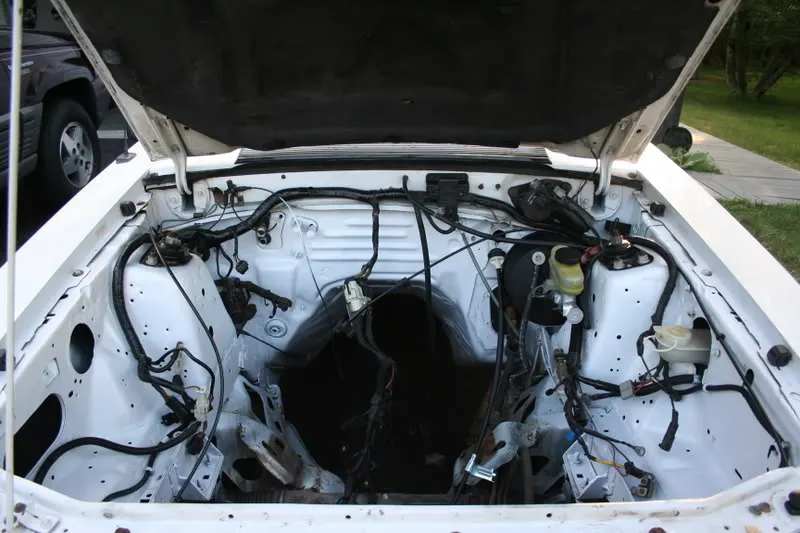

Bay with new wiring
massive SN95 booster and MC
SVT32V here is the PV gutted with the "plug" on the end:
and here is where the adjustable PV will go so i can control the pressure to the rear brakes:
