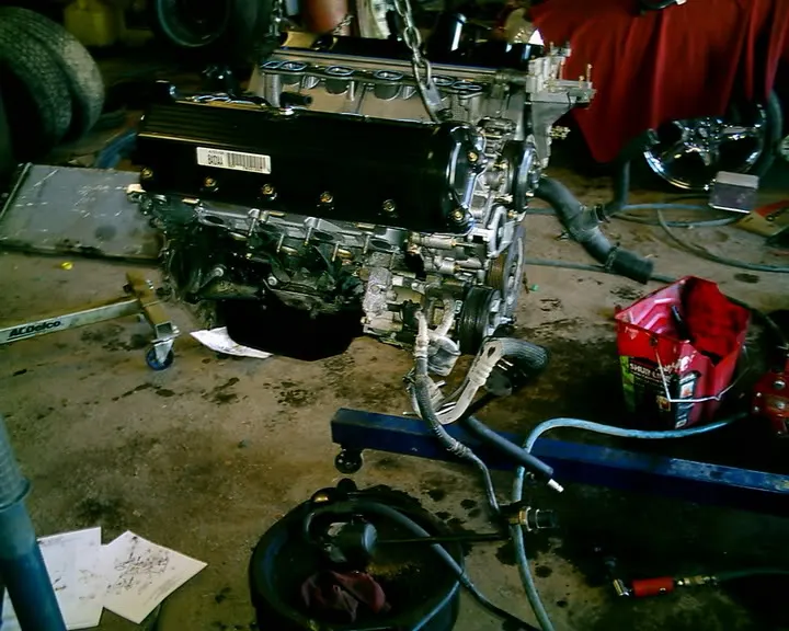

The PI swap is done-Lots of Pics inside DUW
Orions98GT
Nov 20, 2004
Overland Park, KS

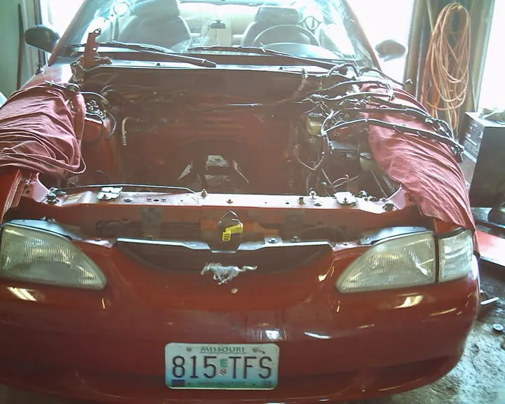

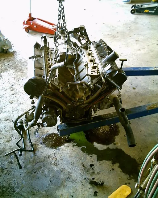

teh empty

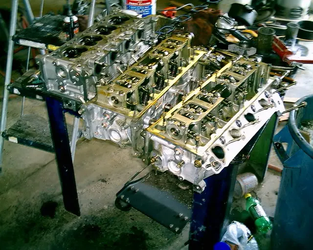

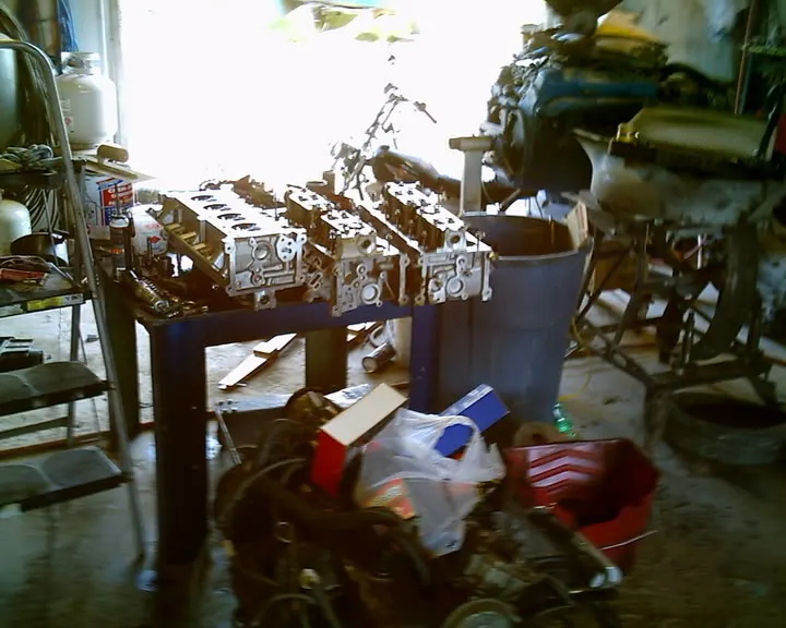

Heads sitting next to each other

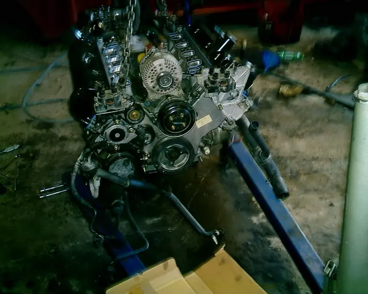

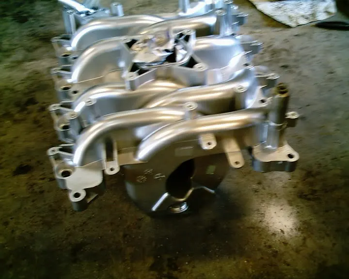

The painted Intake manifold.

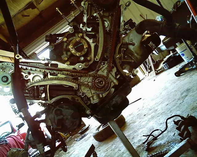

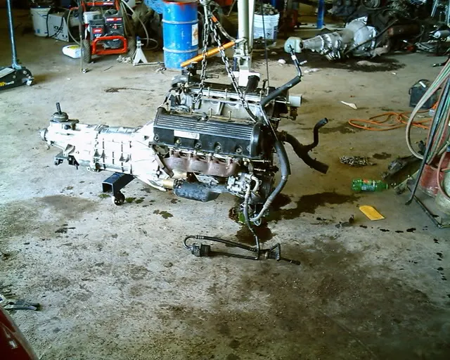

The dead clutch.

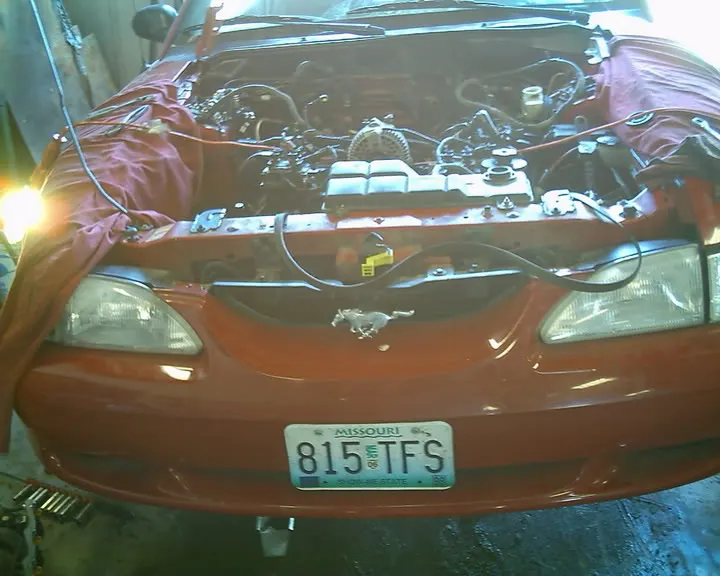

    The car is kicking arse down the road, it is going to D's Dyno in Overland Park Kansas for the SCT tune next week :D

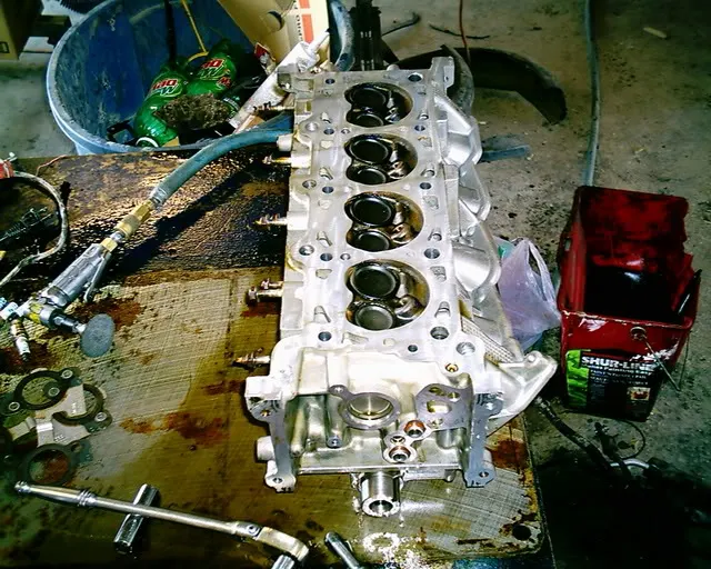

i like the intake painted. did you use that fusion paint? and was it easier pulling the motor to install the heads? i'm still deciding what way i'm going to do my swap. but i have time, still waiting for some vt cams.
45 an hour :D they are great guys and garuntee all their work, anything messes up they fix it for free.
EDIT: with the new clutcht hat I purchased through them and labor for the headswap and the clutch they charged me 1200 total, they had to get the gasket kit and a few other parts. Also I got a 10% discount off everything for being a college student.

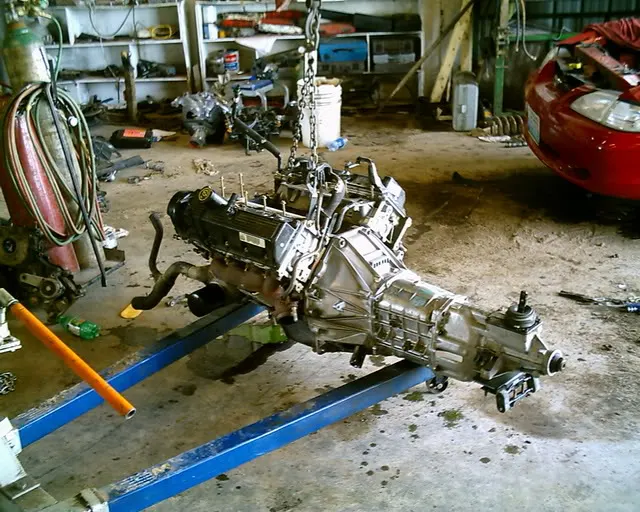

Nice, just finished mine last week, you will be very pleased with the results. I painted my intake silver as well, looks so much better than black. Man, I wish I would have just pulled the engine when I did mine, it would have been 10x easier.
Orions98GT said:
my mechaincs said it wasn't possible to get the last bolts off of the valve covers on the back, I was with them for 2 hours trying for those bolts, then we said fck it and pulled the engine.
Its possible, slow and steady wins the race :nice: ...well sometimes. Getting a few of the head bolts on was a pain, had to tape the head bolts up in place because there was not enough clearance between the head and the inside of the fender. The valve cover bolts were not easy either, had to use a stubby open end 8 mm wrench to get at the ones on the side near the back.
