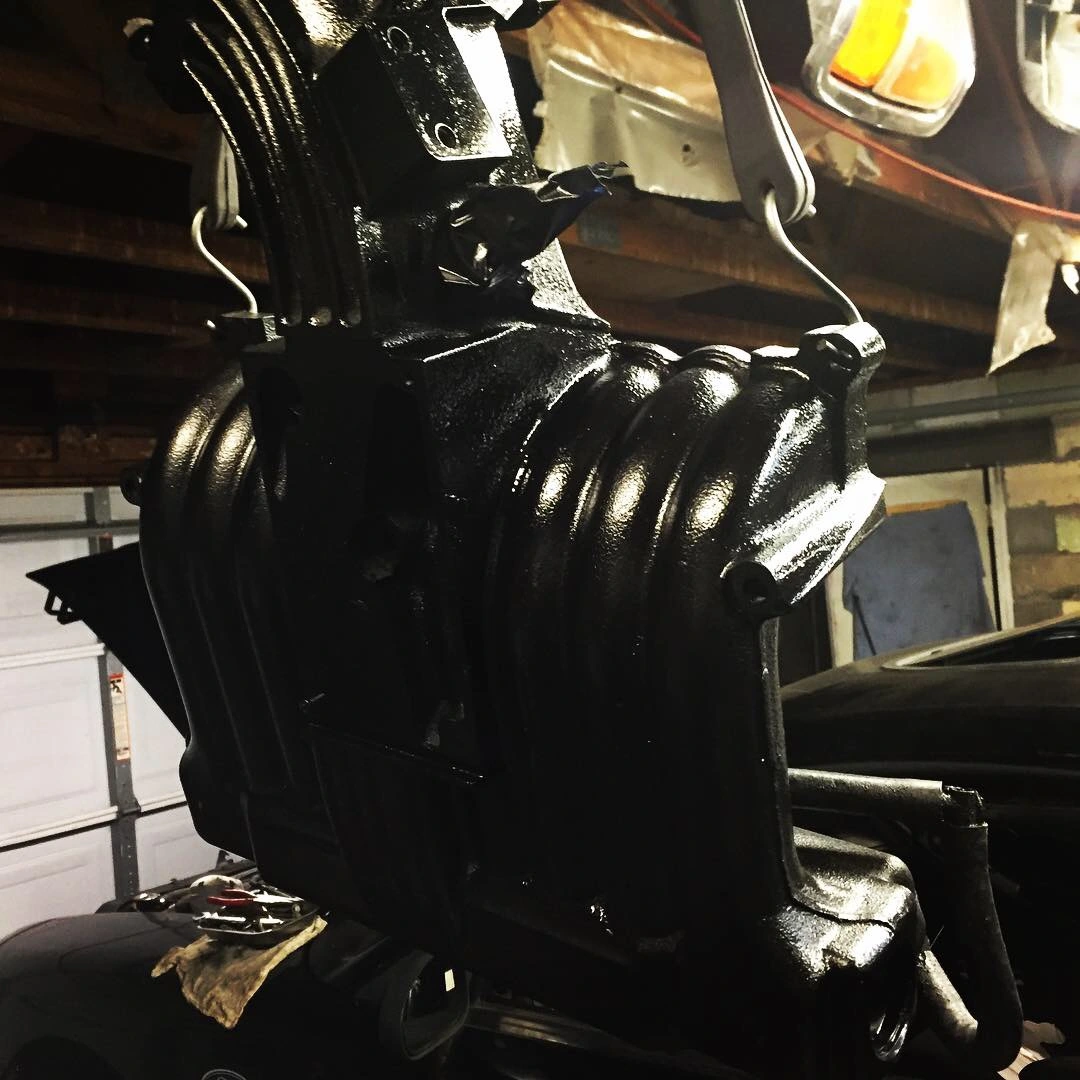

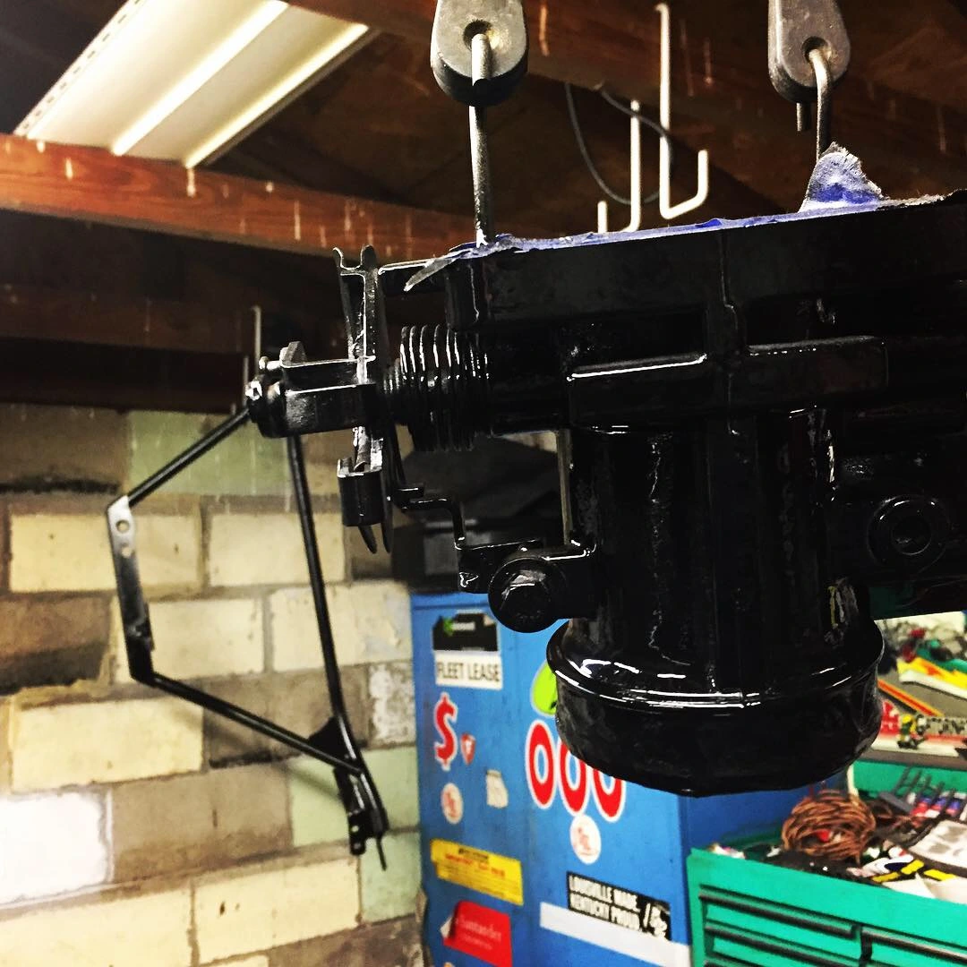

Have a few more parts on order,some more cleaning-painting-etc to do before I put the transmission in-couple things I’ve cleaned/painted

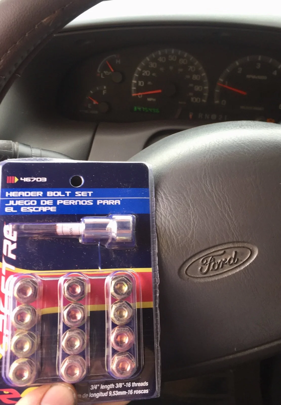

Last update I mentioned being at a stand still over 4 nuts.
I got the nuts I needed,and now I’m at a stand still again.

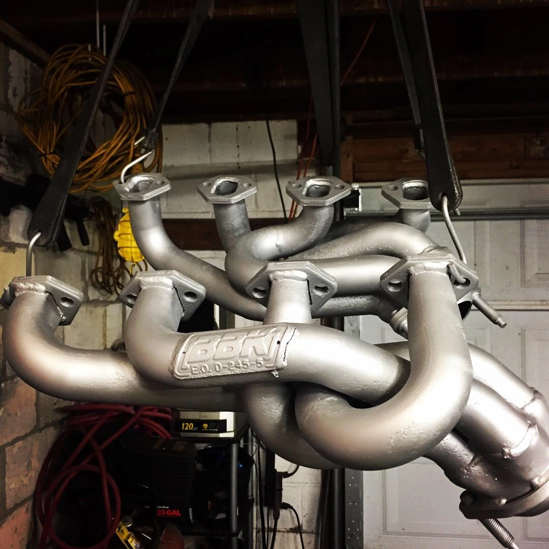

I have had 4 different brands/lengths/styles sets of headers on this car-every set I used the same stock header bolts.
Throw the BBk’s on today,most of my bolts won’t fit...... So again,held up by a simple fastener... Will update with the next stupid issue I run into

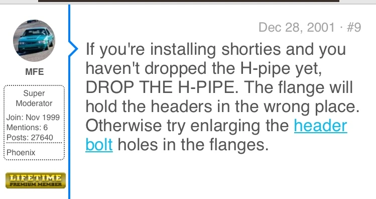

If recall those headers fit super tight. I loosened the nut on the motor mounts and jacked the motor up to get the bolts to wiggle and snug up.

Not sure if this is your problem, but if the headers you have are the kind without a common-rail for the exhaust flanges (best term I could come up with), then get a buddy with a pretty solid broom stick, wedge it behind the front flange and use the K-member as a fulcrum to stretch the front primary enough to get the bolt started. It's a little trick I learned back in the day with some MAC shorties. I'll never buy another set of headers without a common-rail flange set up, where they're all attached to one another so that no stretching is necessary.
That actually makes perfect sense.i did not try that due to the fits of rage I was about to have lol. I’ll give that a shot tomorrow-Before the fire and what not
I have a set of MAC on mine and I made the mistake of taking the passenger side off (don’t even remember why). Anyway, I had to drill out the holes and use a pry bar to get em back on! I will definitely go with “common flange” if I ever buy another set!
Oh yeah, and if I remember right, the header gaskets I had (assuming you're using gaskets) had sort of hangars instead of just holes on the outer bolts so you could get the outer bolts started and slide the gasket on afterwards. Just another neural firing. It might be a PITA to try and line the gasket up at the same time.
