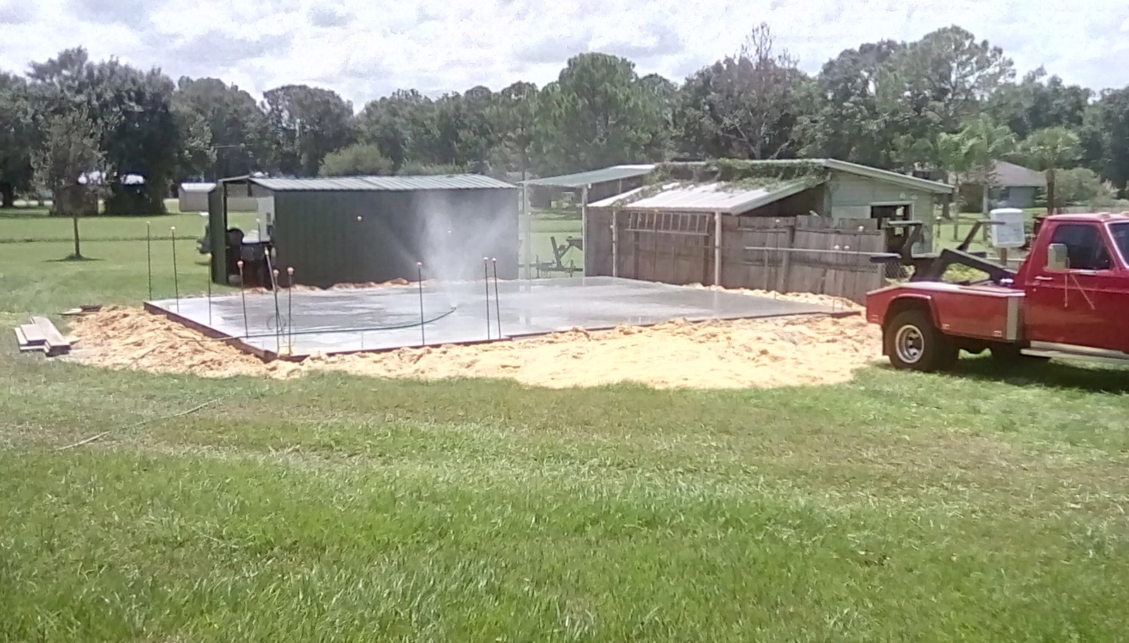

And we have a concrete monolithic pad
you think by watering it like this it will grow bigger?
Reactions: RaggedGT
if you says so.....
BTW they did that at the wrong location..... thats not my back yard.... WTF JR!!!
Helps with cracking, surface structure, and slows the final cure which raises the PSI rating of the concrete. If I can, I almost always wet cure my concrete for 2-4 weeks after pouring. You can raise the strength of concrete 1000-2000 psi past it's rating by wet curing.
You know, just FYI.
You southern folk are lucky that you get away with shallow footers down there. Here in MD, it's 30" deep minimum. Further north, even deeper.
