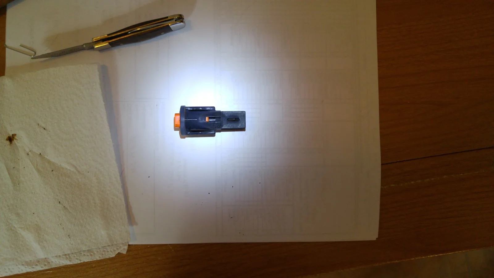

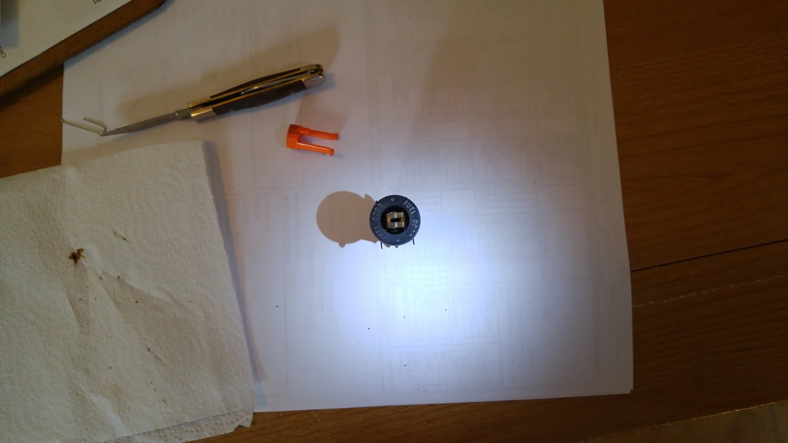

got home and decided to see what was wrong with the fuel door opener. narrowed it down to the switch in the glove box, jumped online and found one listed on LMR, $35 but it was not available, found another that looked similar but the product description said it may not fit my car, that one was $40! not happening, (like mike says about the finger ) looking at this push button thing and thinking where is the gold hidden that makes it worth 35-40 bucks I see a way to take it apart, can't hurt, it don't work now' what's gonna happen? So what if I break it. push a couple tabs and it comes apart to show just how simple it is, push the button, it makes a u shaped piece of metal contact the blades where the connector plugs onto, one side was all cruddy with whatever toxic stuff floating around behind the dash/glove box area is, scrape the toxic crap out of the inside and clean the u shaped metal with a pencil eraser, stick it back together and it actually works. take that one off the list. What now? well it's back to the garage building stuff that seems to be moving kind of slow but is actually on schedule, the tunnel is filled in and well hidden from the throngs of immigrants that mike is worried about secretly invading my garage space, the gators have been returned to the swamp and there is yellow covered wires neatly stapled to trusses and conduit on the walls where the plugs will live. a box by the door with breakers in it, a couple boxes mounted outside for lights. I think we can put the ceiling up.
here are some picks of the switch just to prove how simple it really is.
