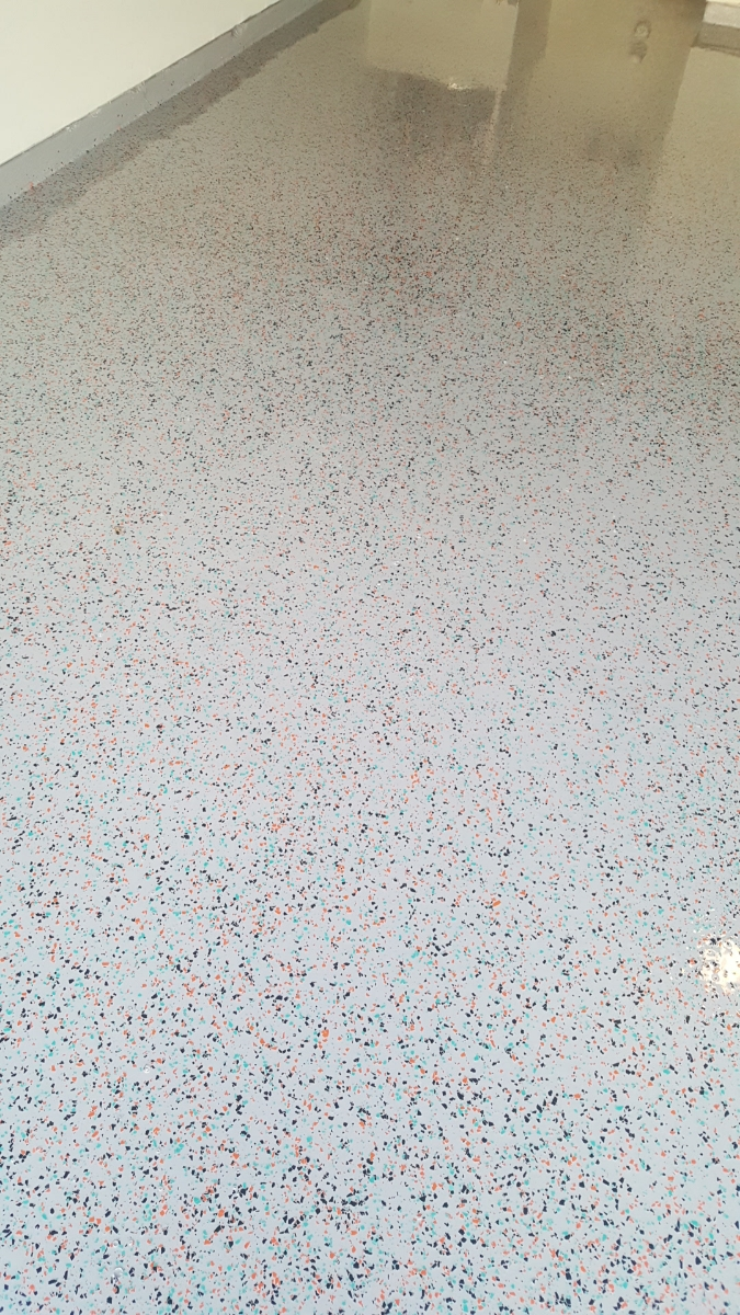

Did you epoxy the floor? Or is it painted
Epoxy, only the best!

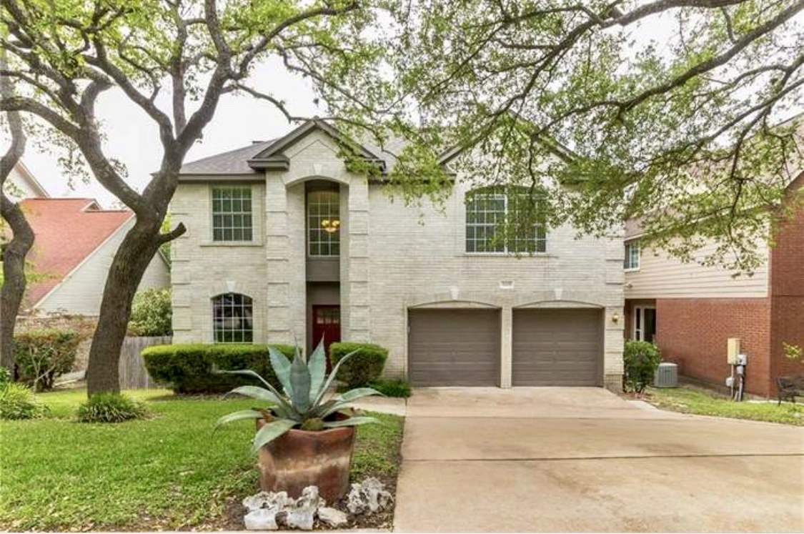

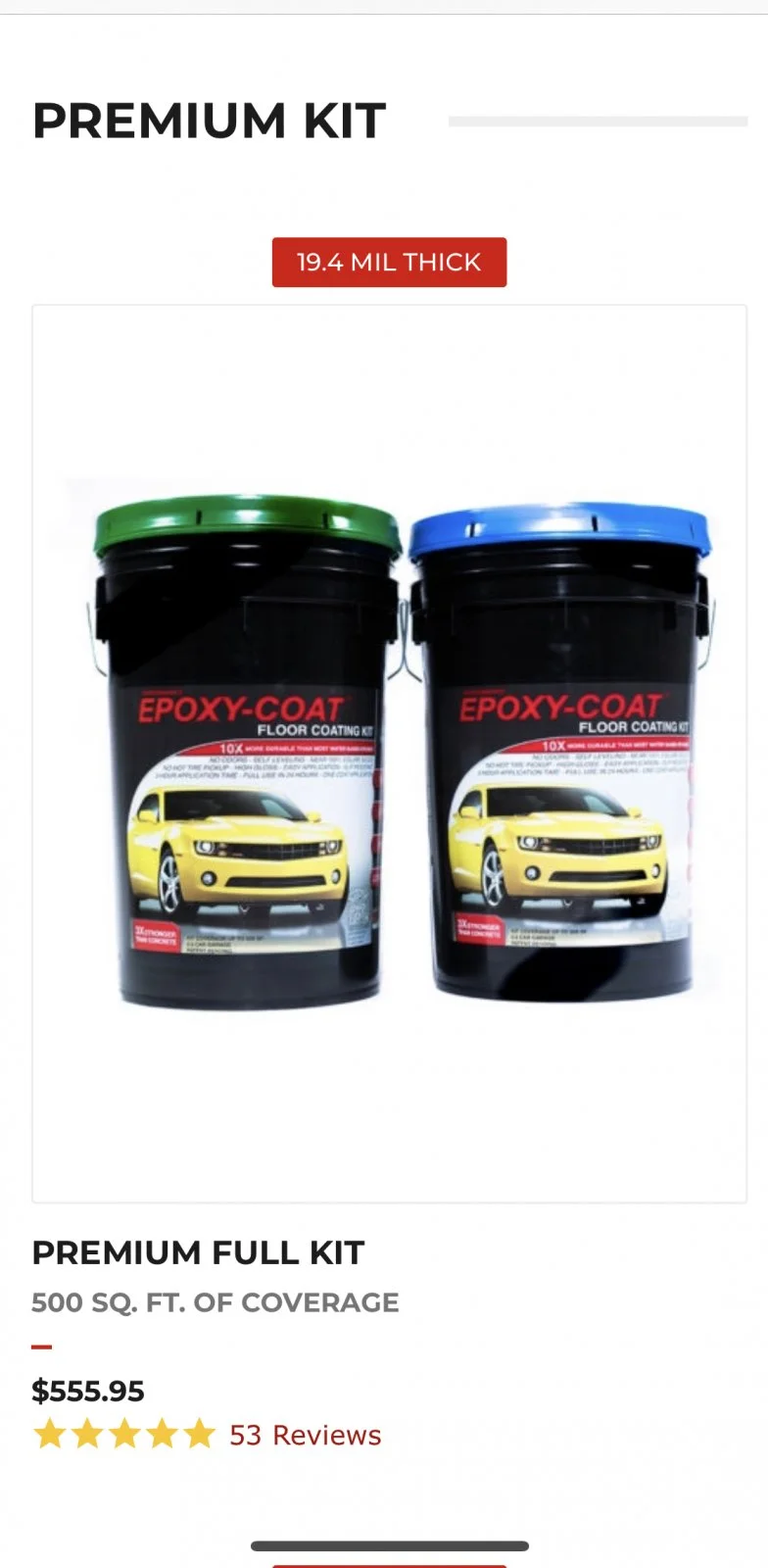

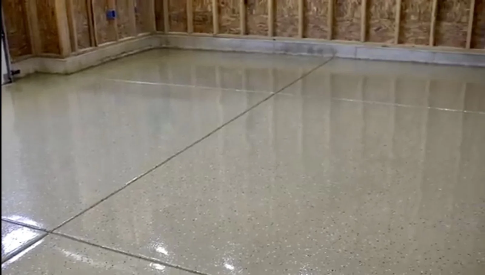

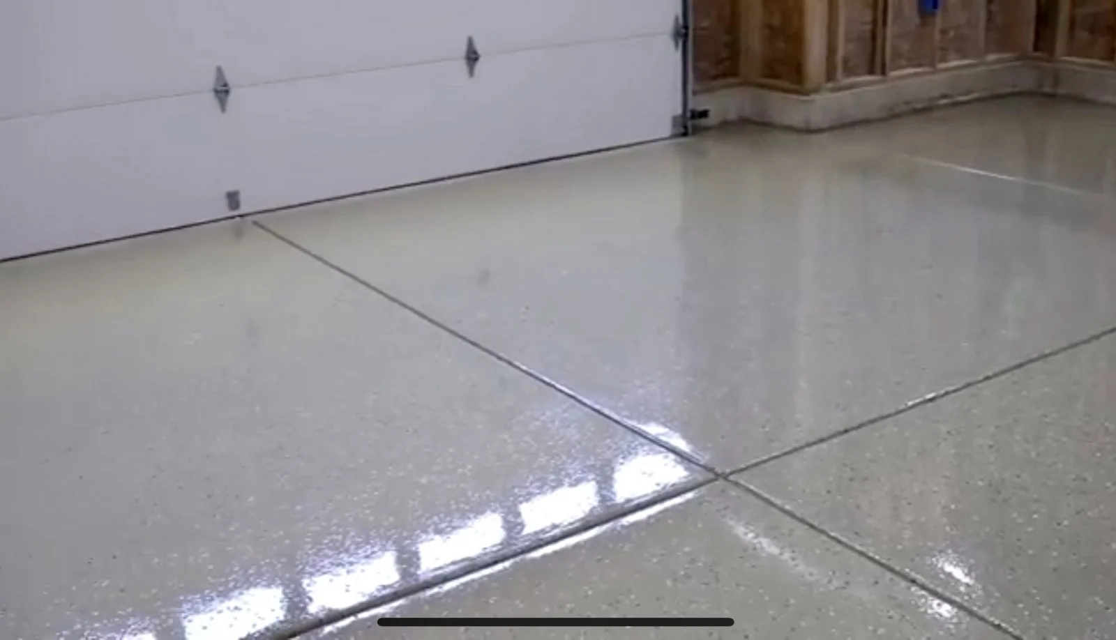

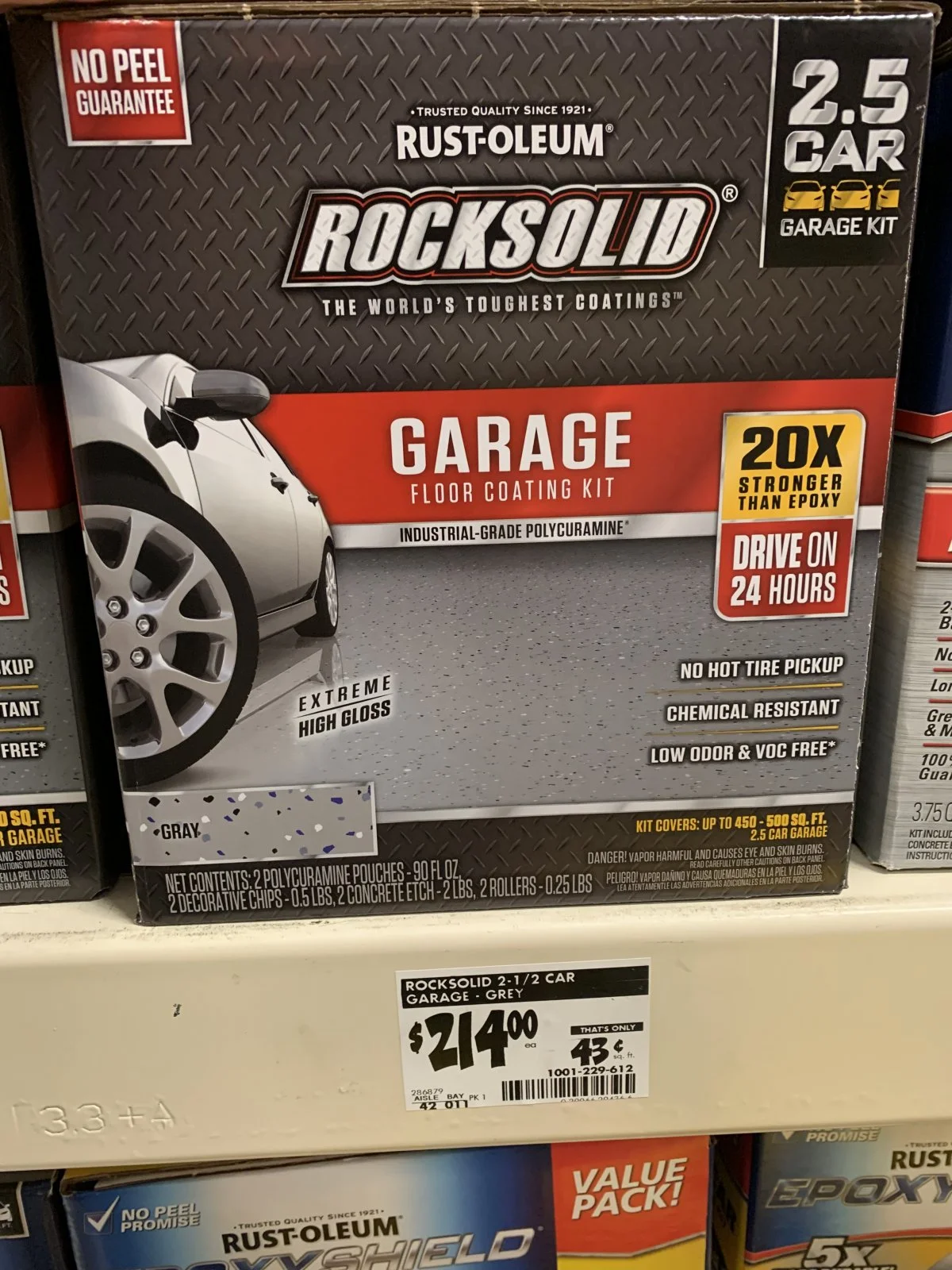

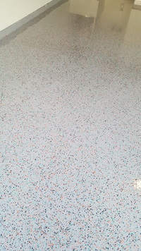

What did you use to do so? We just bought a house and closed last week so now I’m eager before we move in to repaint the entire garage which I have never actually painted before but can’t be that hard and epoxy the floor. Was looking at the rustoleum rocksolid kit, cover 2.5 car garage which claims to 20x stronger than epoxy. Reviews are back and forth good and bad. Also looking at this epoxy-coat, surely more expensive but reviews seem to all be good. Not trying to go all out price wise. Rock solid kit is 214 plus I believe I might need to buy a clear coat. Or the epoxy-coat kit which comes out to be 600 delivered. Seen picture of both, a friend of mine did the epoxy coat and honestly they both look good.

Used rustoleum epoxy shield from lowes, I think the pic of the box is on page 9 maybe about post #147? Go to thisoldhouse.com (I think that is where it's at) for better instructions on prep/application, the condition of the floor is very important, new concrete is best but you should wait at least 60 days after pour, if it has a trowel finish you need to etch it or it will not stick. I did not use the non slip additive, it will make it hard to clean but it will be slick when wet. And if you get gas or diesel on it don't wipe it up, let it dry naturally then use dish soap and water to clean it.
Block or wood frame?

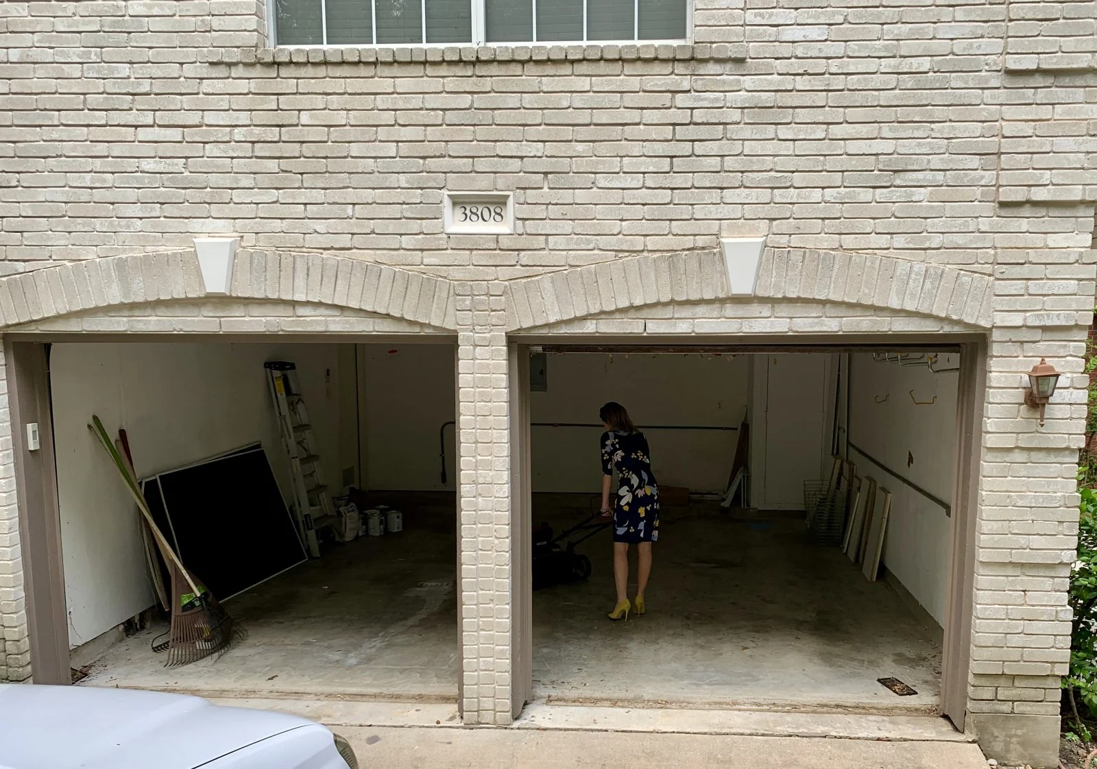

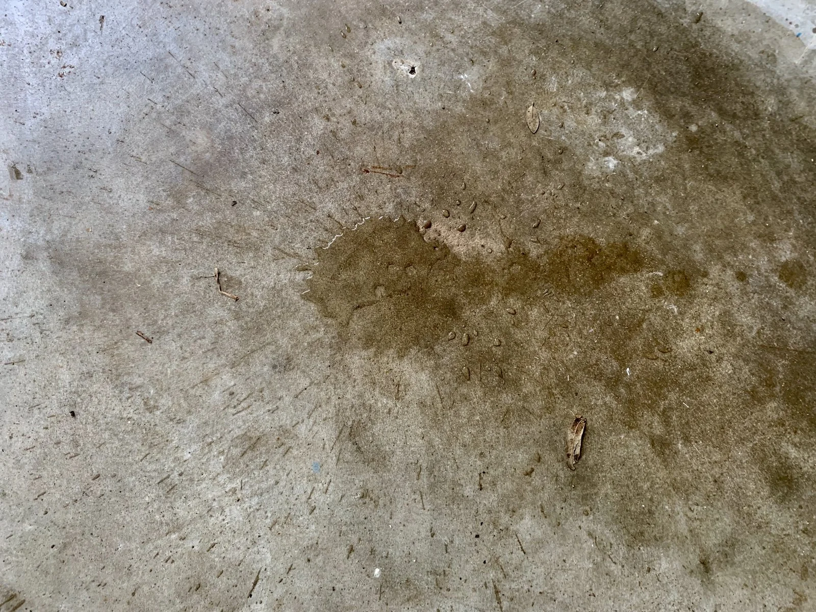

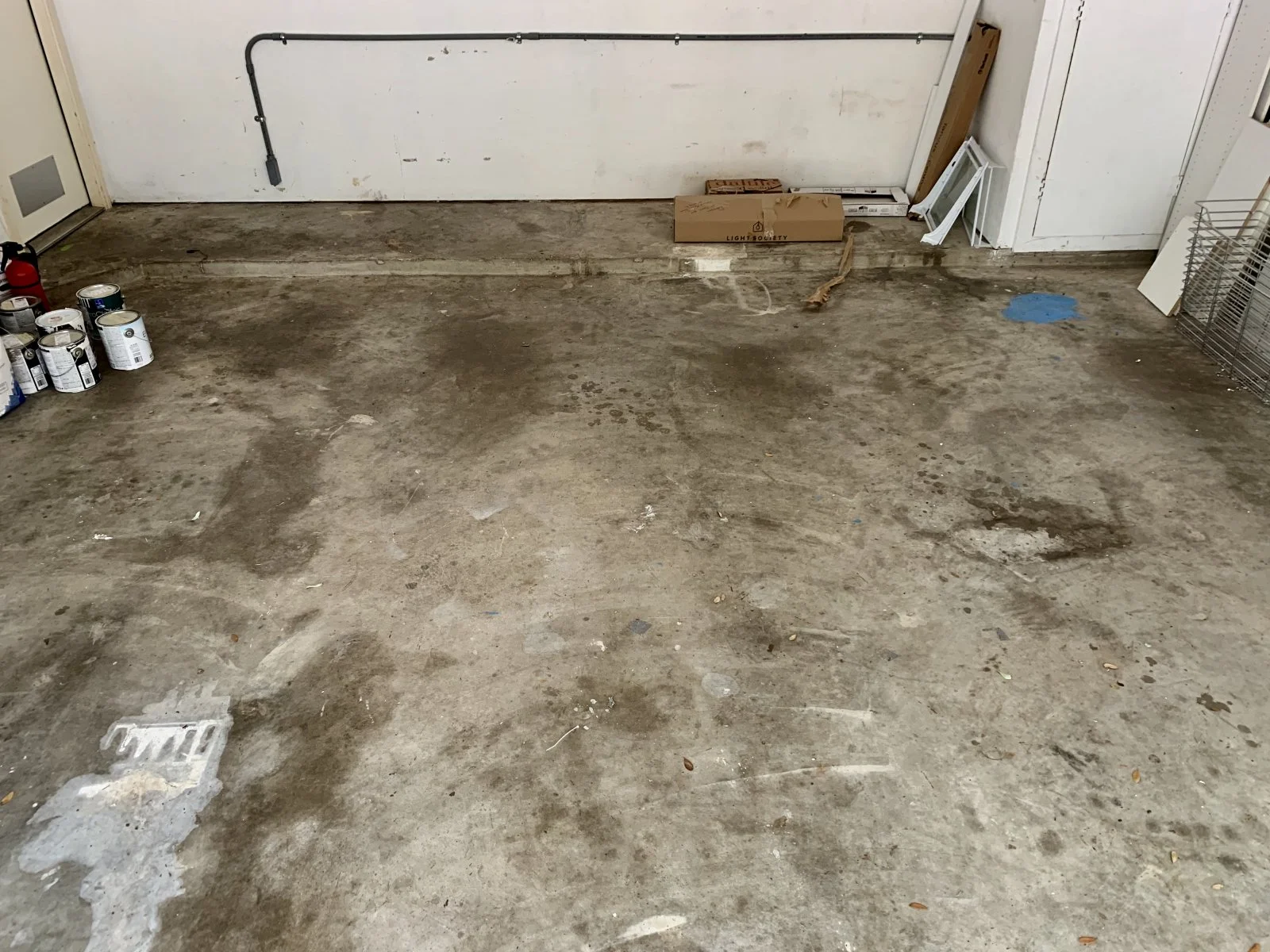

I will have to take pics bc I’m not sure on any of this. It’s our first home, so idk if it’s blocked or wood framed or what that means. The house was built in 1995, I’m not sure if the concrete was treated but I don’t think it was. I’ll send over some pics once I get back over to the house.

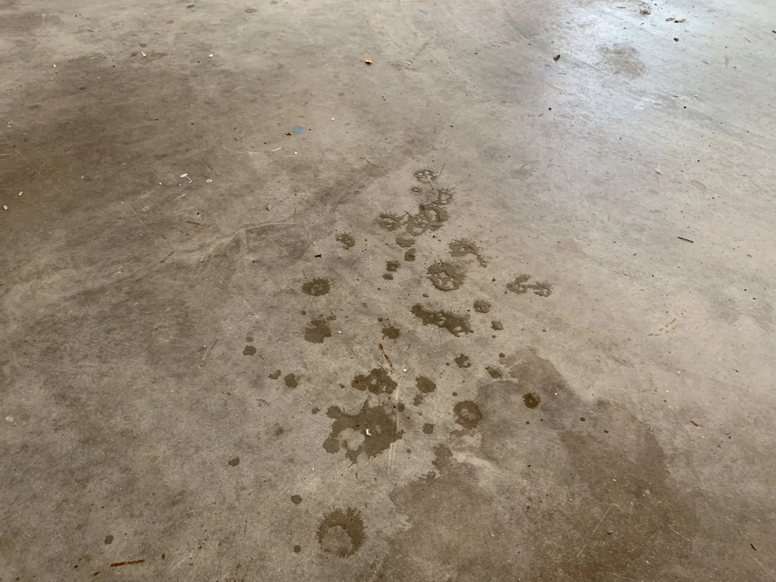

The question of wood or block was just curiosity, living in fl and having been through many hurricanes I prefer block homes/garages. Now about that floor, if the garage floor was poured in 95 the most important thing is to get it as clean as possible, any oil stains need to be dealt with or nothing you put on it will stick. My advice would be to take an 'oil dry' product (not kitty litter) and grind it into the stain then wash with a degreaser and then detergent. I would etch it too but that's just me, make sure the surface is dust free and dry. If you can swipe your fingers across it and they are clean then you can apply the coating of your choice.
Ok so the garage needs a good cleaning currently which I plan on doing and repainting all the walls. I think my concrete is treated, I dropped some water and looks to be bubbling or repelling vs soaking in. Can you tell? It has a sheen to it but not everywhere. If so I guess that means I’d have to diamond cut correct? Don’t know why this woman thought I had a garage sale though!
