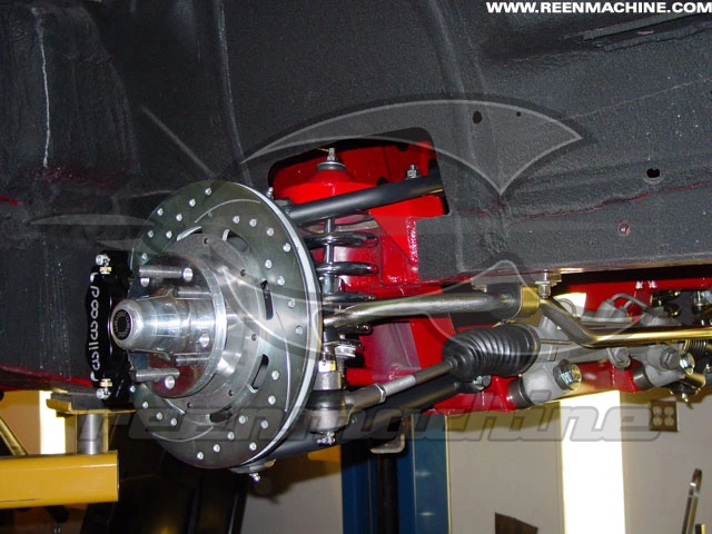

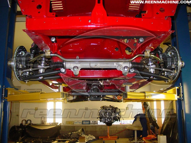

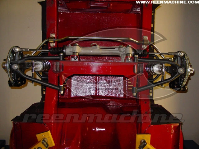

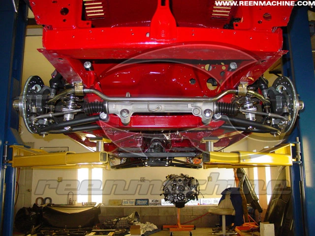

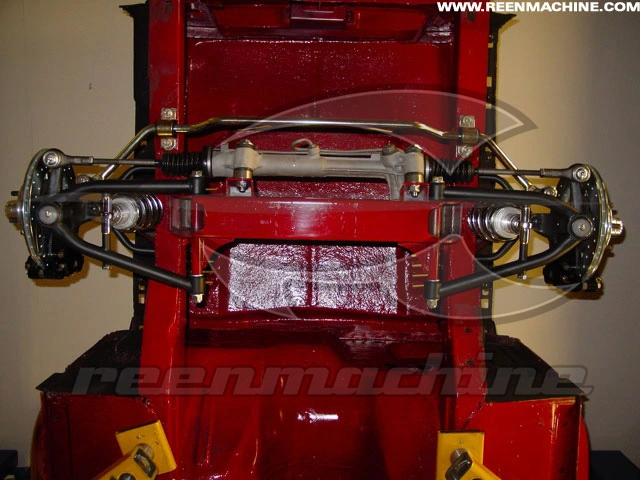

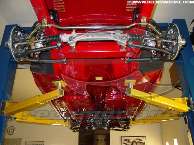

I finally got the front suspension and brakes in, and I'm getting the pics up on the website and also on here this morning.
The Painless 67-68 chassis harness came in yesterday as well, so I'll be into that over the next couple of days.
OK -- I couldn't get onto the forum for a while, so here are more pics finally.
The front suspension and brakes are on and they look killer.
Those are 12" rotors with 4-piston calipers and I thought they were pretty sweet. Well, a customer dropped off his '67 fastback yesterday for the same front end conversion and he wanted the 13" Wilwoods with 6-piston calipers. They're absolutely sick. They make the brakes in the pics above look like toys!
