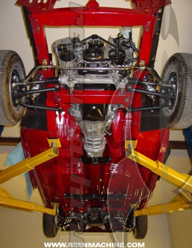

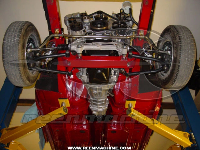

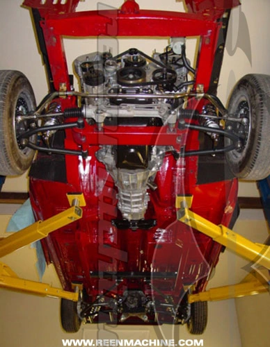

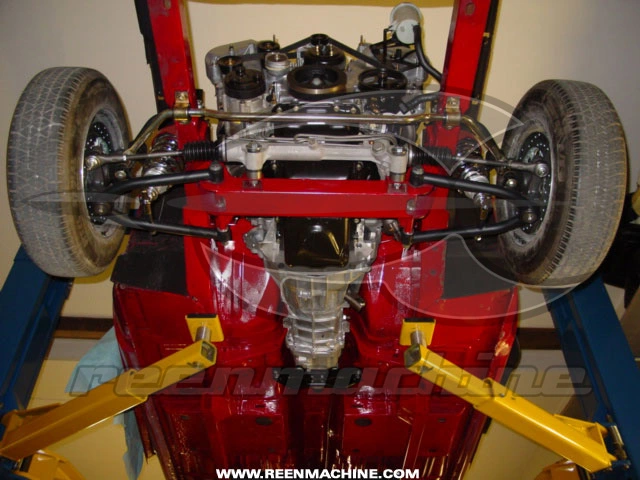

Check it out boys -- got the engine and tranny in (hopefully for good) today! All that remains to finish the drivetrain is to add an aluminum driveshaft. I was planning on calling Inland Empire Driveline. Anyone have any other suggestions?
