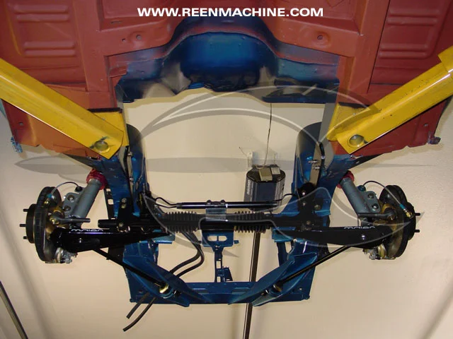

Yes, but not on this car! I got the green fastback back on its wheels and added a nice SSBC Force 10 front brake kit that's compatible with the MII suspension. Now I have the blue fastback back from paint and it's its turn to get back on wheels. Once it is a roller, I'll rotate back to the 'vert and finish it up.

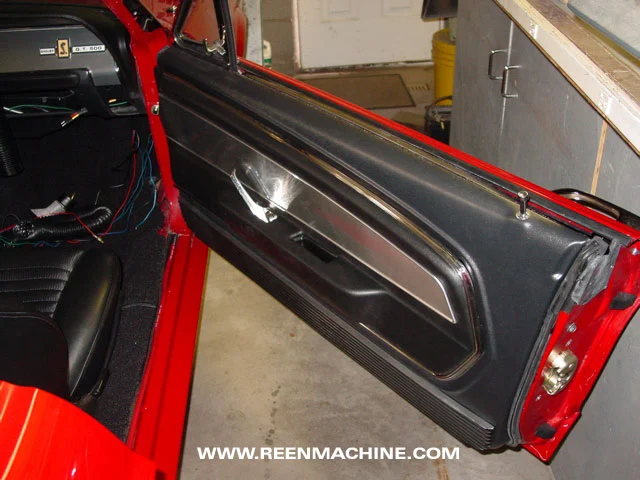

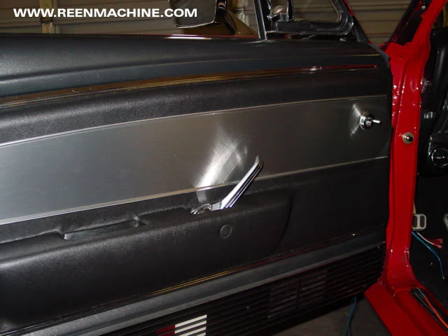

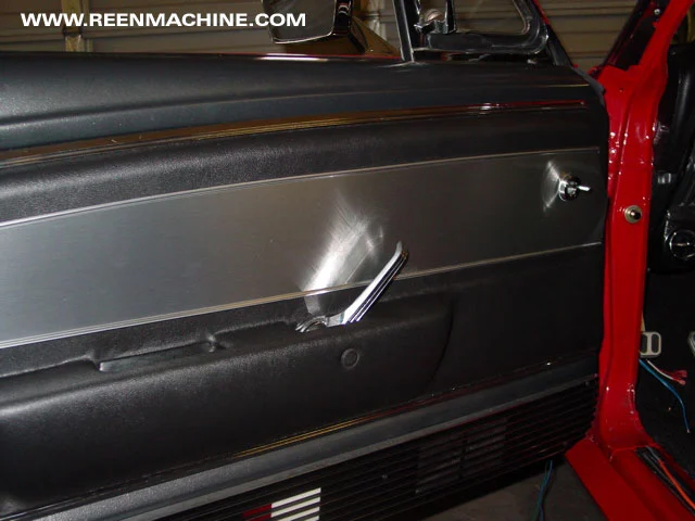

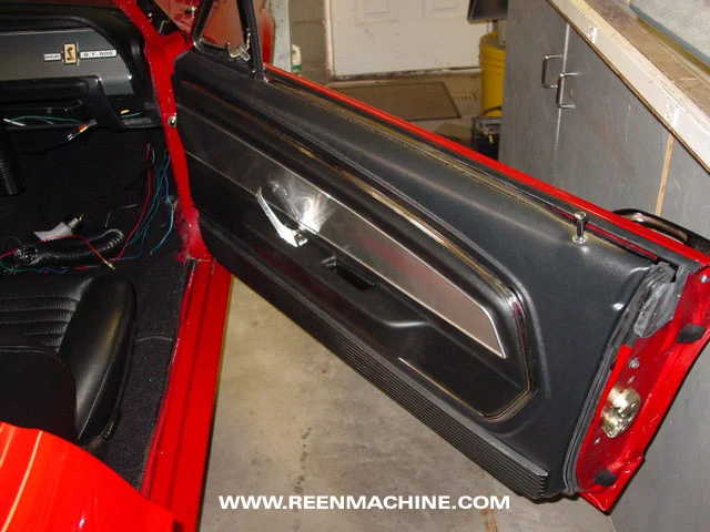

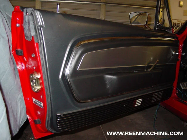

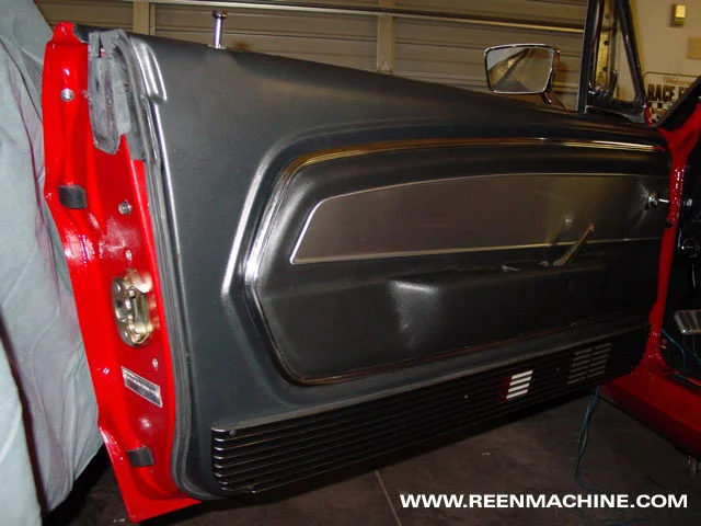

Got the insides of the doors done (power windows, power door locks) and got the door panels back from the upholstery shop, so they went on. They are covered in soft black vinyl to match the rest of the interior, the original edge trim has been polished, and the brushed aluminum trim is an exact factory match. Note the absence of the window crank hole and depression -- power window switches are mounted on the center console.
