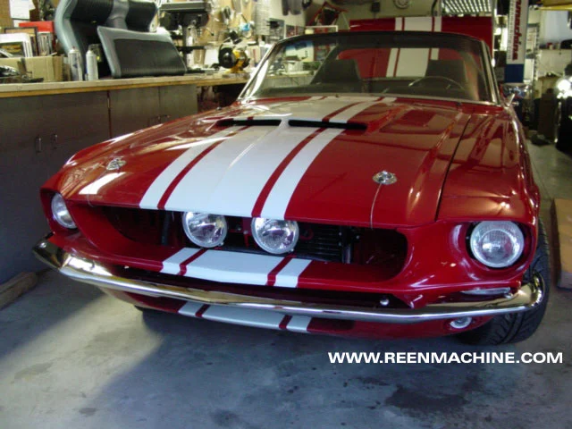

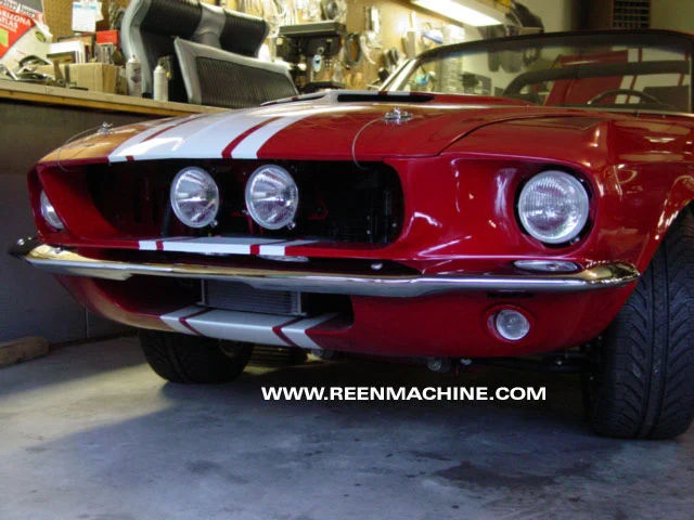

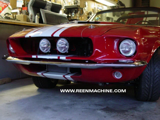

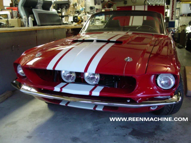

The front bumper and turn signals (amber LEDs) are on, and tomorrow morning we head for the exhaust shop! The bumper actually took all afternoon to get just right...love those repro Shelby bumper brackets!

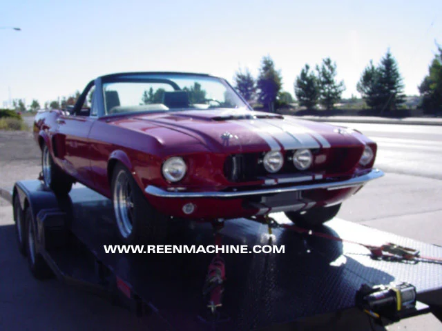

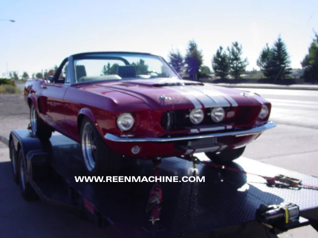

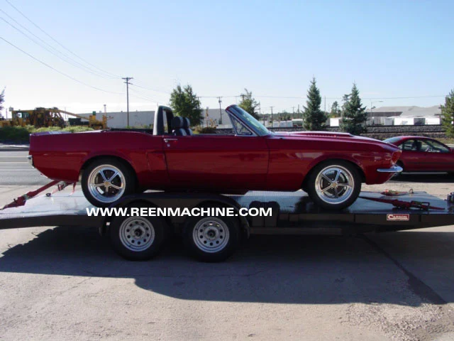

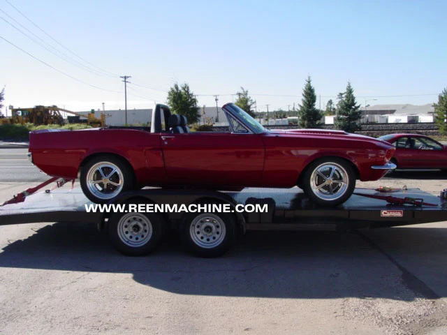

Out in the daylight for the first time in quite a while...arriving at the exhaust shop. Supposed to be done this afternoon!

I never was a fan of the Mach wheels on the classics, or the original Mag-500s for that matter, but this car is making me change my mind.
Very nice!
Any chance of getting an MP3 or MP4 of the thing running?
reenmachine
20+ Year Stangneter
Jun 27, 2004
1,258
38
Montrose, CA
Sep 25, 2006
#519
  • Sep 25, 2006
  • #519
Very nice!
Well, these are neither! They're basically a 17" version of the '67 Shelby Kelsey-Hayes MagStar wheel.
If it runs, I'll definitely post video and/or audio!
