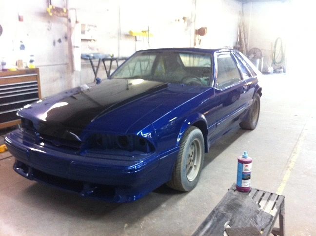

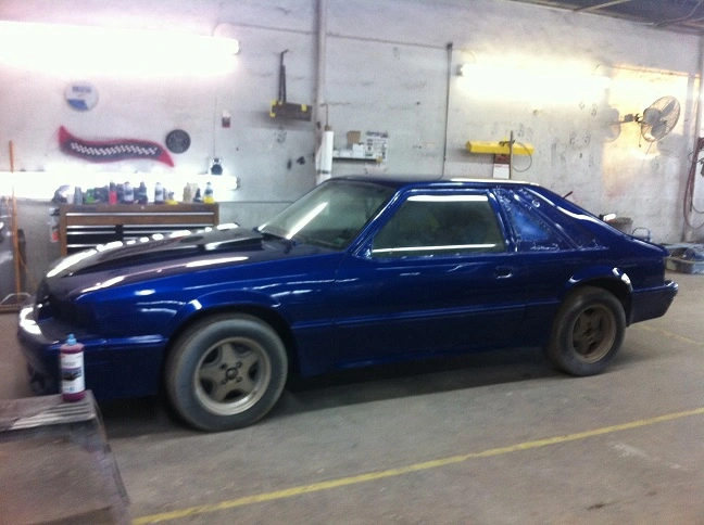

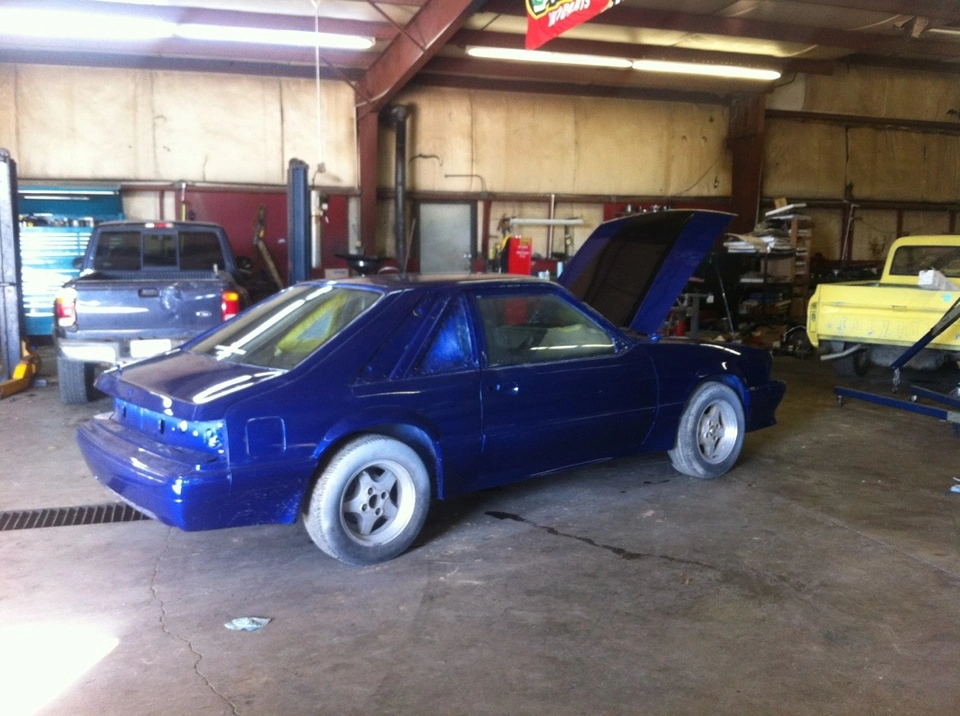

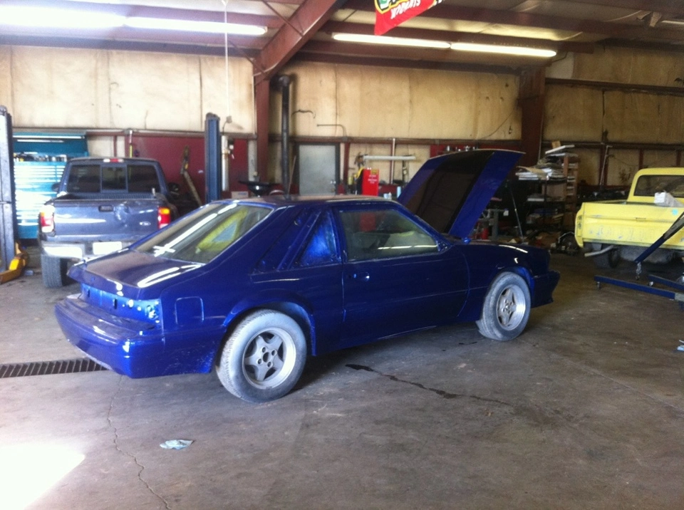

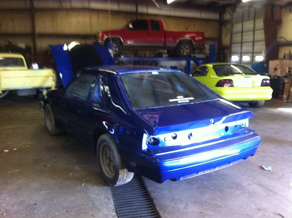

Then and Now. '88 LX
You guys really should feel awesome. I've only showed a couple of my friends pictures of it. I'm keeping it a secret from just about everyone, and I don't know why really. But here's a couple more pictures
The question is are YOU pleased with it?
Oh hell yeah! I was honestly disappointed with the first picture I saw since it looked purple. But seeing it in person, it looks much better. I'm ready to start driving it. But here is the most awesome AMAZING part of this build. I've owned the car for roughly a year and a half. I don't have a title. My dad was supposed to be doing all that non sense for me since he knows more about that than I, but he's dicked around for a year and a half. I'll honestly probably finish the car and have to let it just sit there as he gets around to getting my title.

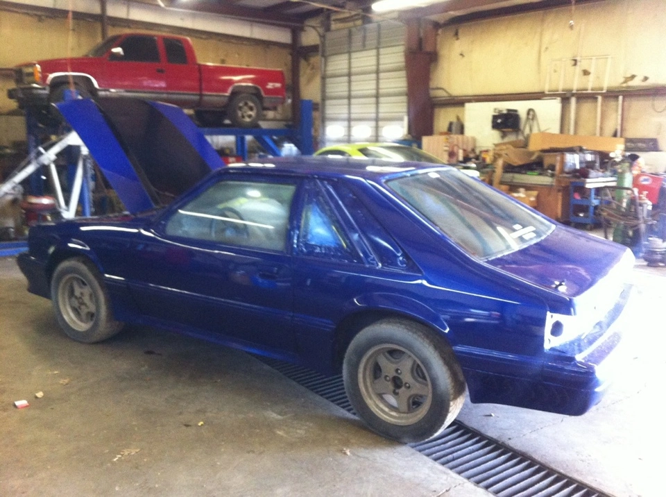

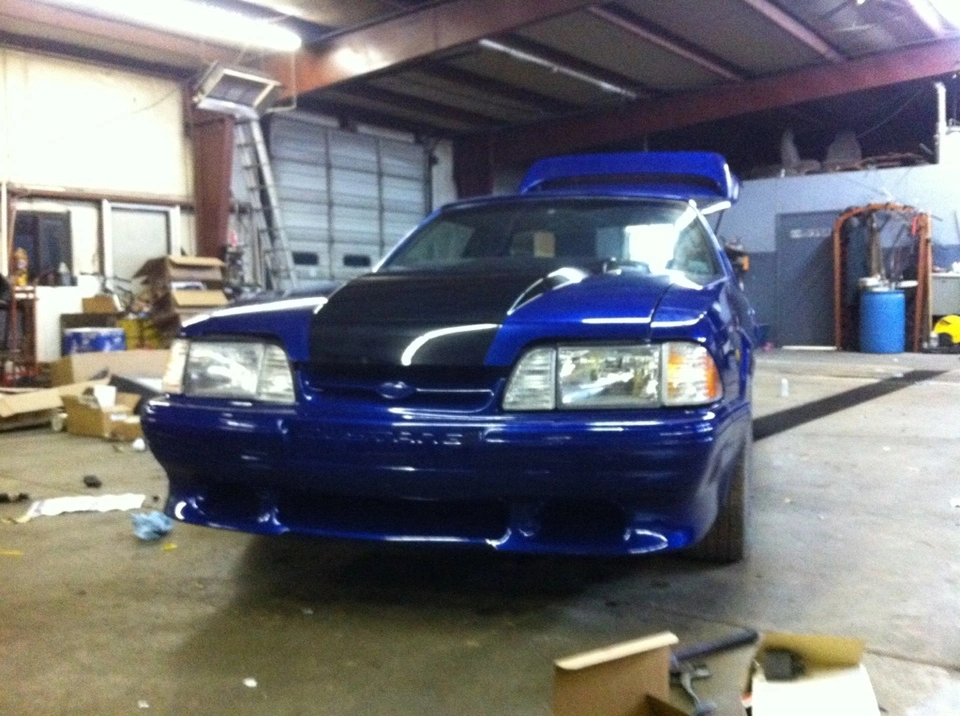

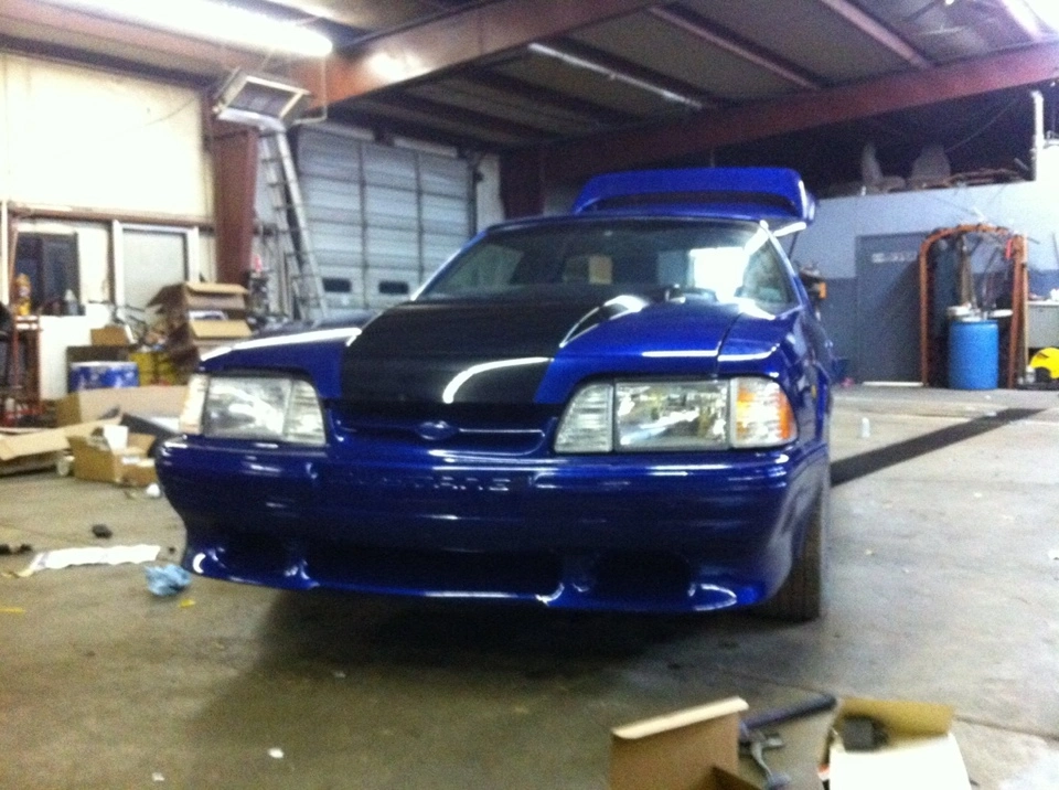

Sorry if you answered this already, but is that cowl hood steel or fiberglass? Thinking of going with a 2" cowl on mine next summer and was looking for options. Not crazy about fiberglass because watching a hood dance around at high speeds doesn't sit well with me....and I hate the look of hood pins! Saw a couple steel ones sold by Latemodel Restoration and National Parts Depot and am thinking of one of them? :shrug:
I like!!! :nice:
Steel hood :D
I sadly had to cut the supports out because of that ignorant SSI intake. So I'll probably be watching mine dance around at high speeds :(

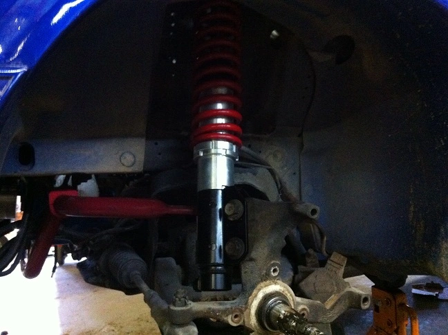

Coil overs in and new sway bar

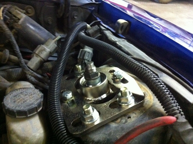

And caster camber plates.
I tried bolting up the sway bar end links but they were being a pain in the ass so I just called it a day. The new ones are about 1/2" shorter than the factory ones so they'll need a little more effort to put in. Gonna do that tomorrow and put my 5 lug rotors on. Then I'll let it down, see how it sits, then adjust the height
