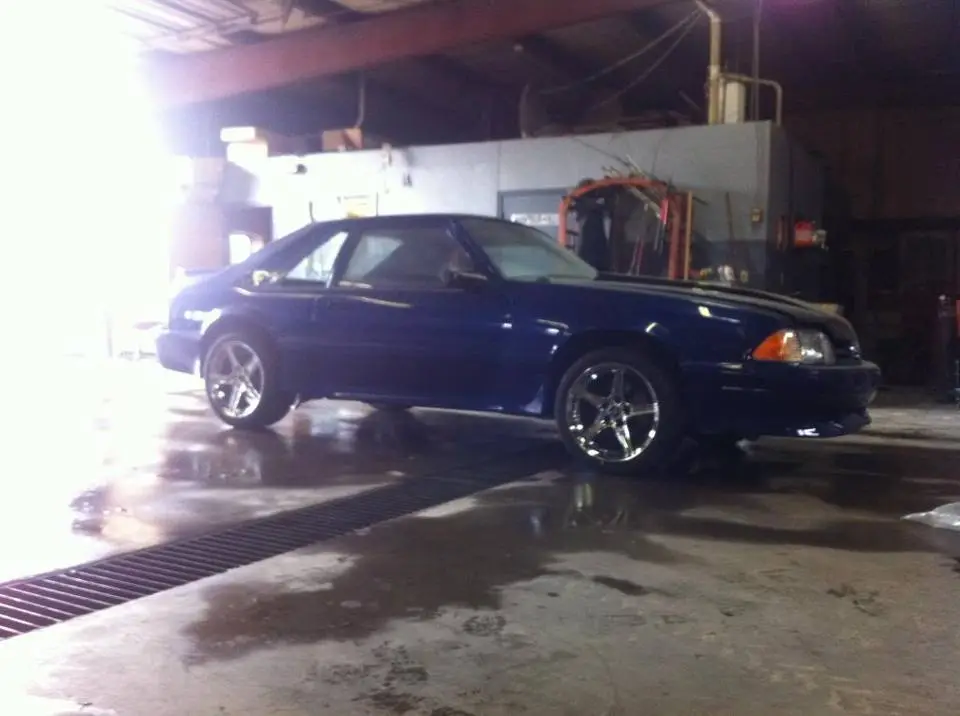

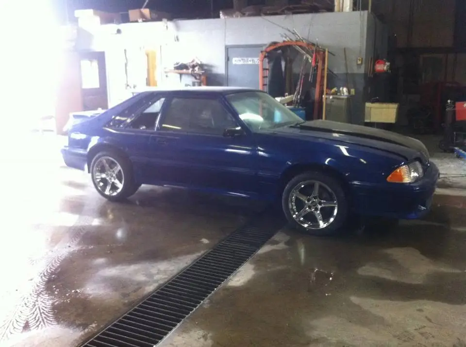

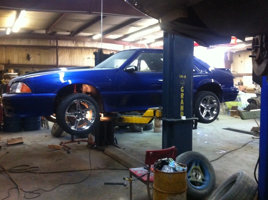

Then and Now. '88 LX
Got the correct wheels this time around :D

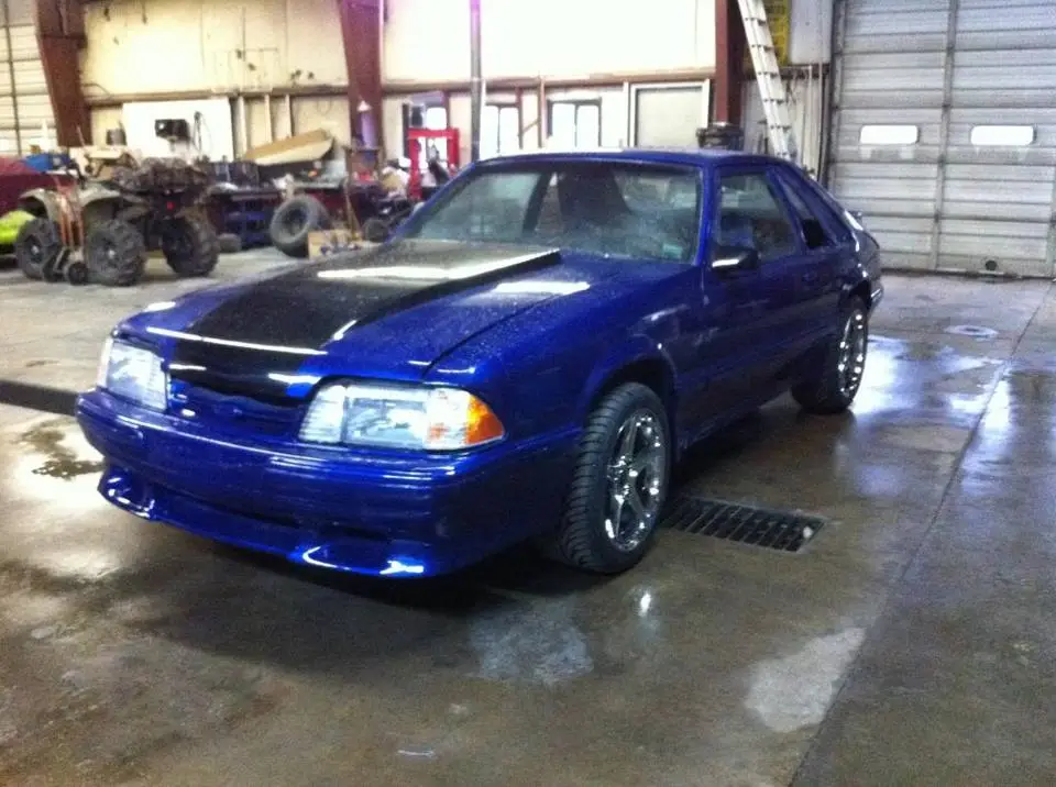

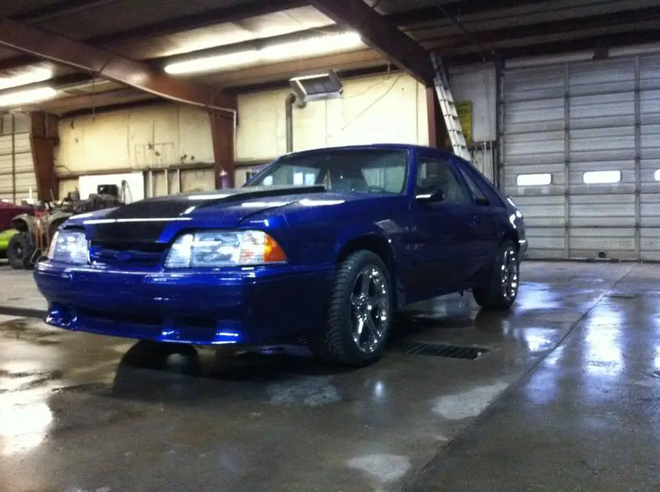

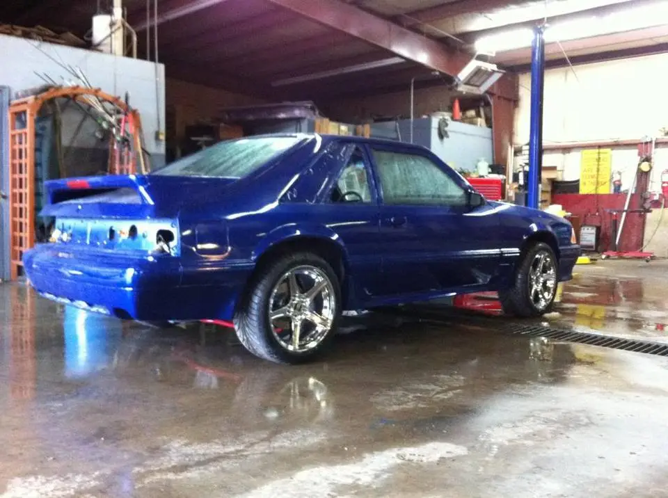

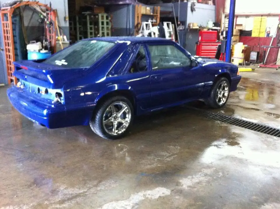

Also about the painting ordeal. One of the guys from the body shop came up and looked at it. He said they were real busy right now but if I wanted to go ahead and put some more things on the car then they'll just work around them when I bring it in. So next week I'll be putting in the new rear end along with the new control arms and I'll also be doing all the braking stuff like the Cobra master and the adjustable proportioning valve. So I may just end up driving the car down there here in a few weeks so they can get all the trash out of the clear coat

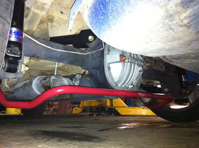

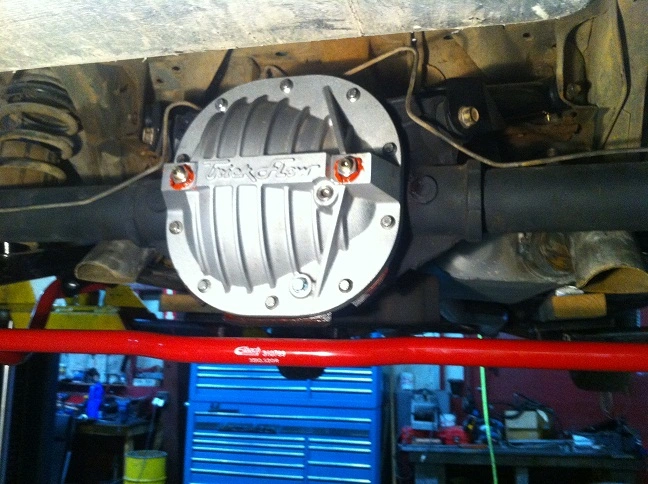

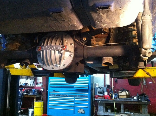

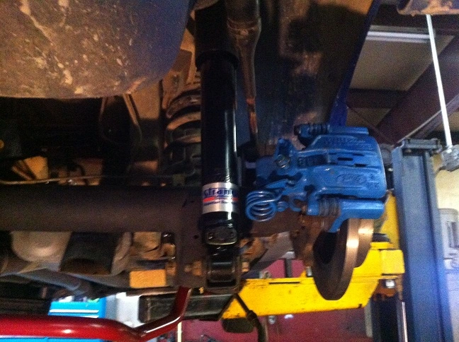

Put the new rear end in tonight along with the control arms. Tomorrow sometime I'm going to find some adapters to go from the fox hard lines to the soft SN brake lines. Plus new shocks for the rear, and then after that I'll put in the Cobra master and the adjustable prop valve.

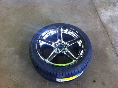

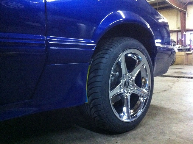

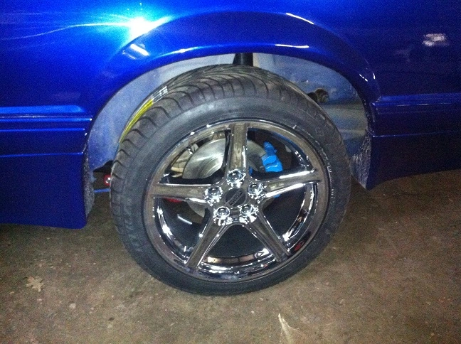

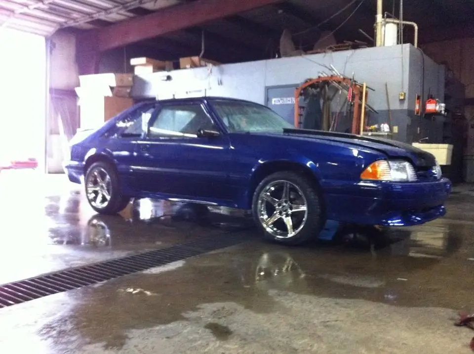

I'm glad this thing is finally moving along. Oh and 255/40/17 tires are too wide with my front coil overs. I had to order spacers, and I went ahead and ordered longer studs just to be on the safe side. They'll be here Friday, so sometime this weekend my car will be sitting on all 4 of the Saleen wheels.
So the Cobra master I ordered through O'reilly's didn't come with the reservoir, I guess I should have specified I needed the reservoir??
Anyways, the rear is in and all I have left to do is get the adapters for the brake lines and do something about the park cables. I really don't want to get those conversion cables and then have to dick with my E brake handle -_-
