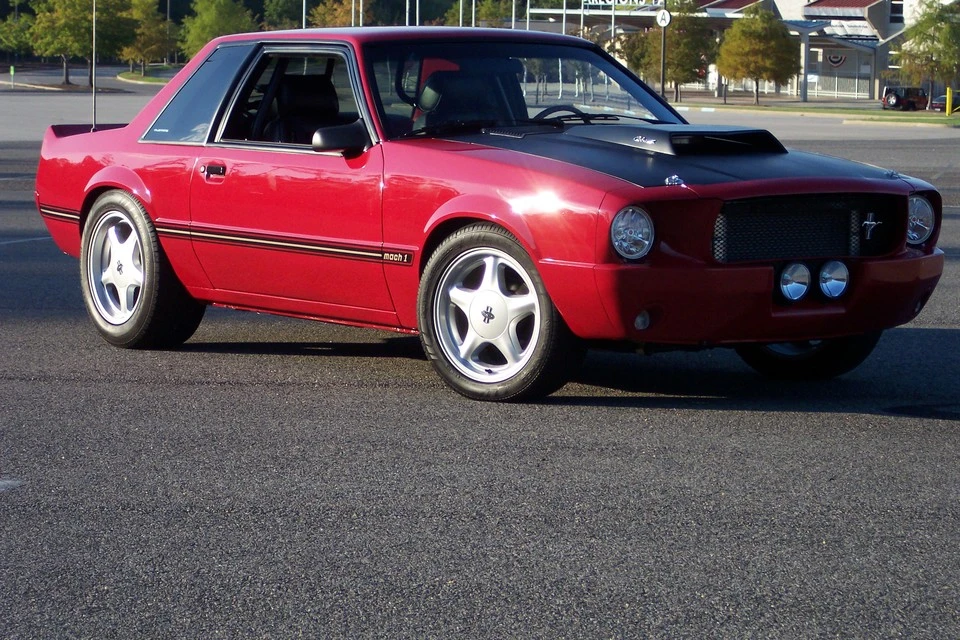

Front tires are 225 x 50 x 17 and are 26" in diameter.
The rears are 275 x 50 x 17, and are almost 28" in diameter.
The benefits have already been touched on; better ride, less impact harshness.
The cons;? Alot more sidewall to move in a corner makes for a slower responding tire in the corners, as well as a sidewall that tends to contact the inner fender lip only after entering a hard right or left corner.
