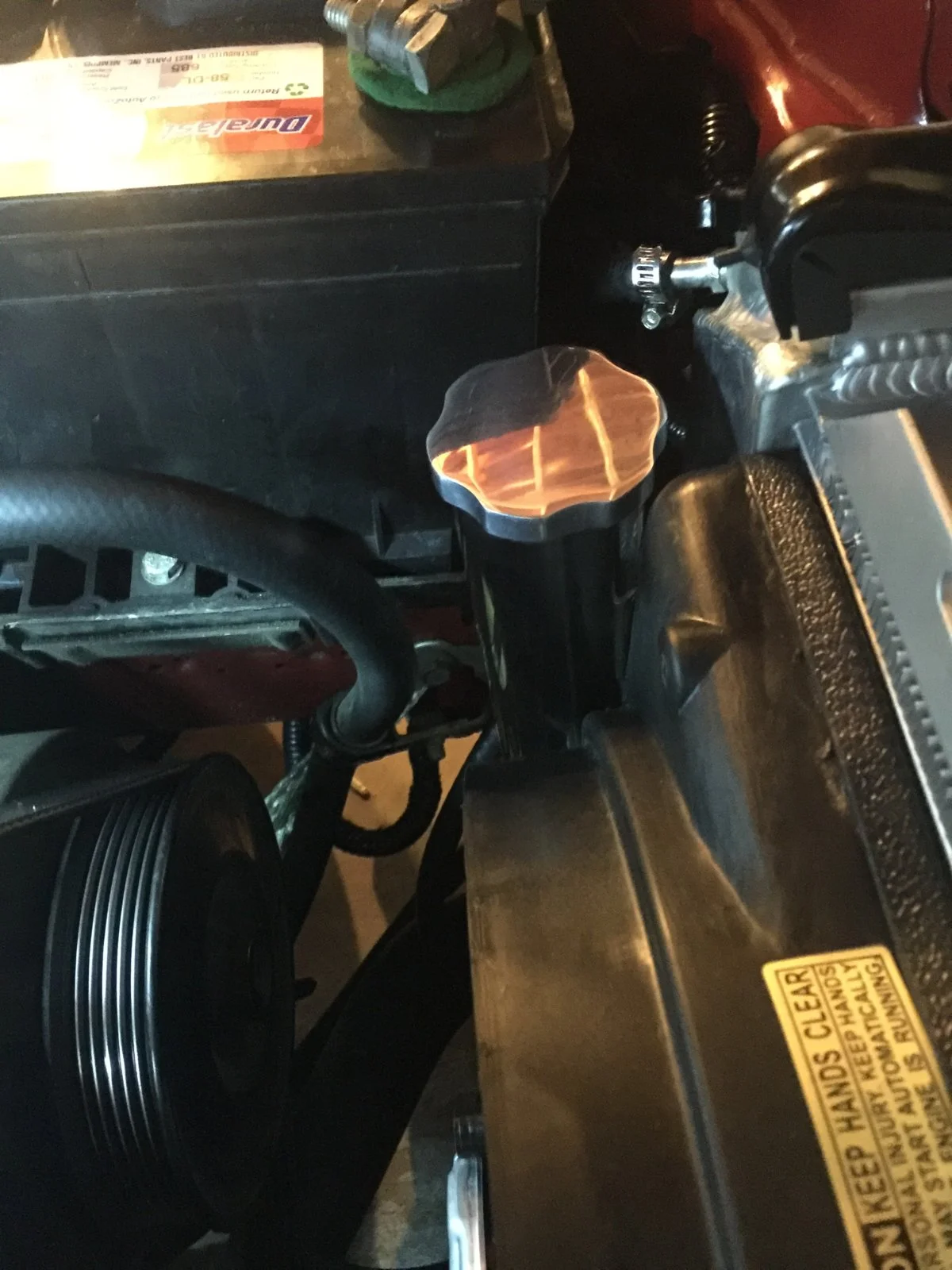

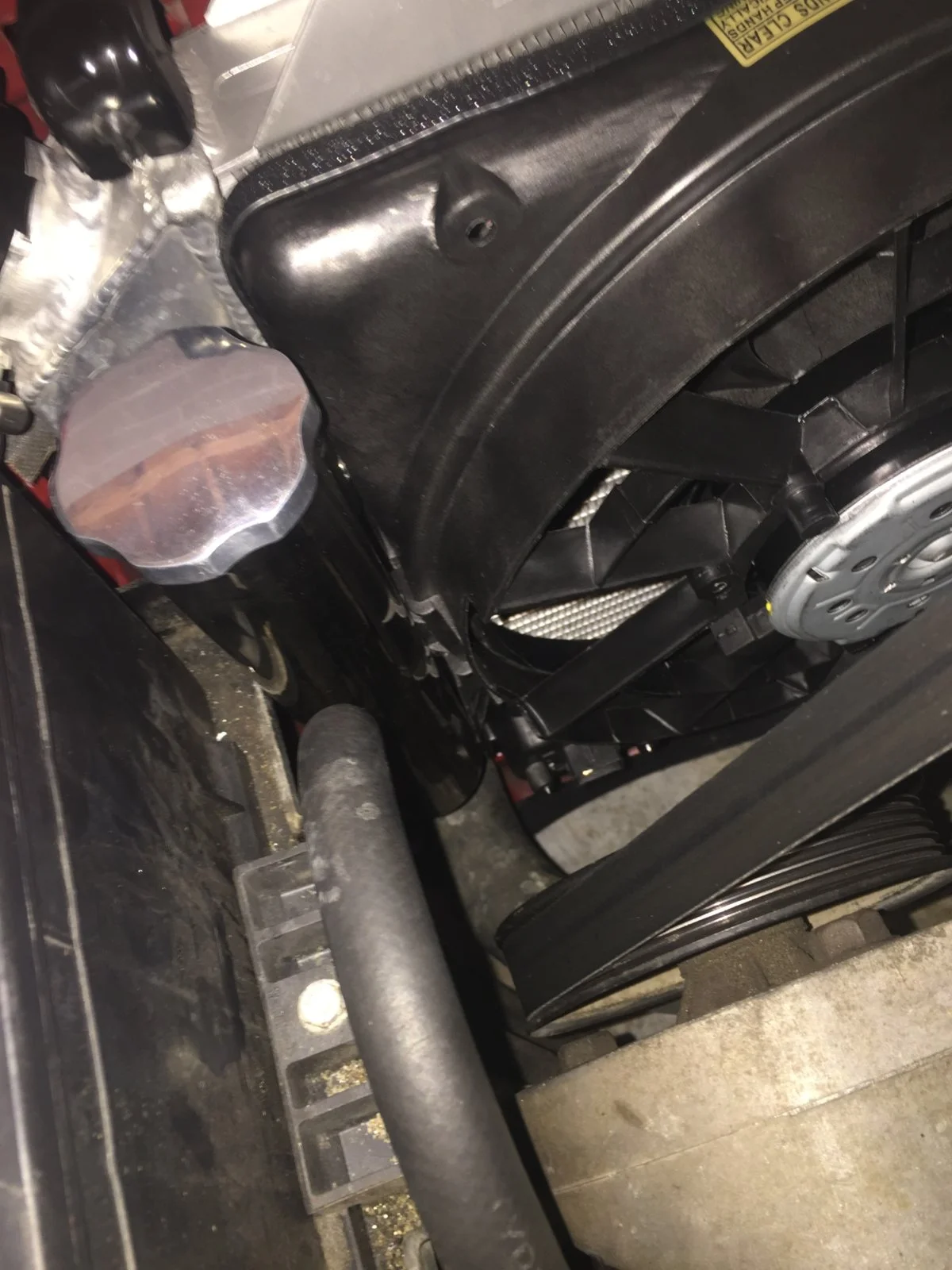

I made the mistake of not buying the integrated overflow with my Ron Davis Radiator. I don't like the way my canton overflow has to be positioned, at the moment.

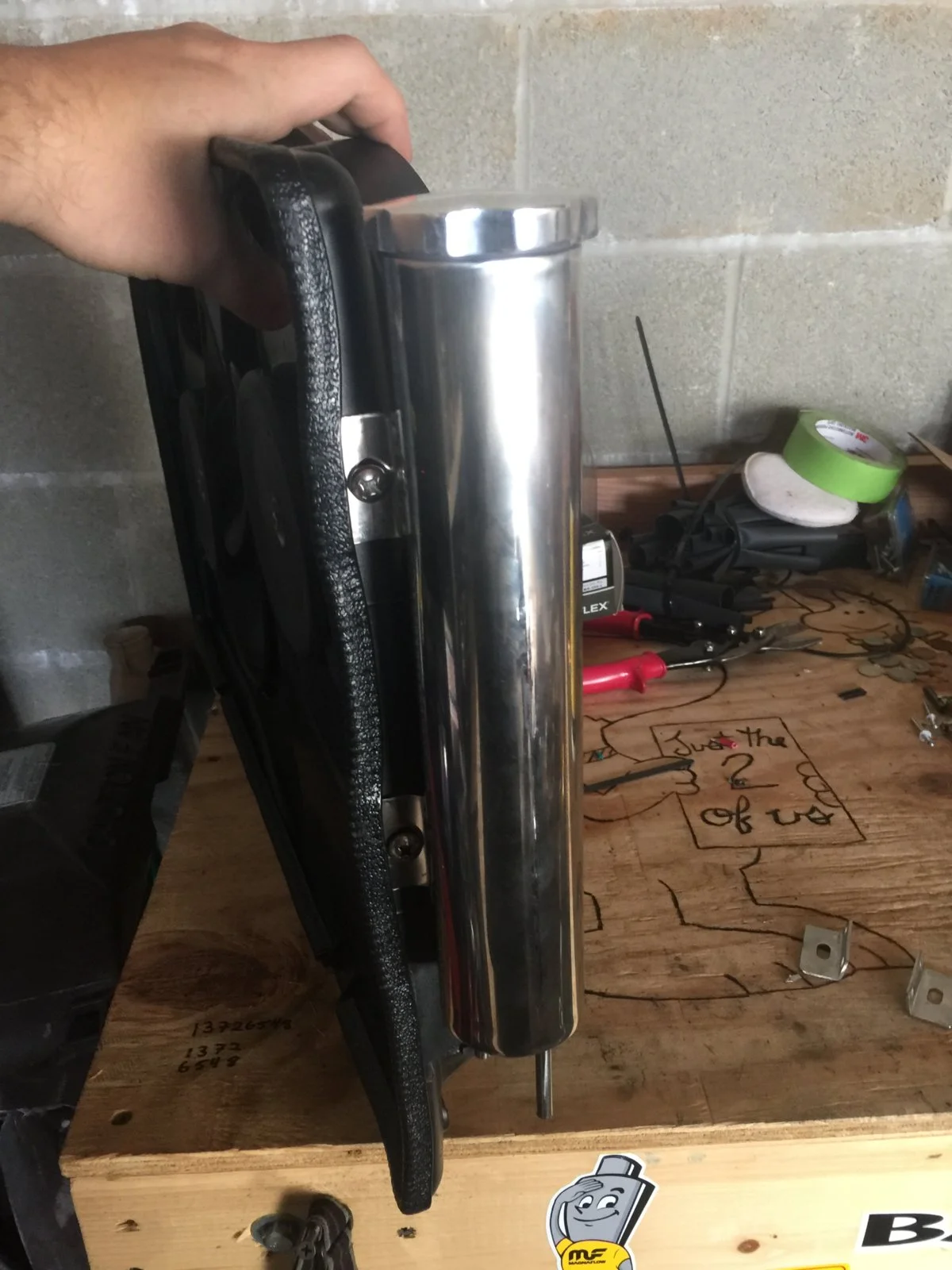

Being we are speaking about over flows . I used this eBay jammy . I don’t think it looks to bad
Man...I've been searching for an overflow solution for my car. I just don't like the moroso and I think it's too small. I made a view window and when cool you can't see the coolant....when warm it starts to drip out of the overflow vent on the top...total POS.
What size is your bottle ?
