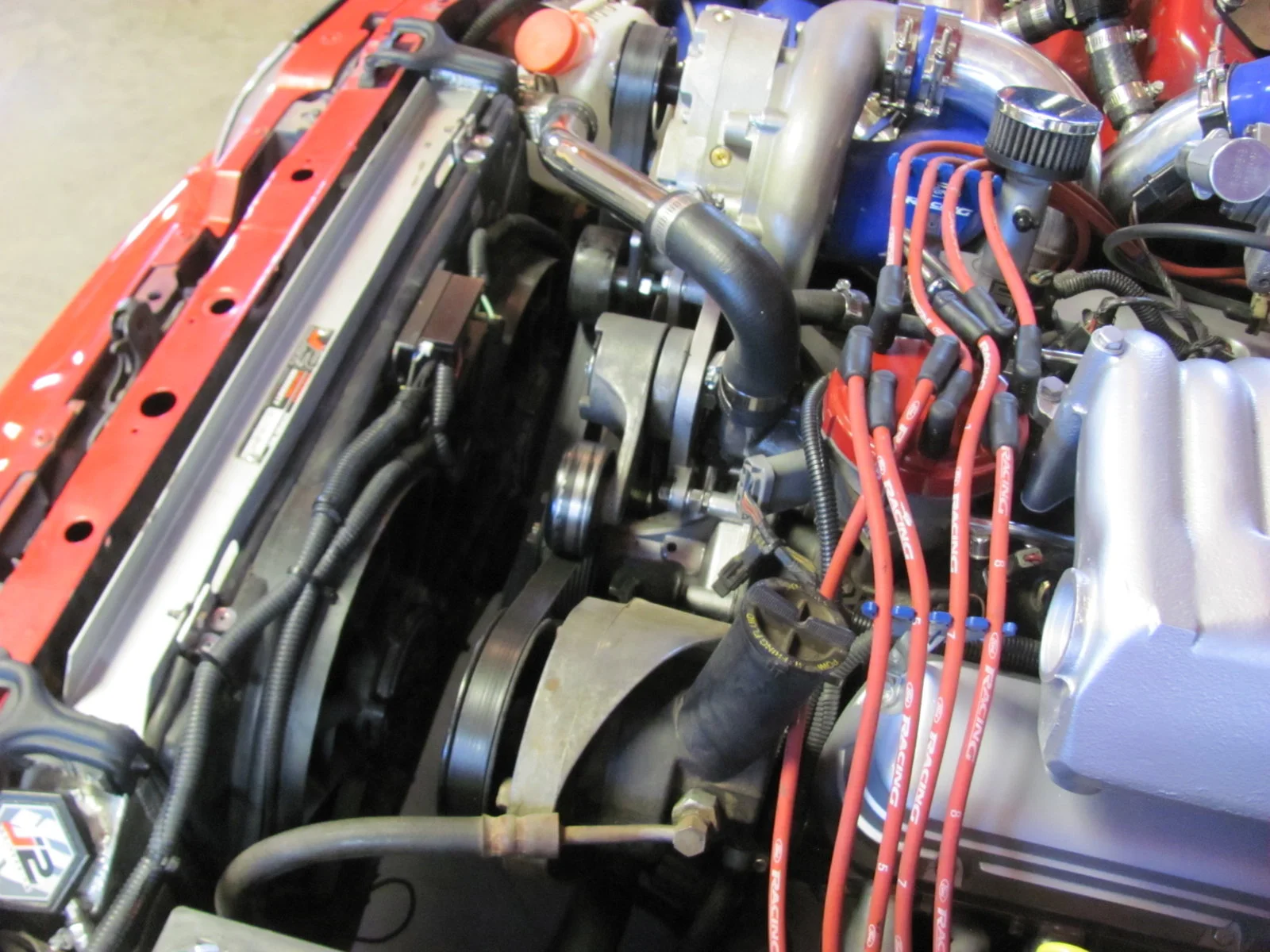

Thinking of ditching my e fans
It’s a 2 fold thing.
1. I really like the look of the stock shroud .
2. It seems like I’m constantly dealing with a loose wire or things like that.
I know if I got a really nice controller it would fix the issues, just dunno if it’s worth it.
Contour fans . Fit like factory .
Wire them correct and never have an issue . I’d never go back. Loose wires are a culprit of bad crimps or loose lugs .
Reactions: RangerJoe
I went back to stock after 10 years of issues with the electrical ones. I DD my mustang still and the stock clutch fan keeps the car cool not matter what.
I had issues with the fans draw and them needing to come on/off in traffic, had one of the relays fail and almost over heated the car, you have to get a good fan bc those flexilight fans are a joke, ran the SN95 & Contour fans before but in the end liked the stock simplistic fan the best
I really liked the idea of the fans. Maybe I’ll just redo it all, but I had a real close call the other day from a loose ground. Right now my main concern is just a good driving and decent looking ride. I know if I keep it I need to pull it all and redo all the wires and make it right, but I’m torn on that being worth the effort.
