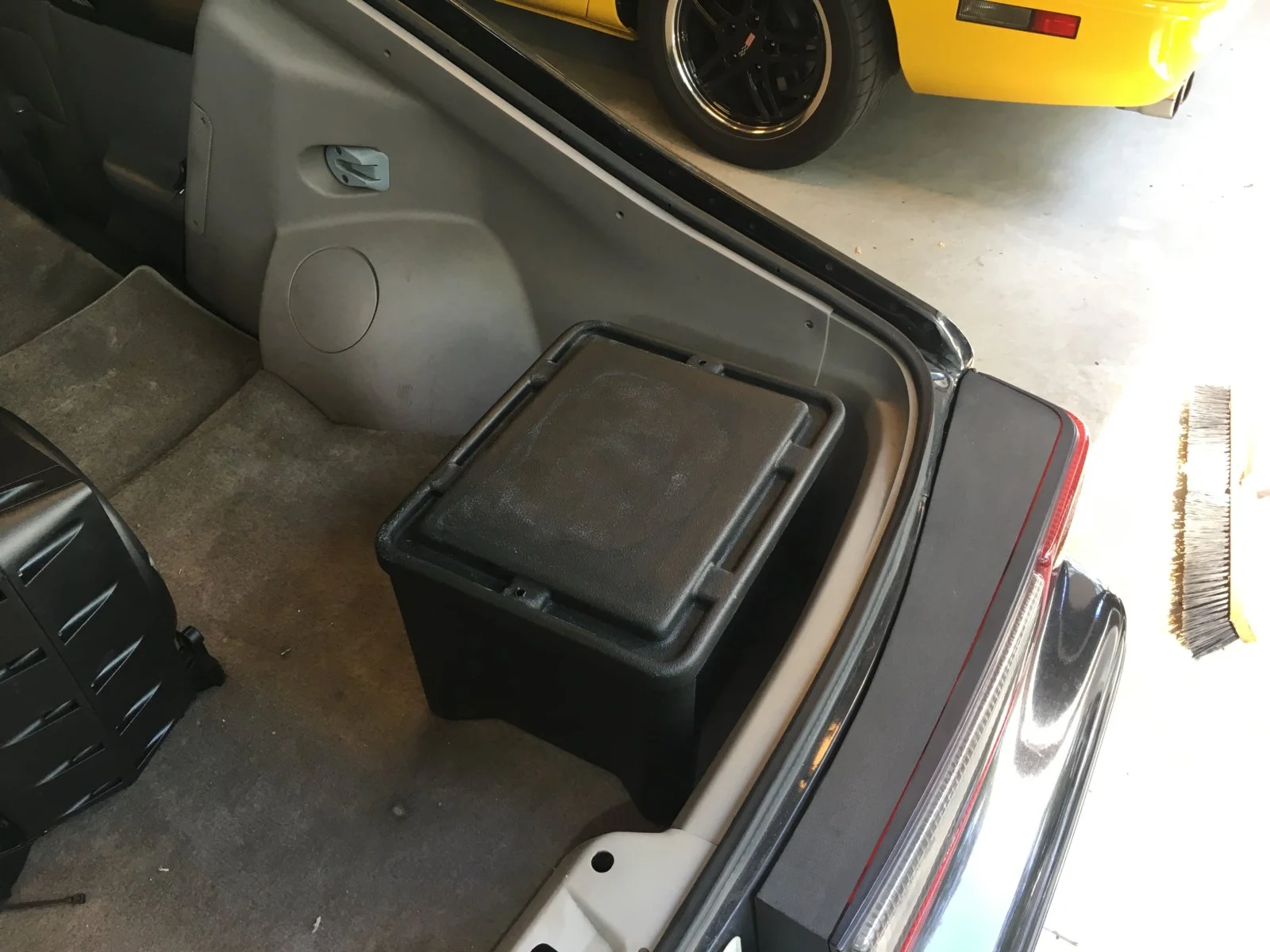

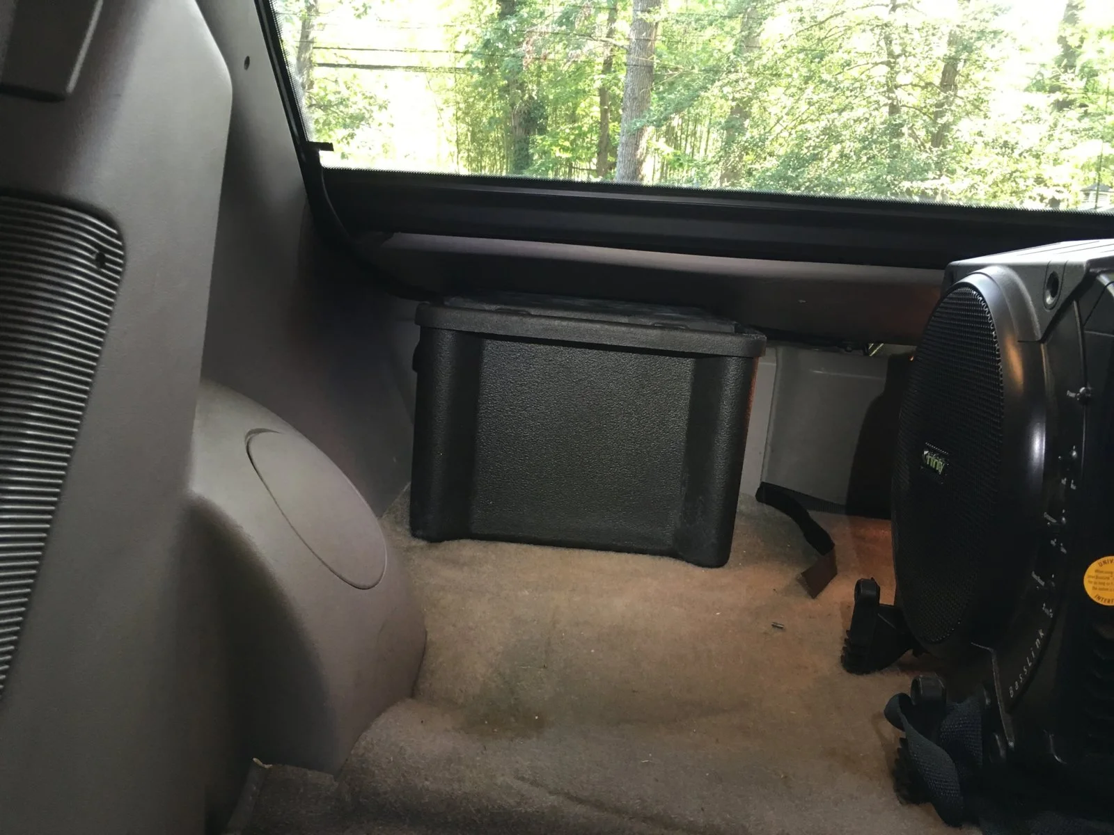

I had the Taylor in my hatch damn near forever. Full carpet, full padding. I even had the hatch cover over it. Only thing I had to do is cut the top off the studs so the retractable hatch cover didn't get cut on the bolts. I'd check or take pics, but I threw it out when I changed the carpet and changed the box to a black moroso.
What I don't remember is if the cover clipped the back corners all the way in the back. If it did, you certainly couldn't see it with the hatch down.
The Summit box it $69 and more compact. Other trim in my interior is black and so it the Summit box. As gaudy as it may look in black, I think aluminum would look worse.

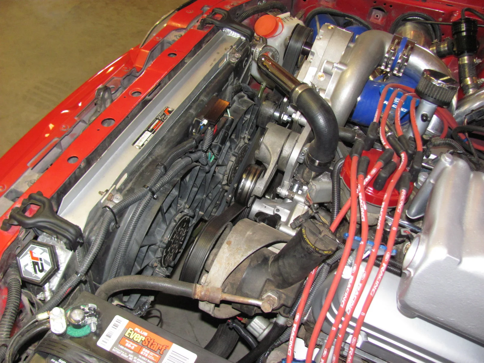

I got the contour fan assembly in and I’m gonna do some bench testing on it. I see it has a resister built into the frame. Do I bypass that when installing with dcc control unit? What’s the resistor function in the stock contour application?

Ditch the resistor and wire both fans in parallel to the DCC controller. Works perfect on mine, both fans ramp up and down as needed. If you're using the variable speed DCC controller with the Contour fans, you'll also need the input filter he offers to make low impedance fans work. No idea what the resistor was used for in the stock application.

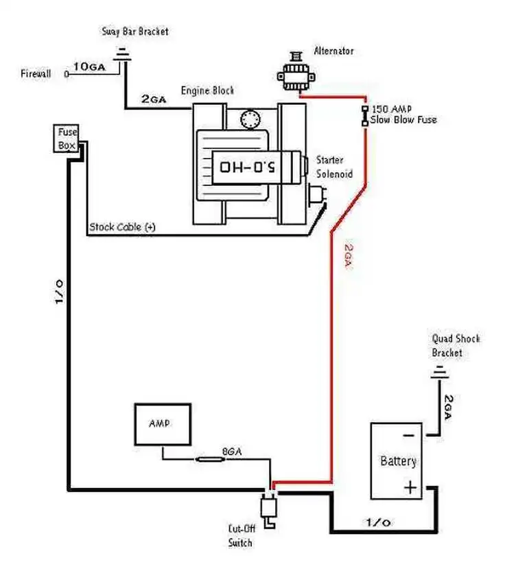

Anyone have suggestions on the routing plan of battery cables from the hatch area to the solenoid? I also want to run a the neg all the way to the block.
Thanks for posting that diagram. Although, it appears to show a car that has the solenoid on the starter. My solenoid is in the stock location drivers side engine compartment. That diagram also shows a cutoff switch which i don't plan to install.

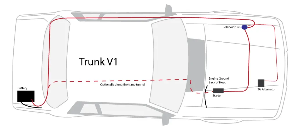

Im going to start a new thread on my battery relocate. Meanwhile, this pic below is what ill probably do. The optional line, and im thinking ill run it through the interior. Ill go behind the rear side panel, under the rear seat, under the carpet along the trans tunnel, exit the interior about half way up the firewall and into the engine compartment. Once in the engine compartment ill cross the firewall to the drivers side and tap the solenoid. Ive already got a massive alt cable like shown in the image below. Ive mocked it up and it looks fairly easy.
