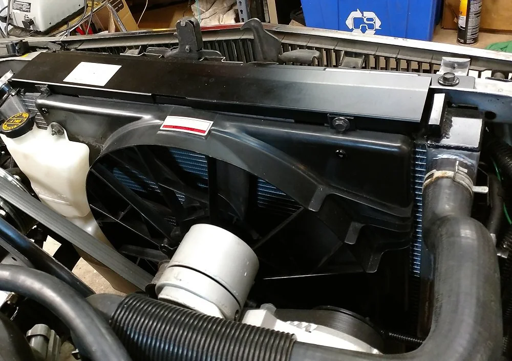

Pretty happy with how mine looks. The overflow tank fits on the Mark VIII fan like it belongs there! And the shroud covers most of the radiator. Just some small gaps to deal with.
Reactions: 90sickfox
