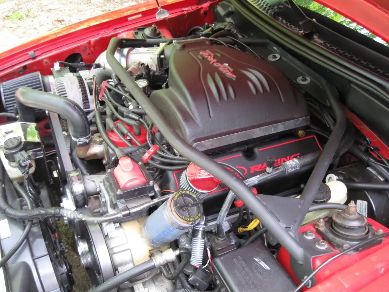

Hey long time since I've been on. I'm going to do a 351 coming up later this year or first of next year. Let me clarify that the car will not see the track and will be driven mostly on weekends as I have a lot of vehicles that need to be driven also. My setup will be geared toward great drivability and lower end torque for where the car will be most of the time. Intend on using a stock 351 block with maybe a 3.750 crank ( 385 c.i.), custom cam, Trick flow R intake, AFR 185 or Trick Flow 190 heads, BBK or Mac 1 3/4 LT's , and probably 4 hole fuel injectors. These pics are from Venom351R and sent him a message today so I'll see if he's still on. I see he hasn't been on since 2016.
What I want to know is for what I'm going to use the car for is using the elbow setup like he has in this pic as well as the filter in the bay, is that a super negative? If it is as far as overall performance how much do you think I'll be sacrificing hp/tq wise?
Also will I need a front sump or rear sump oil pan? Car is a 95
Venom351R 351 setup using trick flow R and elbow setup with filter in engine bay.jpg
Venom351R 351 setup using trick flow R and elbow setup with filter in engine bay.jpg pic 2.jpg
Dang I just remembered about the limited selection tb size for the 94 95 and not being able to find one in a 90 mm with an elbow if that still holds true

Since you said you have a goal of a more street able, torquey engine, I wouldn't worry about the limited throttle body size issue and just run a 75MM R Intake with matching elbow and throttle body. You can make plenty of power with a 75mm throttle body in the 1500-5500 RPM range on a mild stroke 351.
Having the filter in the engine bay is a negative, but it's not as big a deal as some make it out to be.
Now if you are truly looking for max power, that changes things...
