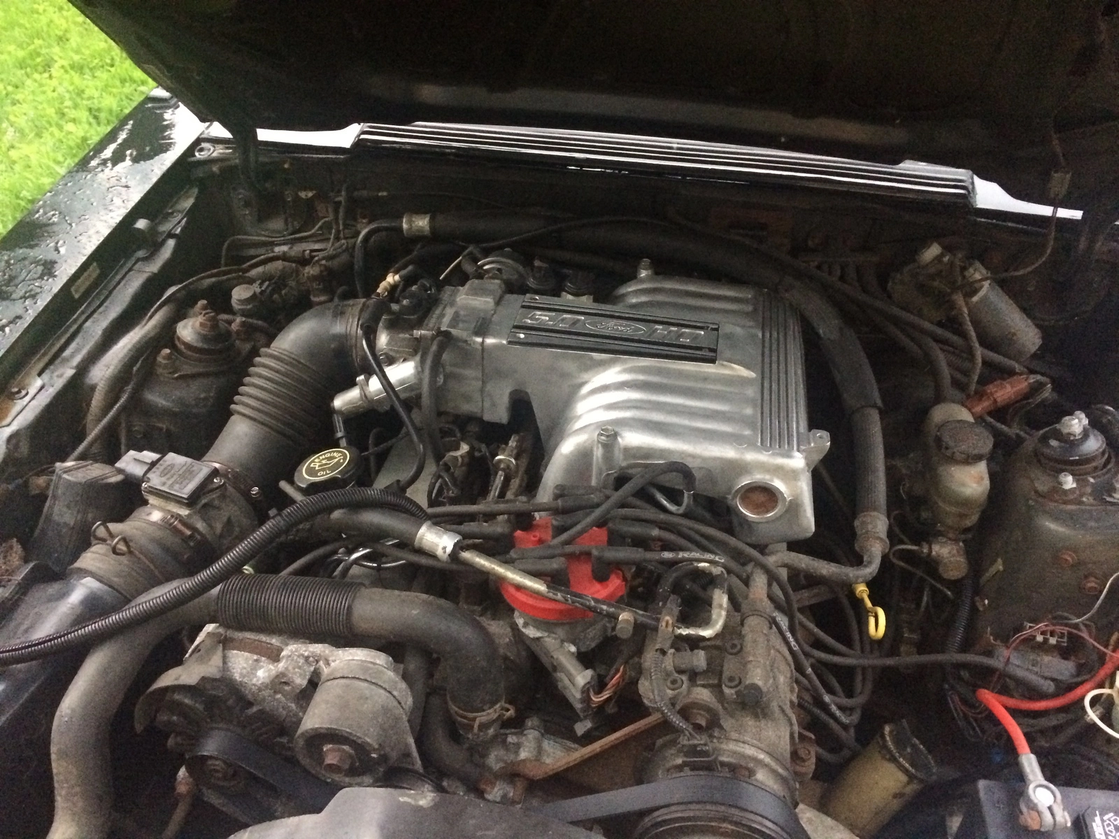

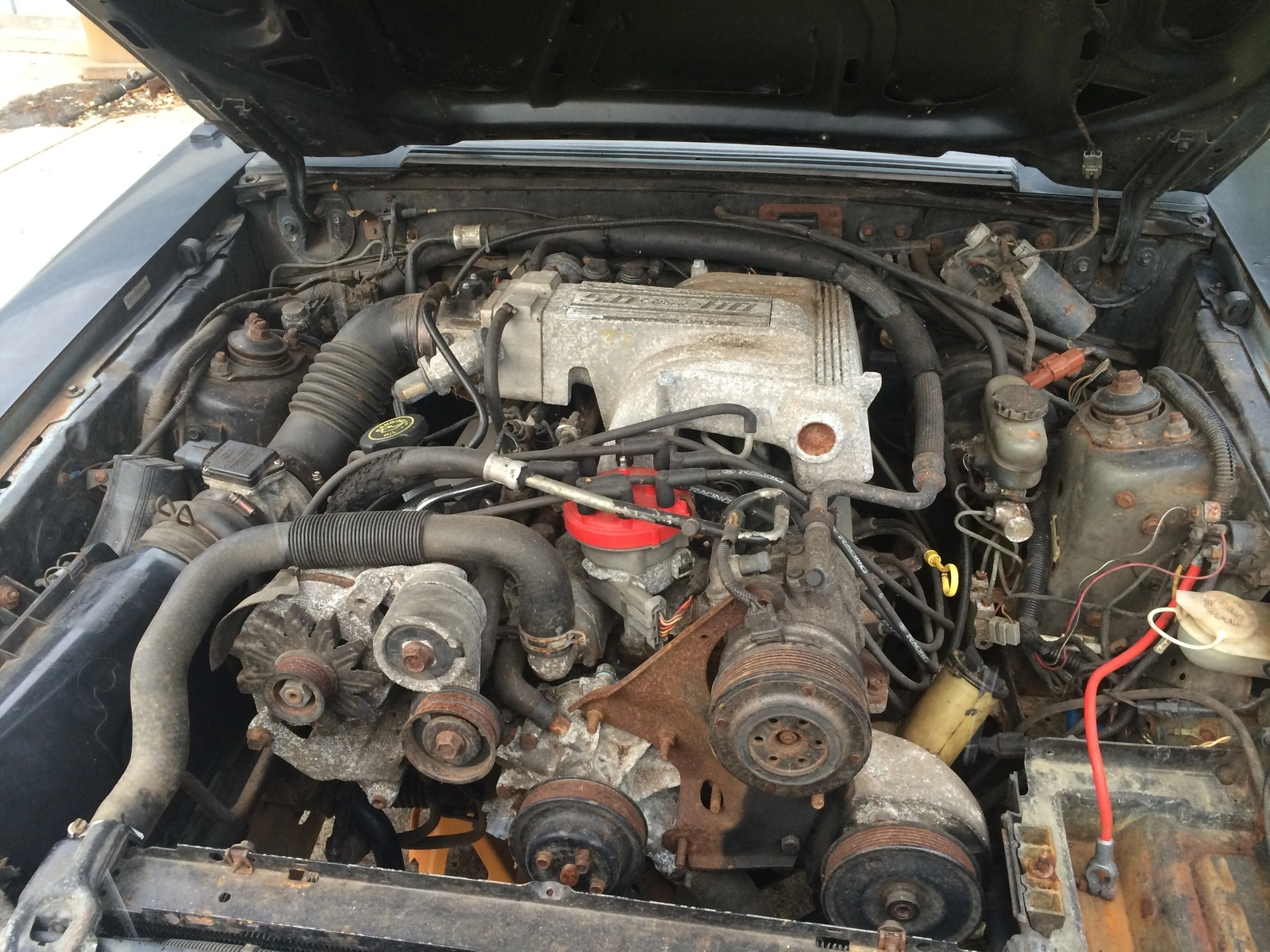

Another small improvement over the past day or so. Put the cleaned up intake back on and plumbed it all up. I just need to make sure all the vacuum lines are hooked in and the TPS is set right and hopefully she'll run without any input from my right foot this time! Tires will be here tomorrow and with any luck I could get it on the road next week. STOKED!
For a quick comparison here is before and after the intake was cleaned up.
Before:
After:
As always, there is still plenty of work to do and cleaning. But that alone makes it look so much better.

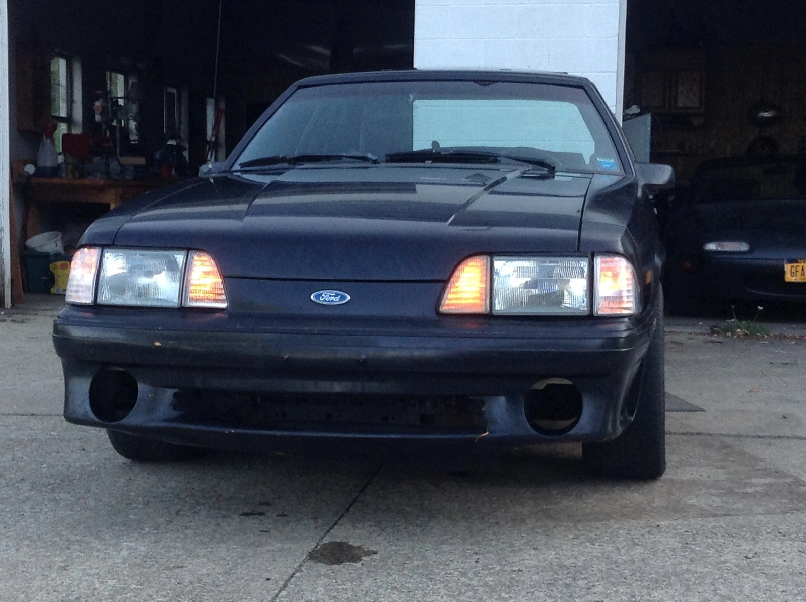

Since everyone likes pictures here are a couple from today.
Congrats getting her on the road. I cant remember for sure, but if you search I think you might find that you can run 14* base timing before running into any detonation issues. Have you cleaned the MAF wires yet with q tips and MAF cleaner? If not, that may make a HUGE difference in your lack of power issue. I have replaced a couple flywheels and stuck with stock on both. From what I read, an aluminum flywheel will take more revs to get you going off the light, and you cant putz around as easily as it doesnt have the rotating mass to keep the car moving under little/no throttle. That is just my $.02, I would be interested to see what you thought if you do go with aluminum though.

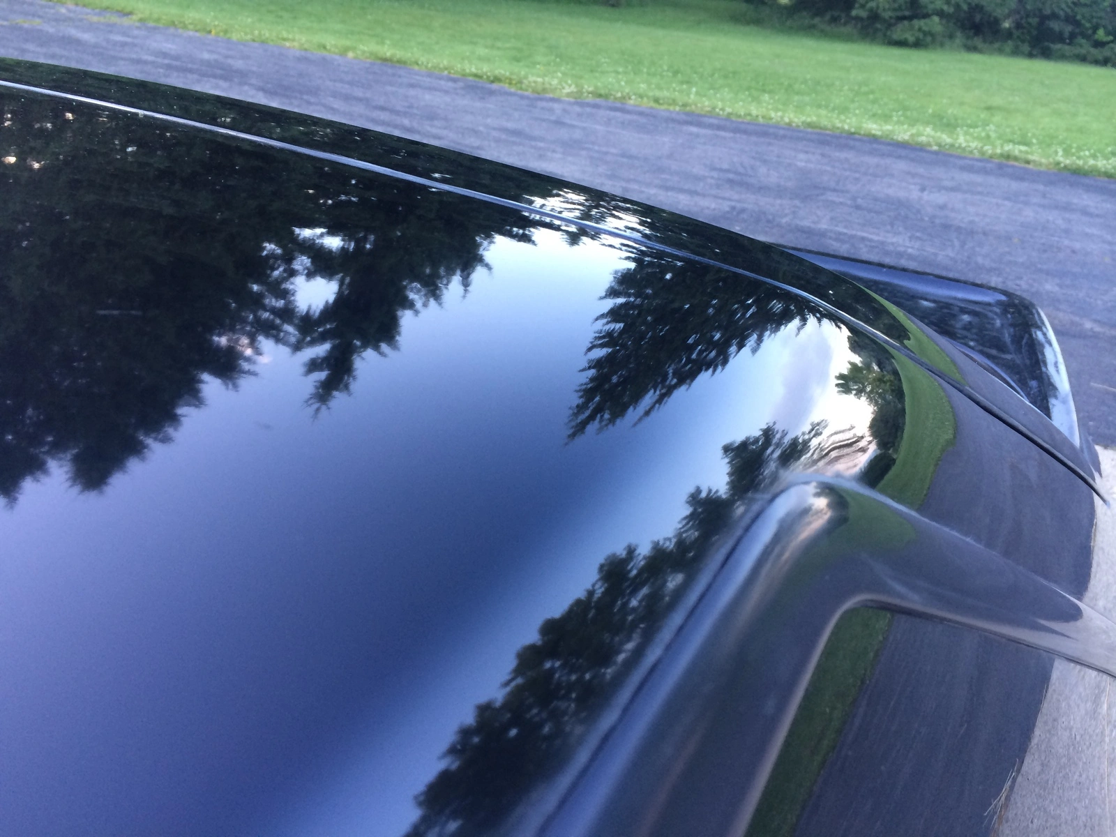

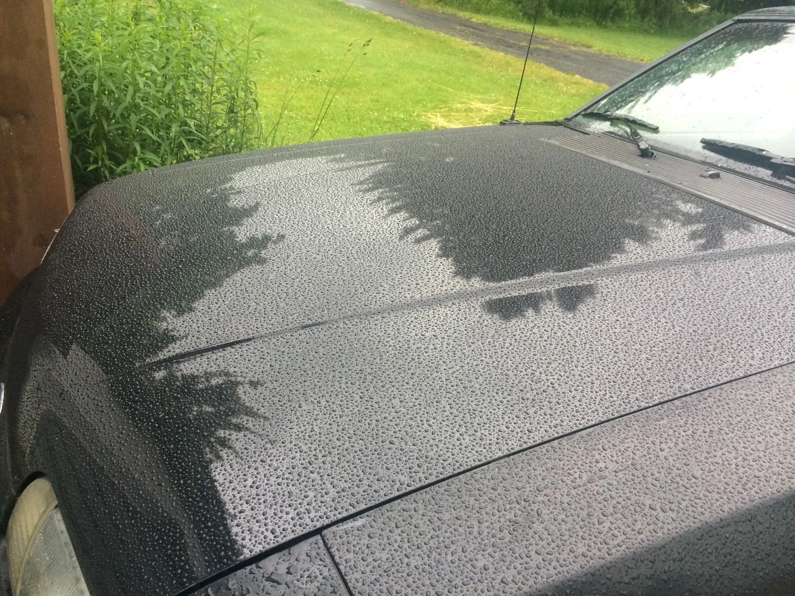

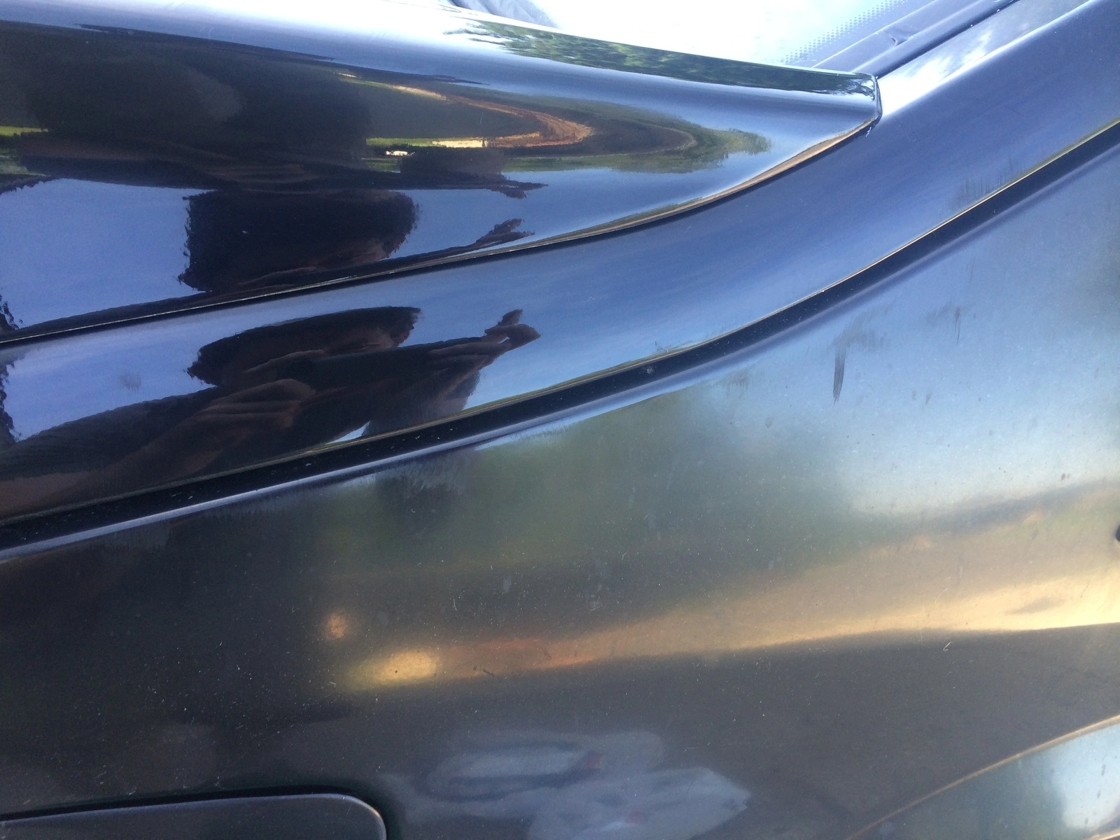

I also managed to stumble upon a sears liquidation sale and picked up a DA Sander/Polisher for like $50 at like half off. I had previously started hand compounding/polishing earlier this week and itched for a polisher like I had at the body shop I worked at years ago. This one will do for now and will cut down on the soreness and time. I started on the spoiler and passenger side, making it to the passenger side of the hood. The difference is night and friggin' day. I can see all the actual imperfections in the paint now but it looks like something to be proud of now. The car is finally coming back to it's former glory. I may take it to work this week if I get it ready enough. So happy to have it back!
Thanks @boostfrk, it very much is satisfying to have it have been in such great shape, only to see it come on hard times and get back up to where it was. I am getting there. I just started polishing up the paint last week and it still has a nice shine left under all that dirt that accumulated over the years. Here are a couple snaps.

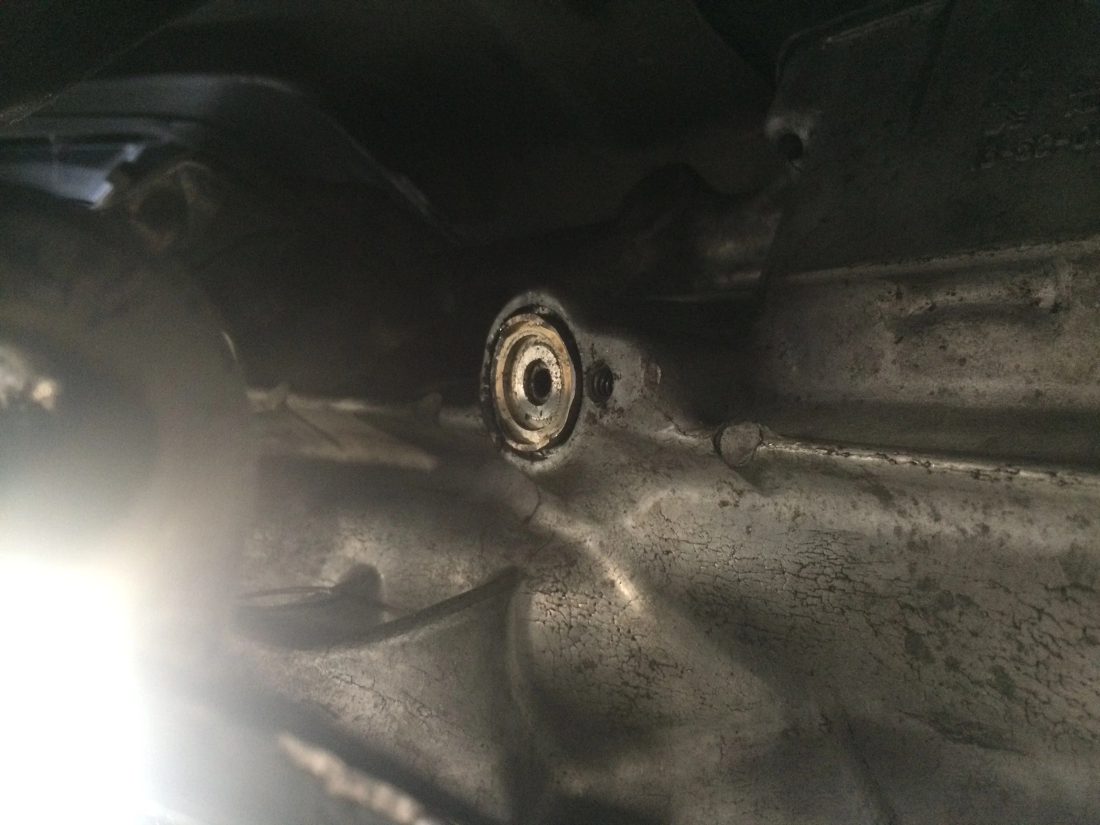

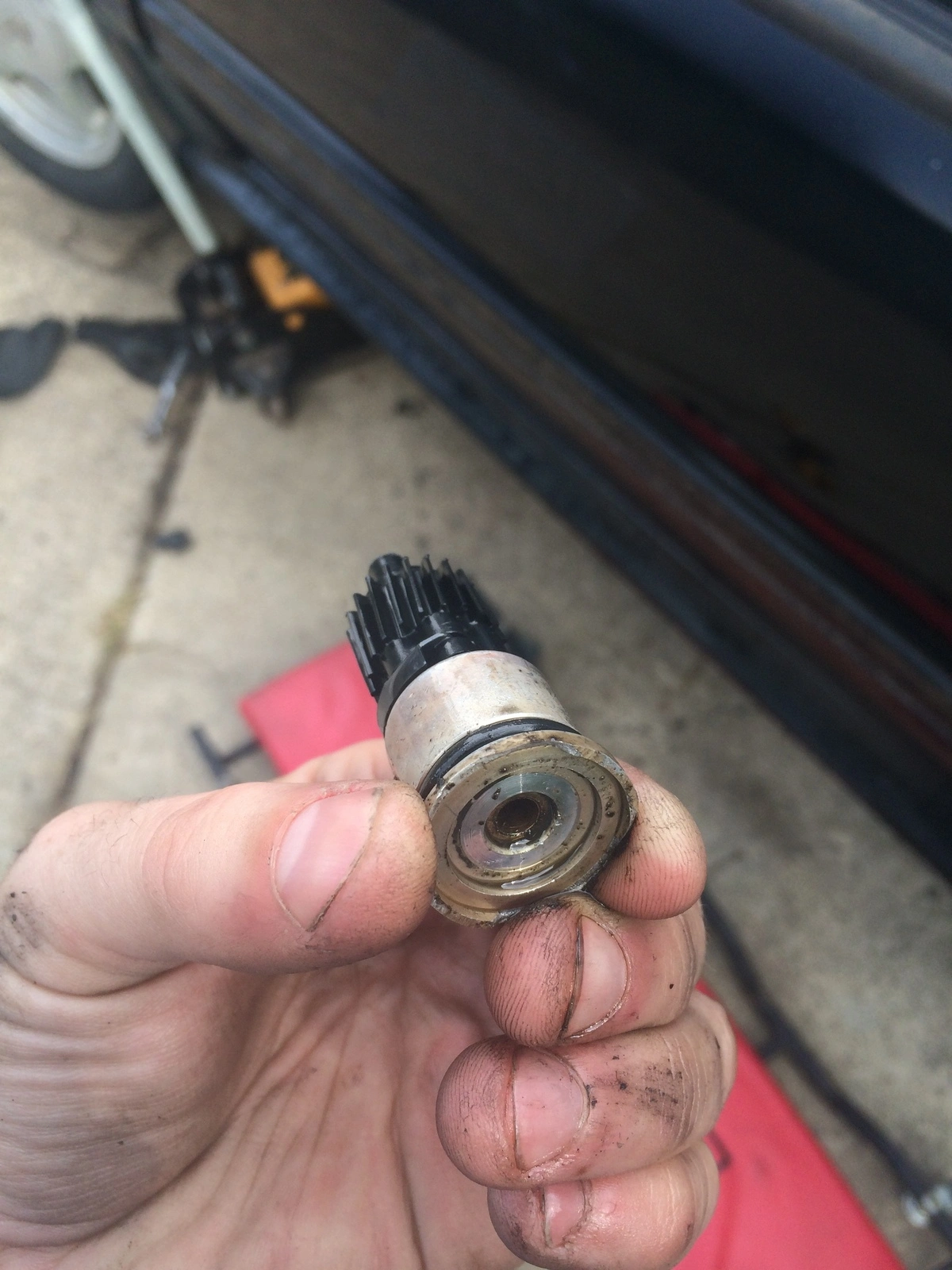

I also just finished up the speedometer gear and sensor yesterday. I actually only managed to damage the sensor with the gear still inside so I only had to replace the sensor which was nice. Took a little convincing as it was nearly flush to the transmission. See below. But a proper sized screw with coarse thread and a set of vice grips and it pulled right out. Now I can tell how many miles I am putting on it while putting around. I managed 5 whole miles yesterday, hah.

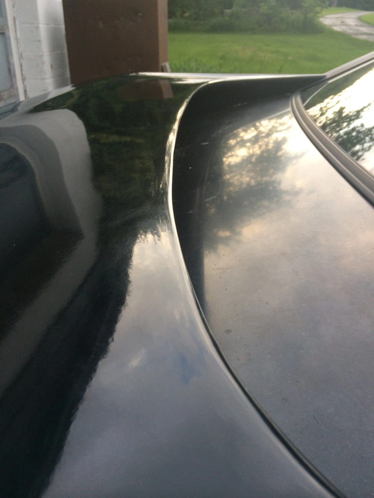

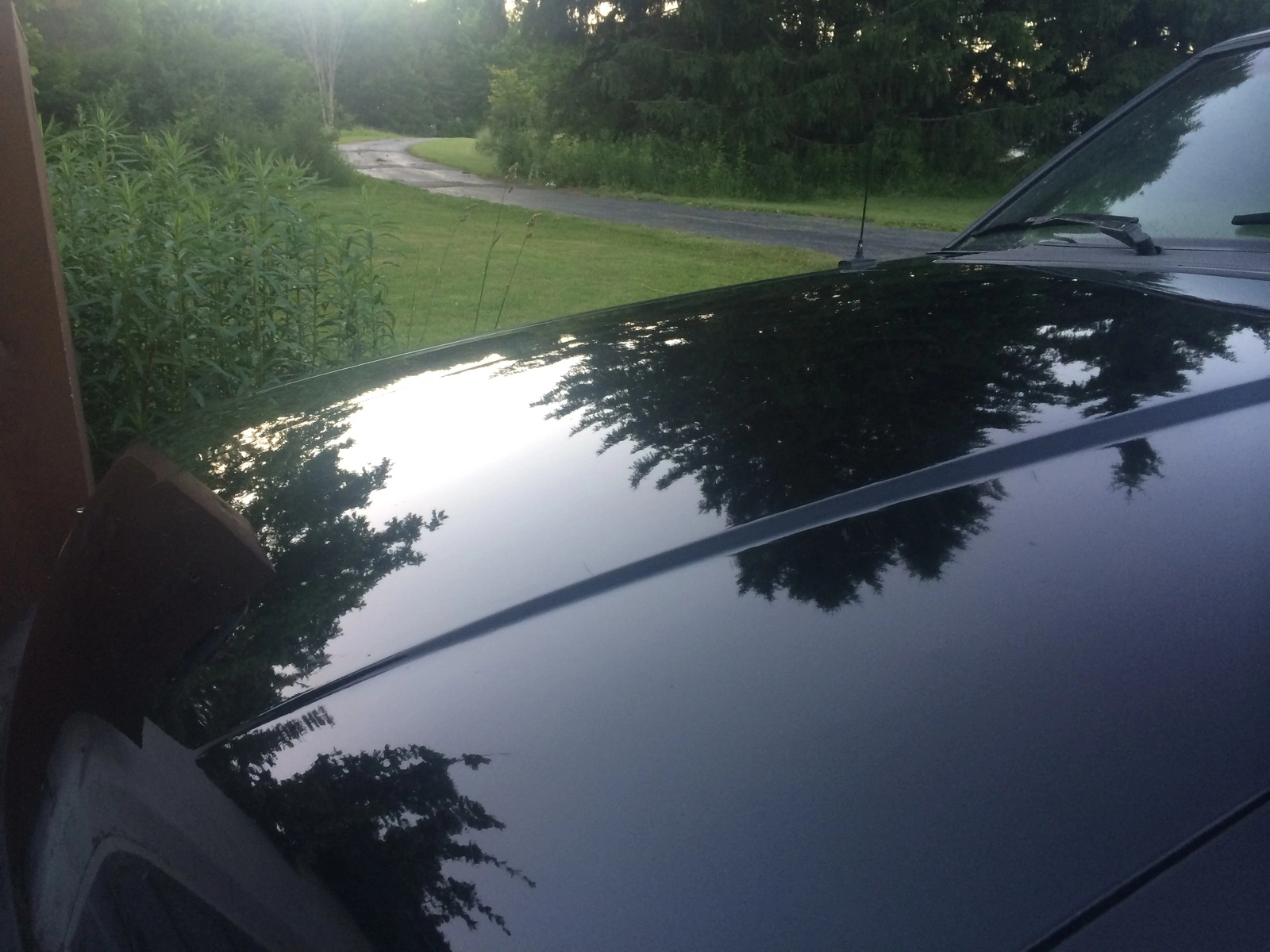

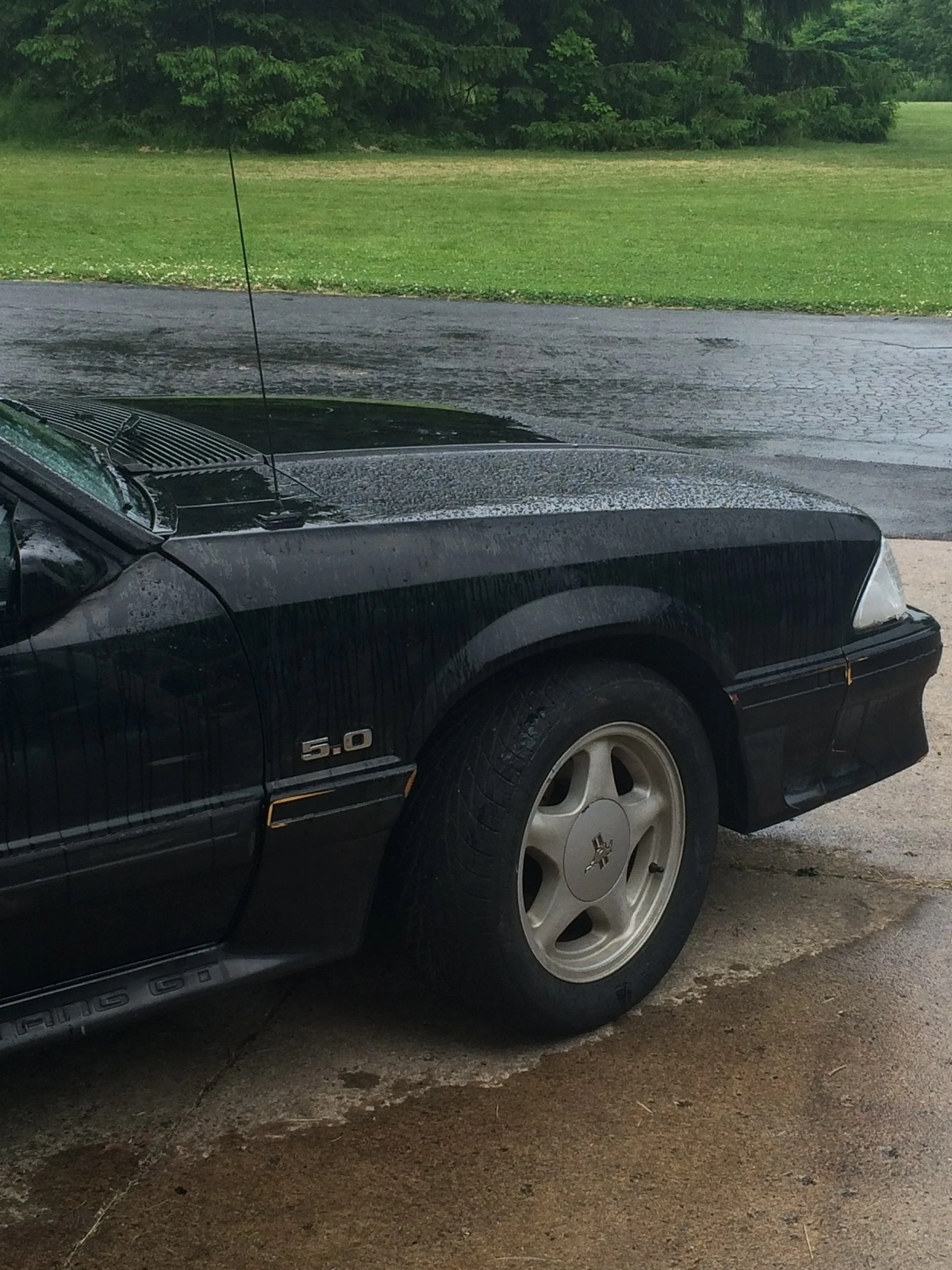

Update:

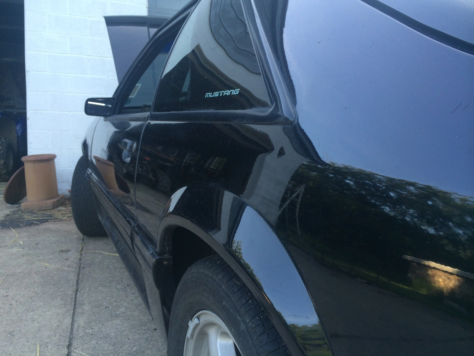

It has been a few weeks since I last posted. I have been crazy busy with work and nice weather activities. Otherwise the car is finished being polished and looks tons better. Plastics will need some paint at some point but for now I think I will just enjoy the car as is until funding becomes more readily available. Exhaust leak is fixed. It turns out the damn EGR was leaking at the back of the passenger side head. The crimped-welded-pipe(aka plug) must have come loose after all the rough idling and sitting over the years now it sounds like it used to!

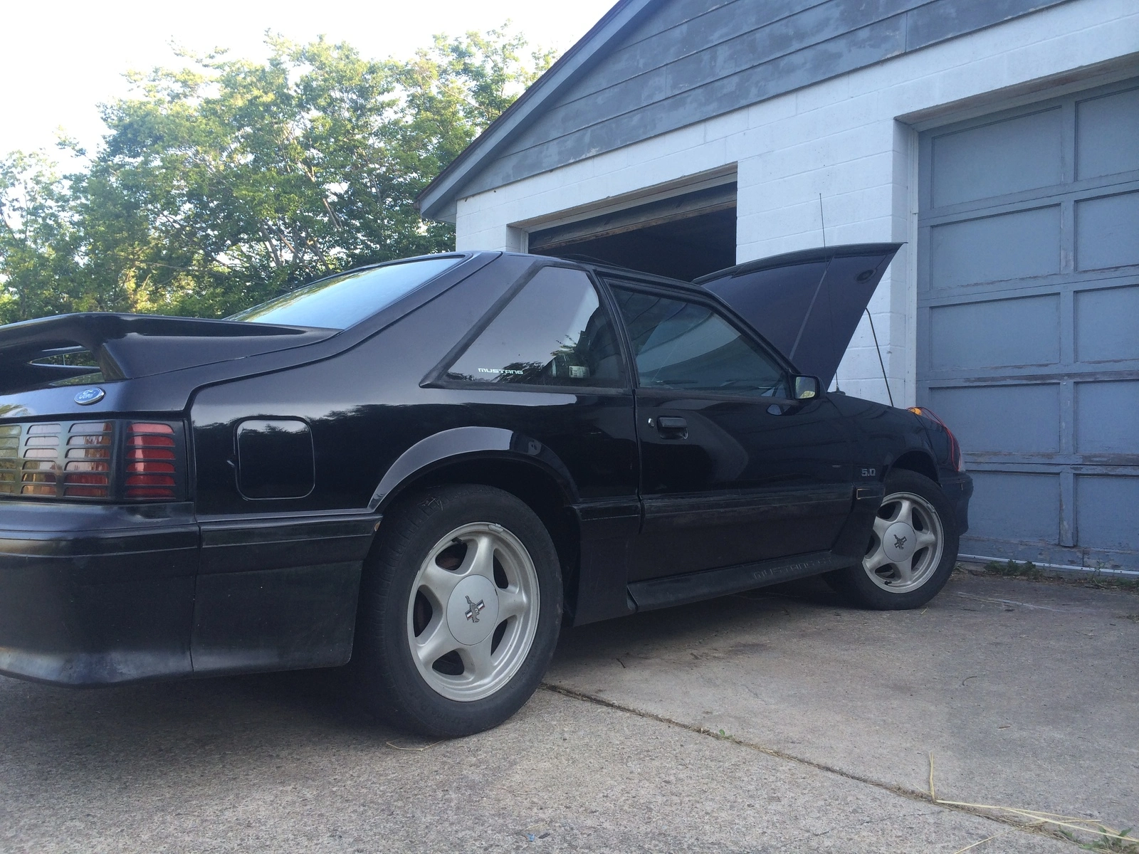

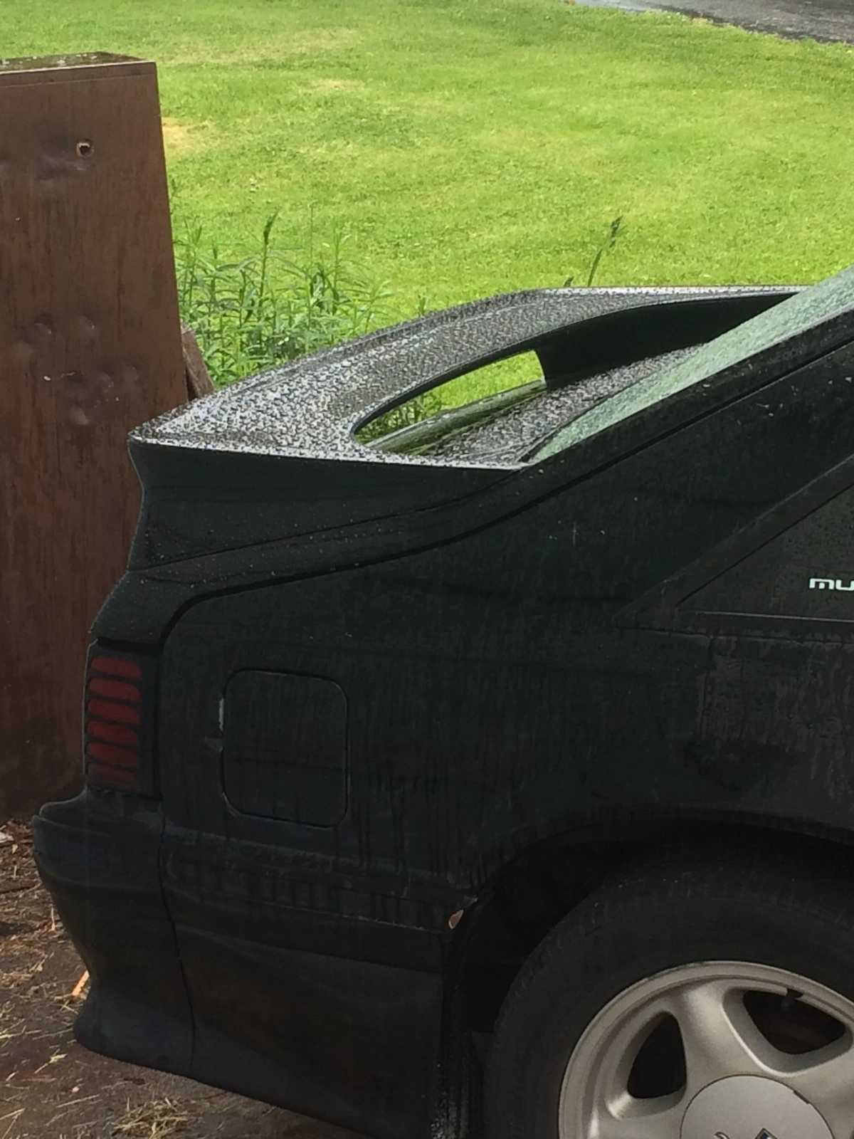

Oh have some pictures.
2014-06-25 19.58.14.webp 2014-06-30 19.07.10.webp 2014-06-30 19.07.25 HDR.webp 2014-06-30 19.07.36.webp

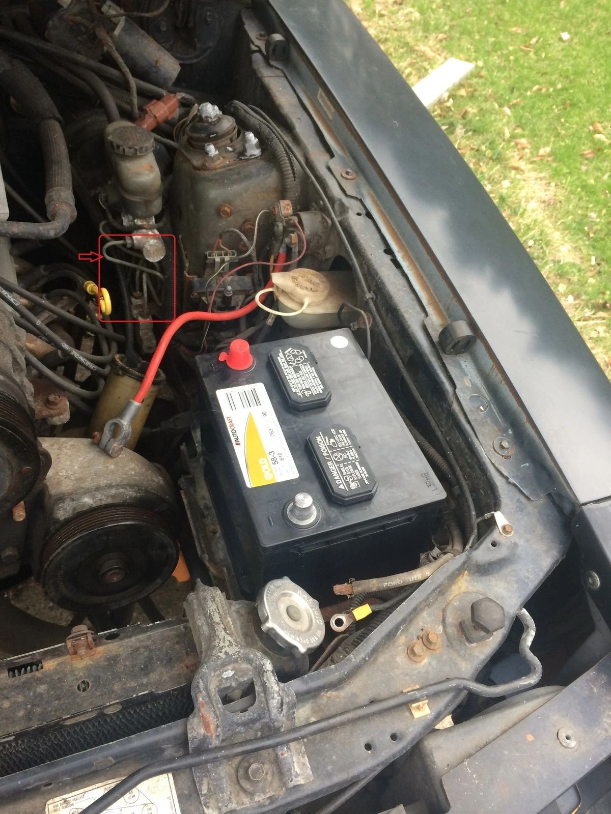

Progress has slowed down a bit unfortunately. I received the new ECT sensor and did a simple test before removing the old one and installing the new one. My thought may be unfounded but I figured it was 80* outside so the error shouldn't remain if I just plug the new sensor in and lay it outside. I still got the codes but thought maybe it was due to not being grounded or because I didn't clear the codes before trying again. I cleared the codes yesterday and plan to try again and just ensure the sensor is grounded(if it even needs to be). Am I wrong to think if the sensor reads 80* air temperature it should not throw the same codes? If it persists I may just install it and eliminate that possible fault.
I tried to get the car inspected too but the shop I have been using for the past few years gave me flak for the exhaust, my front brakes and apparently my tie-rod end was loose. I ordered a new tie-rod end and when I went to install it, I noticed the cotter pin was missing.... So I just torqued it down and viola no longer loose. Frustrating, but a welcome easy fix. I also replaced the front brakes with some shiny new factory rotors and pads. While down there I cleaned up the calipers a bit with a wire brush and gave them some high temp black paint, the rust/coloring just wasn't working for me. I forgot to take any pictures but believe me, the calipers no longer stick out which is nice, especially with the clean new rotors. Maybe next time I'll do the same to the ugly drums in the back. Now to see if I can manage an inspection with the darn cat-less mid-pipe. I sure as schnitzel can't afford a new one, with or without cats. Oh well. We will see.
Well, I replaced the ECT sensor and cleaned the female plug's contacts with some fine grit sandpaper wrapped around a small drill bit. My Code 21* is now gone but 12* showed up, hah. I took off the IAB and cleaned that up, it was quite dirty. Ran the KOER again and I am still getting that code along with my 41, 91 lean codes. I need to test the O2 sensors and wiring continuity to the computer to rule out failed O2 sensors. Hopefully the clouds will subside today so I can get under the car and check. Otherwise slow and steady.
