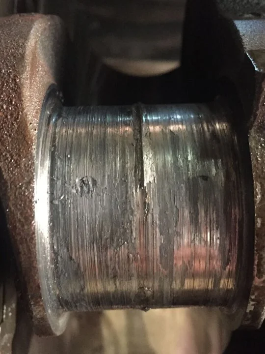

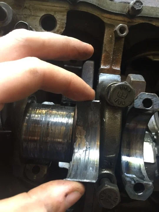

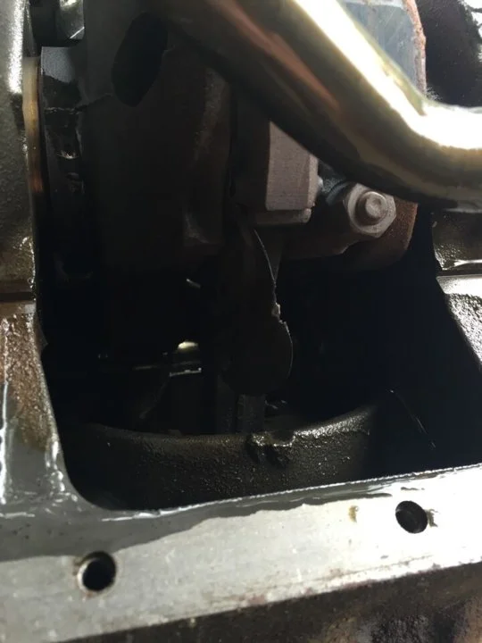

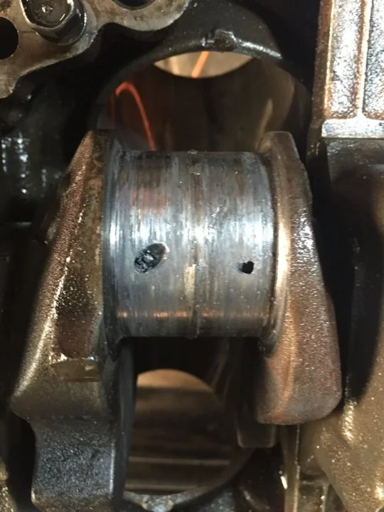

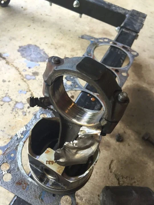

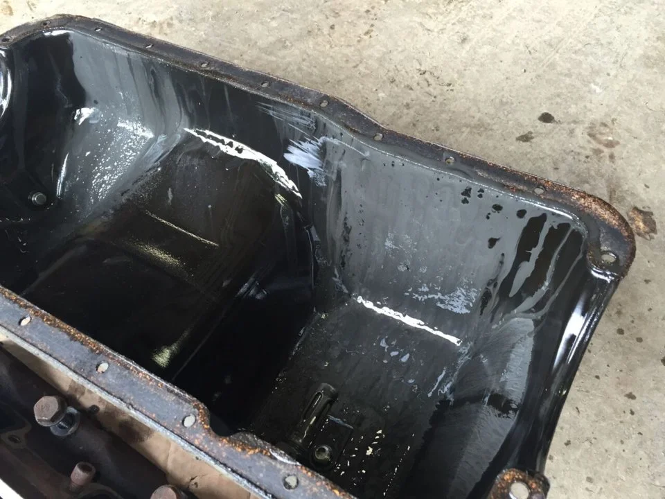

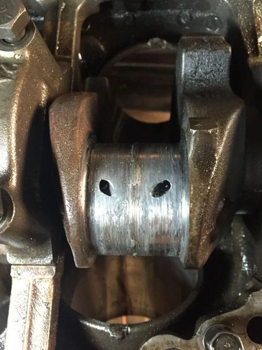

Yeaaa..... Finally got to pulling and tearing down the motor over the past few weeks. I will let the pictures do most of the talking.
Gross.
Nothing obvious, other than one side is a little 'dryer' than the other. It had been a while since it ran, maybe that is why?
WTF is that?
No, seriously...
Ugh,
That ... is just not pretty
That's what that was.
Oh and there was this,
and then,
what it should've looked like(the hole anyway)
Overall I am not absolutely sure what it was that was the initial cause of the problem. All I can tell is that journal was HOT and was getting no oil. I don't know how to tell how, why or what the underlying issue was for it not getting oil, but lack of oil certainly f*cked things up down there. Does anyone have ideas what would have been the root cause? Have any of you seen this and figured out why? I am asking questions mostly so I can decide on if I keep the block(clean it up and all) and just get all new internals or just say screw it and get a short block+. Thanks all.

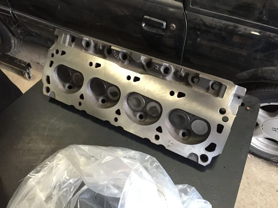

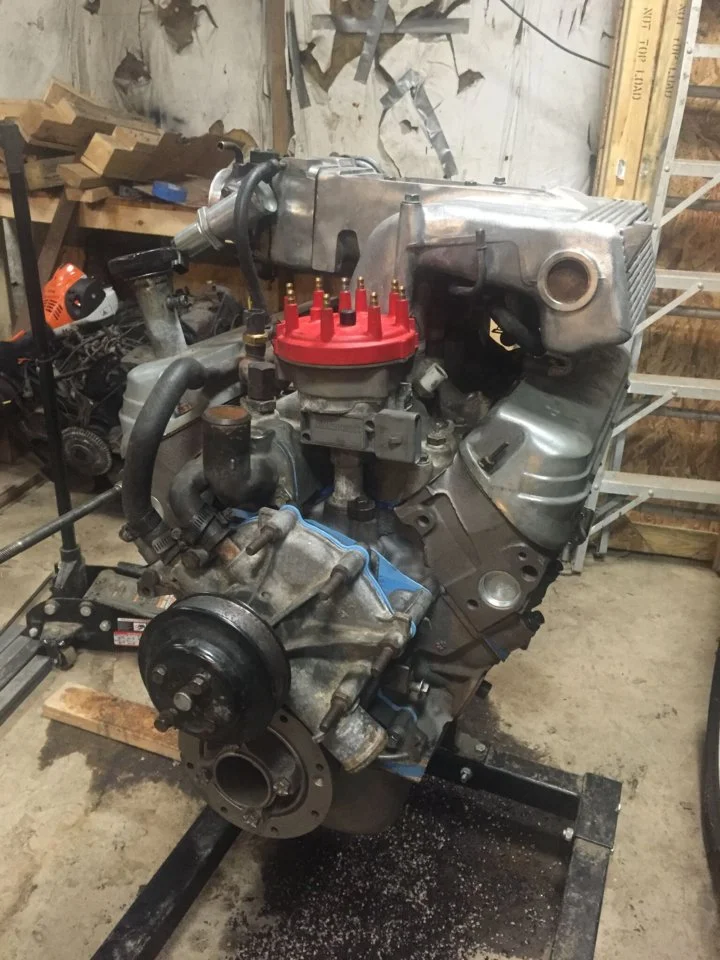

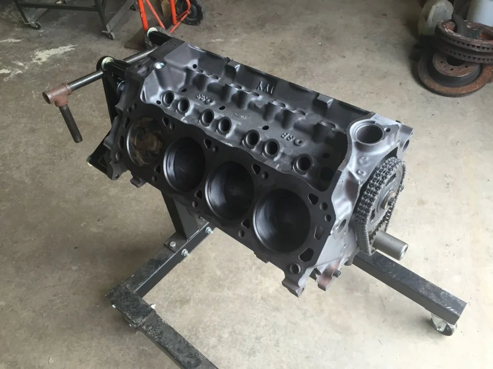

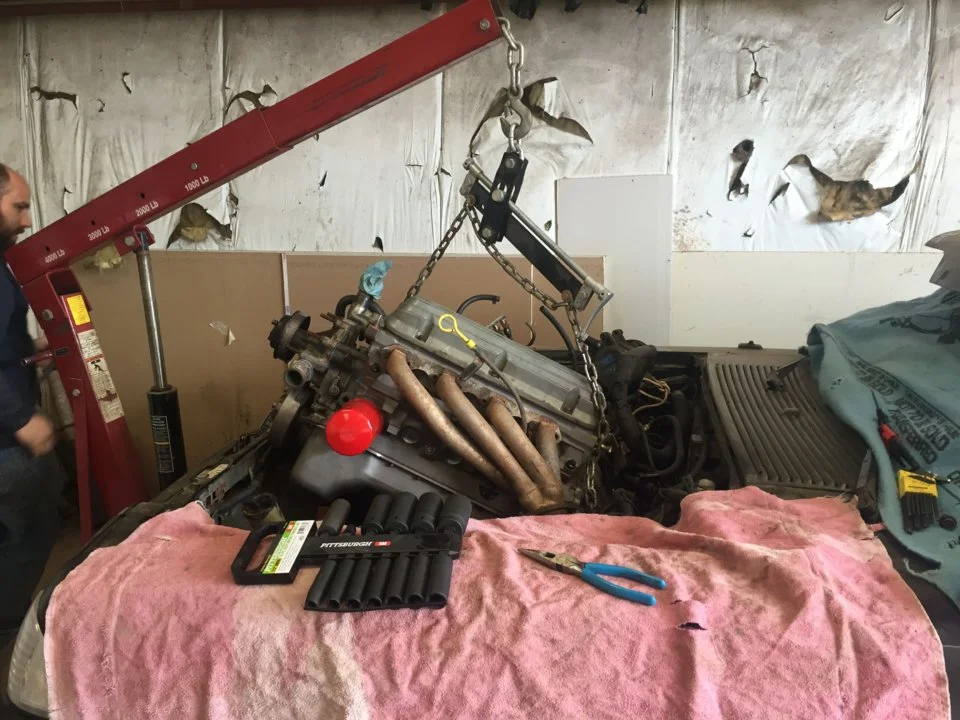

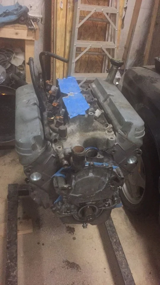

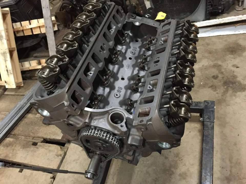

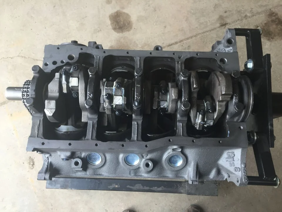

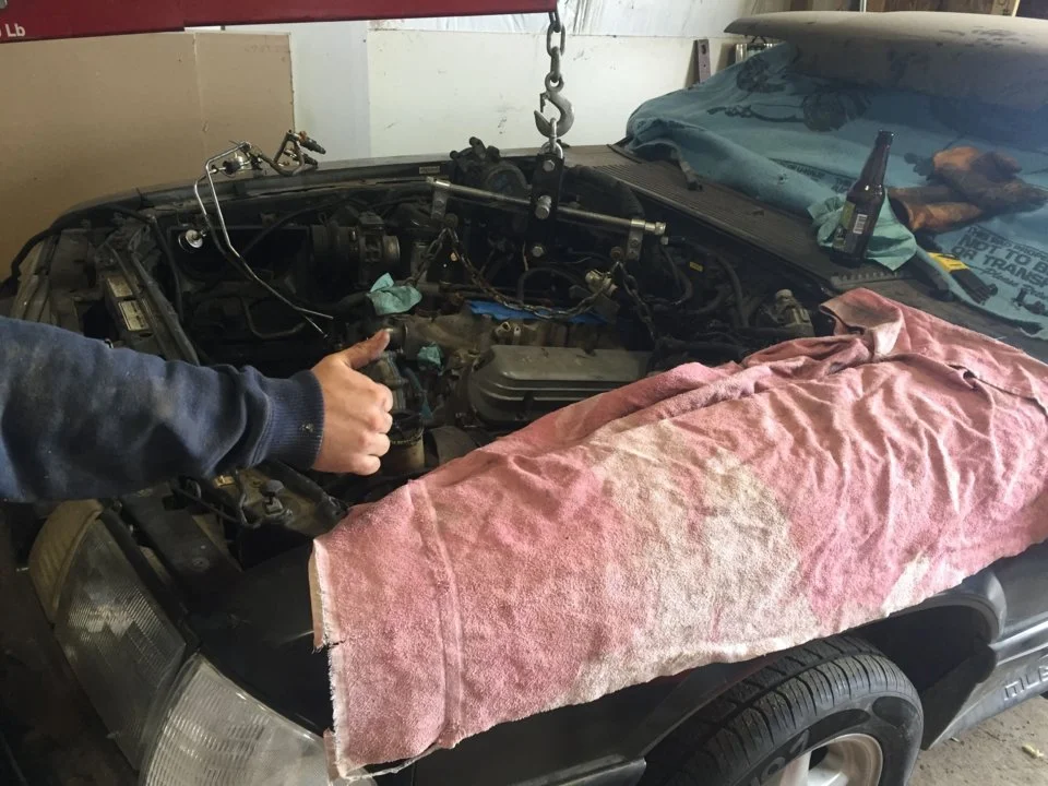

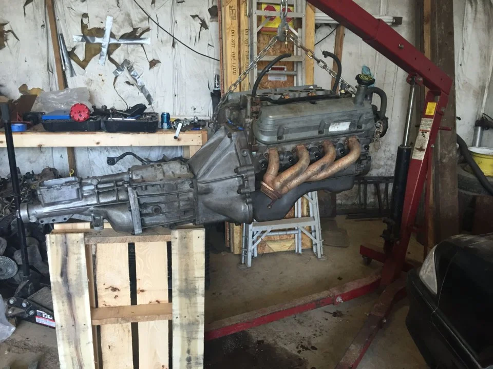

Hey all. I am still here working on the car. It has been a while since I have made any sort of update but here goes. Only just a couple months ago I had the stock motor rebuilt to OEM specs. The motor was in decent shape, sans the spun bearing that seized the engine on me that fateful day nearly a year ago. The machine shop was able to hone, clean and dye pen the block and crank without doing any major work or replace anything. I had them do the assembly of the bottom end as after this latest incident I am not comfortable in doing it myself. This time I only put together the top end. Last week I finally had time to get over to the garage and get working. I mounted the flywheel, clutch, bell-housing and T-5 to the motor and lowered that sucker in. As of now, the engine, transmission and driveshaft are all installed and torqued down. I can almost see the light at the end of the tunnel. I hope to find some hours next week or this weekend to get it ready to break in. If you read this far, even if if you haven't, here are some pics for your troubles. Thanks for reading!
Bottom end so clean sitting on the engine stand.
Shiny shaved heads
Inspecting the clean bottom
Heads torqued
Just before torquing the lower intake.
Mocked up with Intake and Distributor, I obviously didn't leave these one for dropping it it.

Almost there
In!
She is alive and sounding very healthy, considering half the exhaust is still not attached (that might make it sound better tbh). There is some loping but I am certain its due to vacuum leaks. I intend on replacing and re-running them all, they've been patchy for a while now. I have a nice sound bit but it is in .mov format. Perhaps later.
