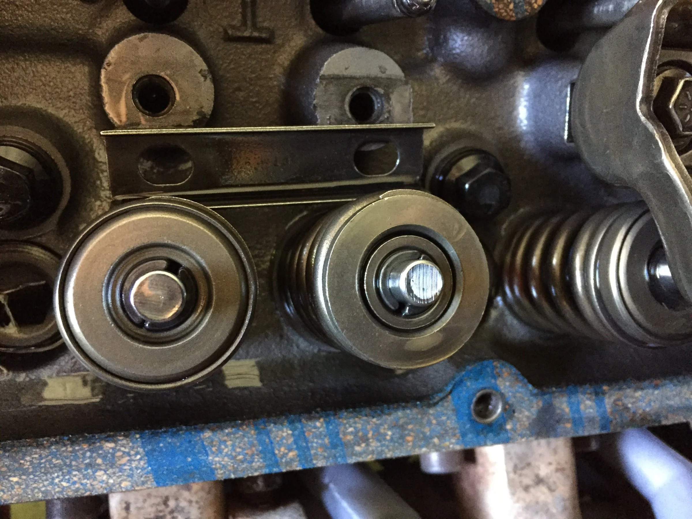

I am in the middle of checking the valve lash one more time, I am still somewhat umcomfortable about it. And I pull off the driverside valve cover and number 6 exhaust valve is loose as a goose. I pulled the rockers off to make sure it didn't get ripped out or something and the top of the valve looks a little worn. See below, I don't like it but I don't think it affected the plane of the surface. Thoughts?
The one of the right, it's obvious but I had to point it out. Ha.

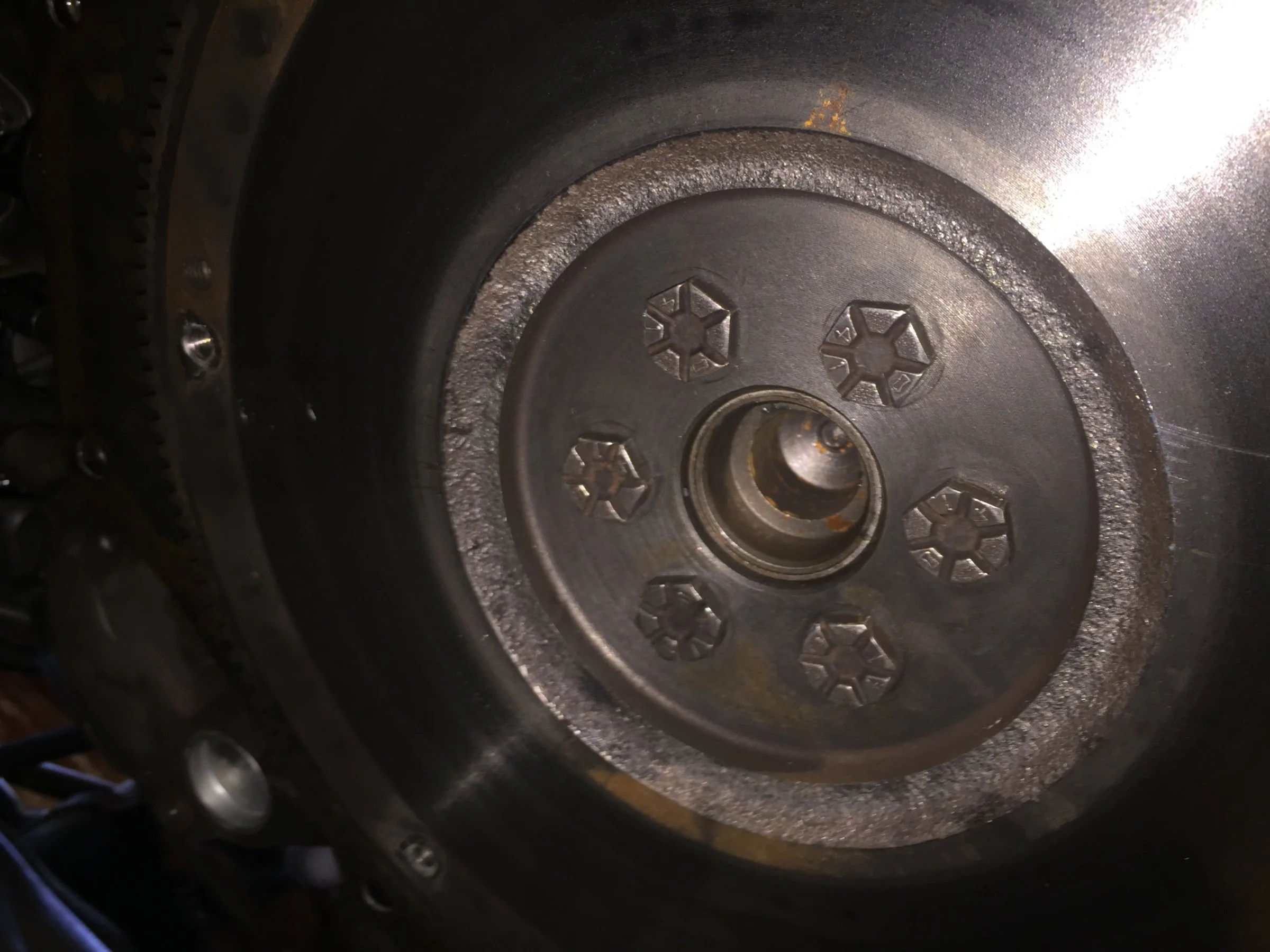

Alright then. So this is difficult to admit, but it would seem that there was never a pilot bearing installed in this crankshaft. I only decided to check because my cousin mentioned it after telling him of my symptoms. I checked some of those old pictures from right after receiving the rebuilt engine from the engine shop. There was one showing there wasn't a bearing installed then and I knew I hadn't installed one myself. I fell victim to the machine shop stating I have everything I need in the boxes they gave me, derp, user error. Hopefully I didn't ruin anything but I definitely have a strong feeling that would cause a vibration. Hopefully THE vibration.
This week I bought a replacement pilot bearing and pulled the car apart once more, once more can't hurt, right? I installed the bearing, put nearly everything back together and now I am sore as hell. The only thing left to do is get the damn transmission all the way in. I could not for the life of me get it to align perfectly, it is only half an inch from fully engaged. I used the alignment tool and I'm sure the splines are engaged just not the bearing with the end of the input shaft. I'll get to finishing it later this week.
Picture tax:
Input shaft play for reference. I don't know if that is too much or how to go about remedying it if it is too much. Just figured I would post this for now.

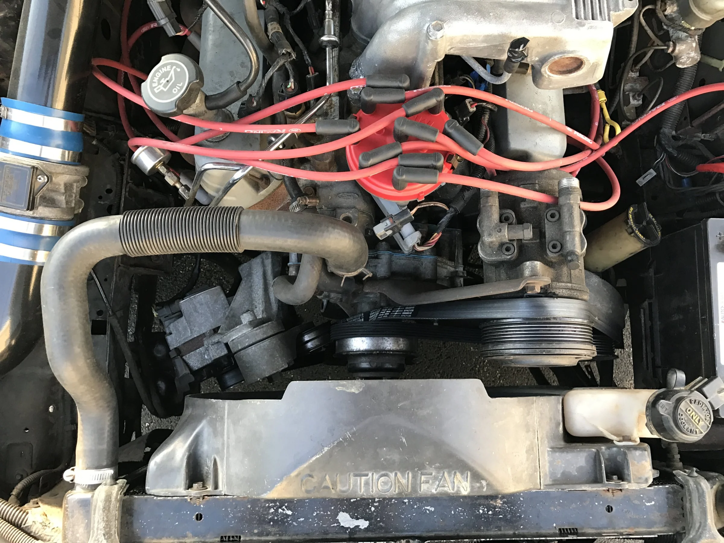

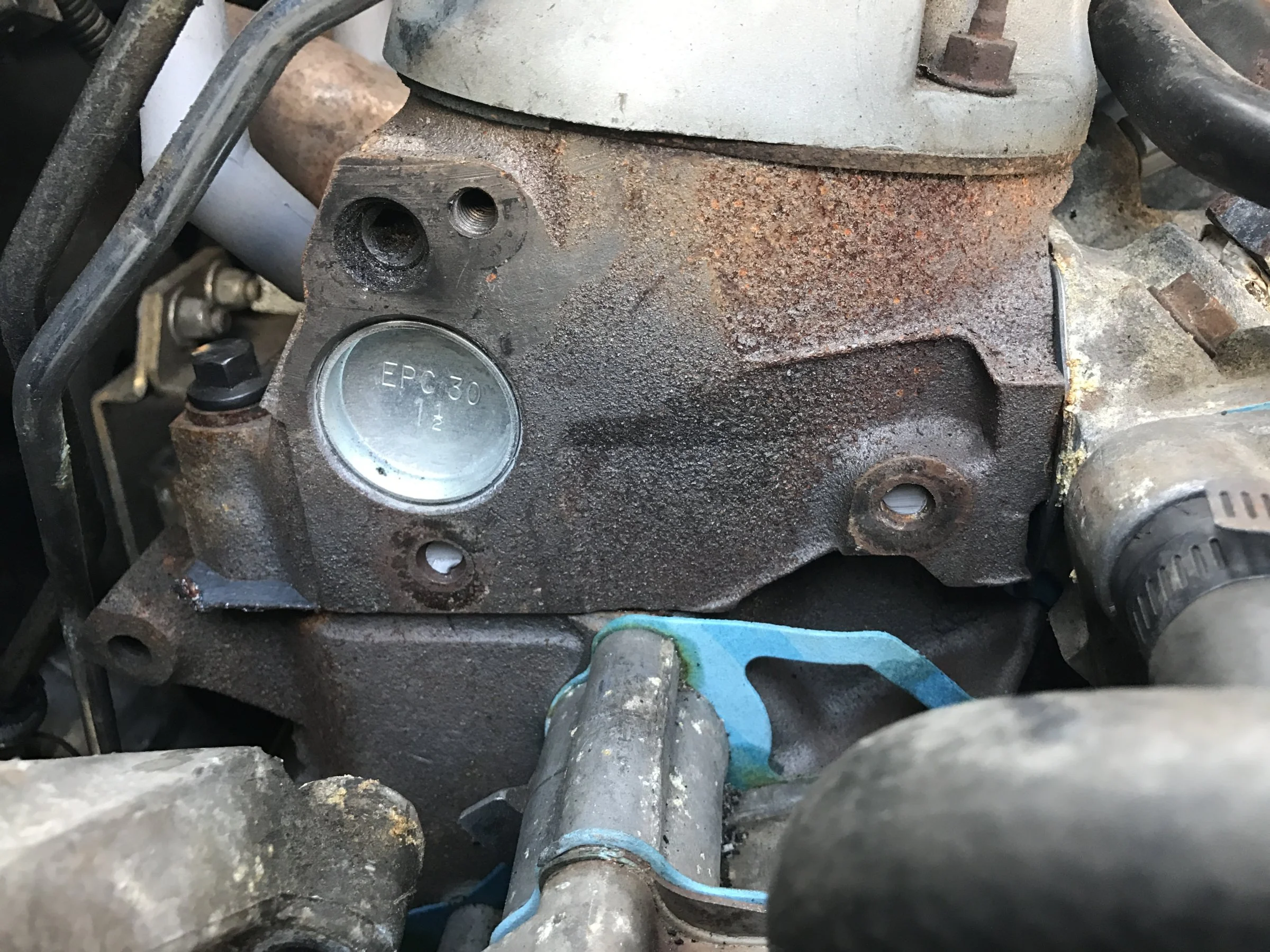

I've only had a couple hiccups so far this year. One being my throttle cable somehow popped out of the pedal lever after letting off the pedal one afternoon. The plastic clip didn't look damaged and the pedal looked fine so I popped it back in and we'll see if it stays. Then there wad this morning, the darnedest thing happened that I would never have in a million years guessed could happen. See if you can guess it before I give it away.
The only thing that gave away anything was going on was I heard a slight belt squeal drum up while on the highway. Attentive but not worried, I figured my newly replaced accessory belt was just being noisy for some reason. It stopped after 10-15 seconds. Less than a minute later my battery light lit up and I noticed the volt meter was lower than usual, around 9-10V instead of the 13+ it usually is. *:poo:*, I am in the middle of a highway where there aren't any good places to pull over, or off. So I keep my eyes on the gauges and limp my way to my job's secondary office which is 5-10 minutes away, instead of 10-15 minutes away to my main office, all while keeping and eye and ear open for anything. As soon as I pulled off the highway I noticed the power steering was out, OKAY the belt probably snapped, oh well. Then the temperature starts to rise steadily, YEA belt is definitely dead. Luckily it was only a mile off the highway and I made it without the temp hitting much more than 1 tick above center. So I open the hood to all it's glory and BAM, there's my alternator trying to jump it's way out the bottom of my engine bay. Hanging there by the tension of the belt wrapped around the tensioner and other accessories. Two of the bracket bolts sheared and dropped my alternator. Luckily it didn't find a way down and out of the engine bay for me to run over. My friend and I are guessing the top bolt backed out, maybe I didn't torque it proper(Probably)? Then the bottom two just couldn't handle the bouncy road and sheared off. Thanks for reading! Time to get this home and fixed back up. Maybe some thread locker this time too, as that was just a crazy turn of events. I am lucky there wasn't more damage.
2017-06-16 07.11.07 HDR.webp 2017-06-16 07.17.06.webp 2017-06-16 07.19.29.webp
I know exactly what happened...the big bolt that goes through the bracket must've bracket out or was missing. The hard to see one.
That bolt screwed me up before.... Bracket broke like yours. When I replaced the bracket I used a sleeve and washer on a different bolt.the original bolt has a big shank on it that fills the void in the bracket. If that bolt isn't there or if it doesn't fit properly ( sleeved...or original bolt ) it'll break.
