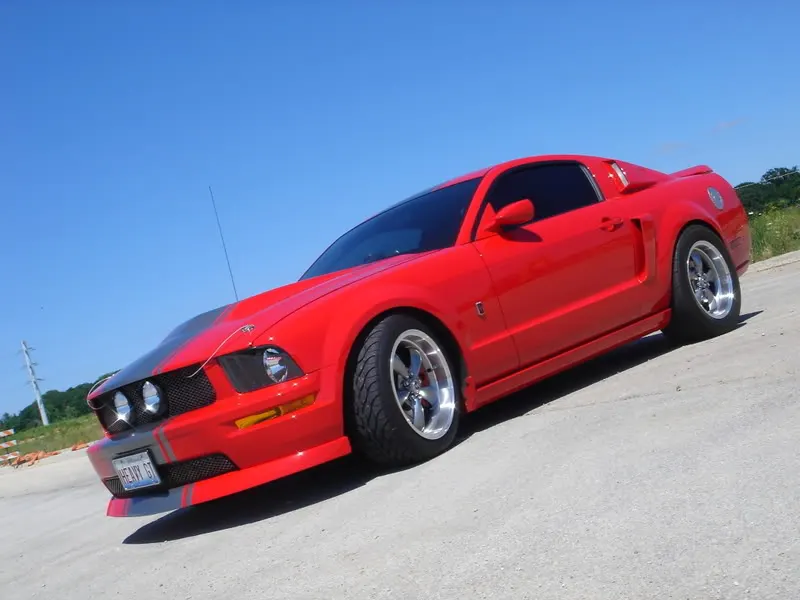

Here is where I got my 265/40-18 MTs
http://cgi.ebay.com/ebaymotors/2-26...62QQcategoryZ66476QQihZ002QQitemZ120319180616
Received them in just a couple of days in awesome shape!

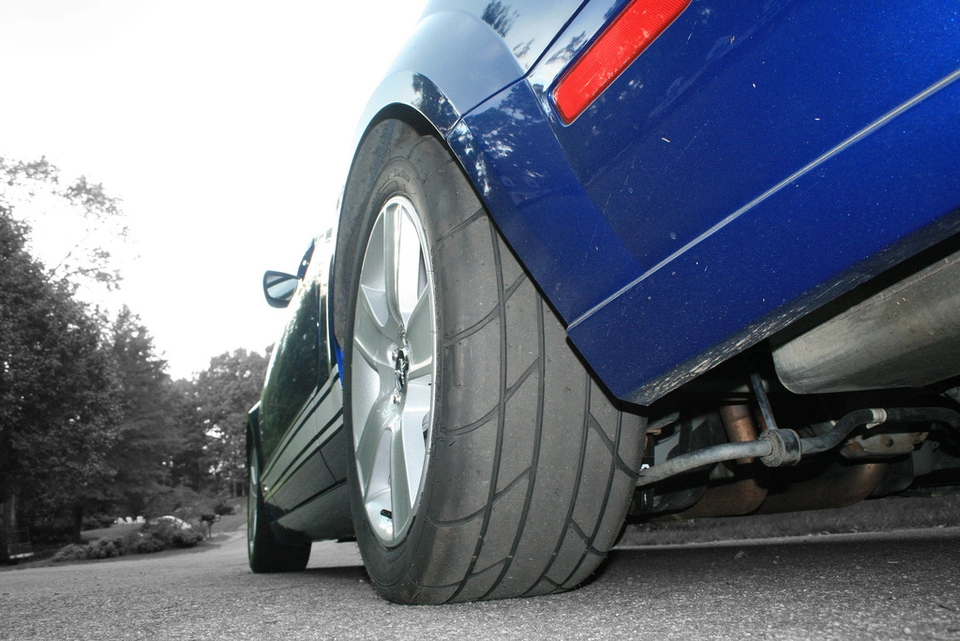

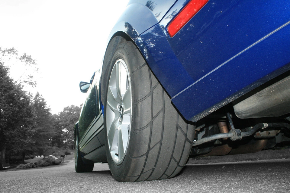

With F/I, I would lean towards a DR rather than a traditional street radial unless you plan on driving it a lot in bad weather. Also, your speedo only changes due to difference in tire rotation (revs per mile), not rim size. A 275/40-18 is barely shorter than the OEM 235/50-18 so you might not need to recalibrate, but if you have a tuner it's simple anyways.

Those look pretty bada$$ .... but how noisy are they on the highway and how do they wear? I've been looking and reading reviews on Nitto's at tirerack.com and they seem to be fine. Was seriously contemplating BFG's ... even though the reviews were good, EVERYONE was complaining about noise. Did you notice any "traction" increase..
if you dont need slicks go with the sumimoto hzlr 2 or something like that can get em for around $100 a tire.. they don't last long but they are sticky for the money and who is the girl in your avatar?? i would like to shake her dads hand?
Those look pretty bada$$ .... but how noisy are they on the highway and how do they wear? I don't hear them at all! I only had them on for a couple hundred miles before flogging them at the track for 15 passes then removed them the next day. Mileage, I don't really care about as they won't spend long on the car, but I've heard you can get 6K+ miles from them
I've been looking and reading reviews on Nitto's at tirerack.com and they seem to be fine. Was seriously contemplating BFG's ... even though the reviews were good, EVERYONE was complaining about noise. Did you notice any "traction" increase...From what I've heard/seen at the track, Nittos are ok for looks, but due to the harder rubber compound, don't hook as good, but provide 10K+ miles quite easily. When they were on the car for street use, I never really got in the gas much as they weren't heat cycled yet. Now that they've been "burned out", they should be good for next time on the street!

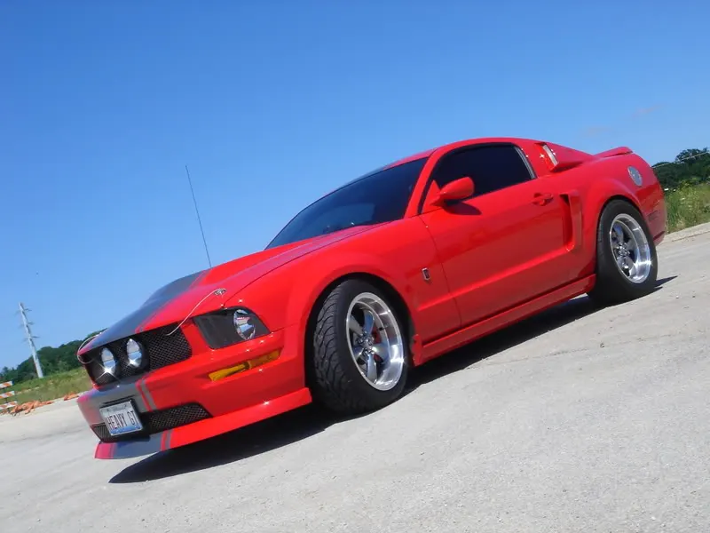

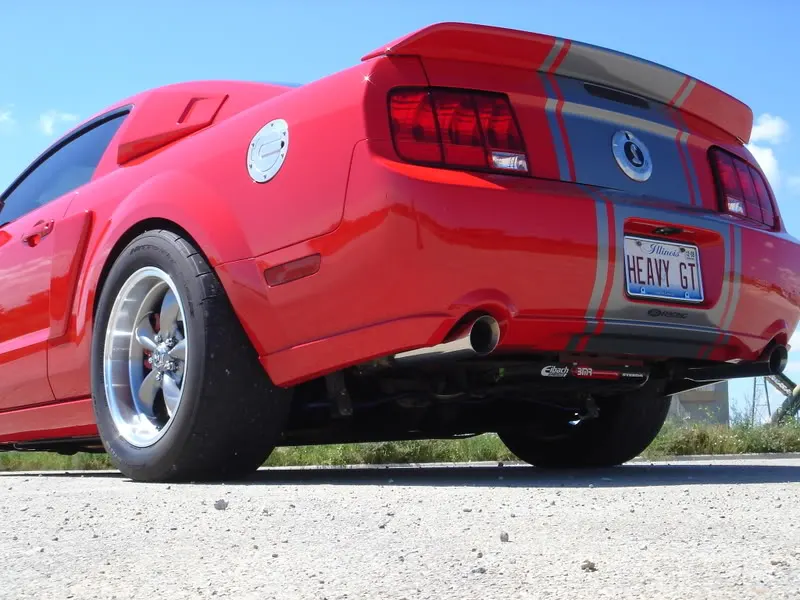

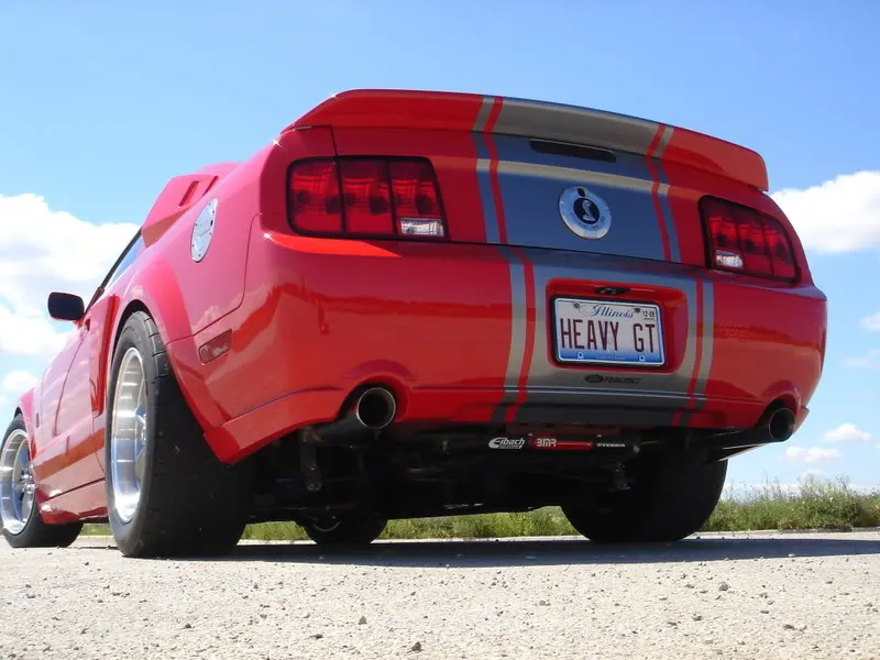

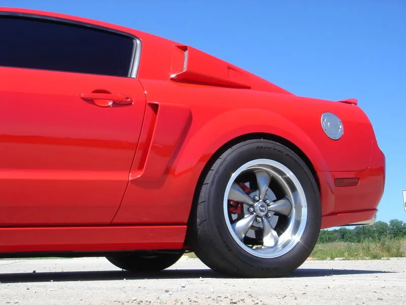

I would suggest going to a 18 X 10 rim in the rear...that's what i did...made a big difference and now I am able to run Nitto or my Mickey Thompson DRs in 305/45/18s
