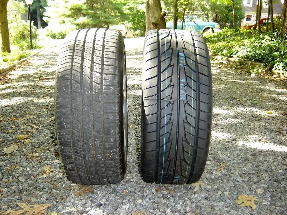

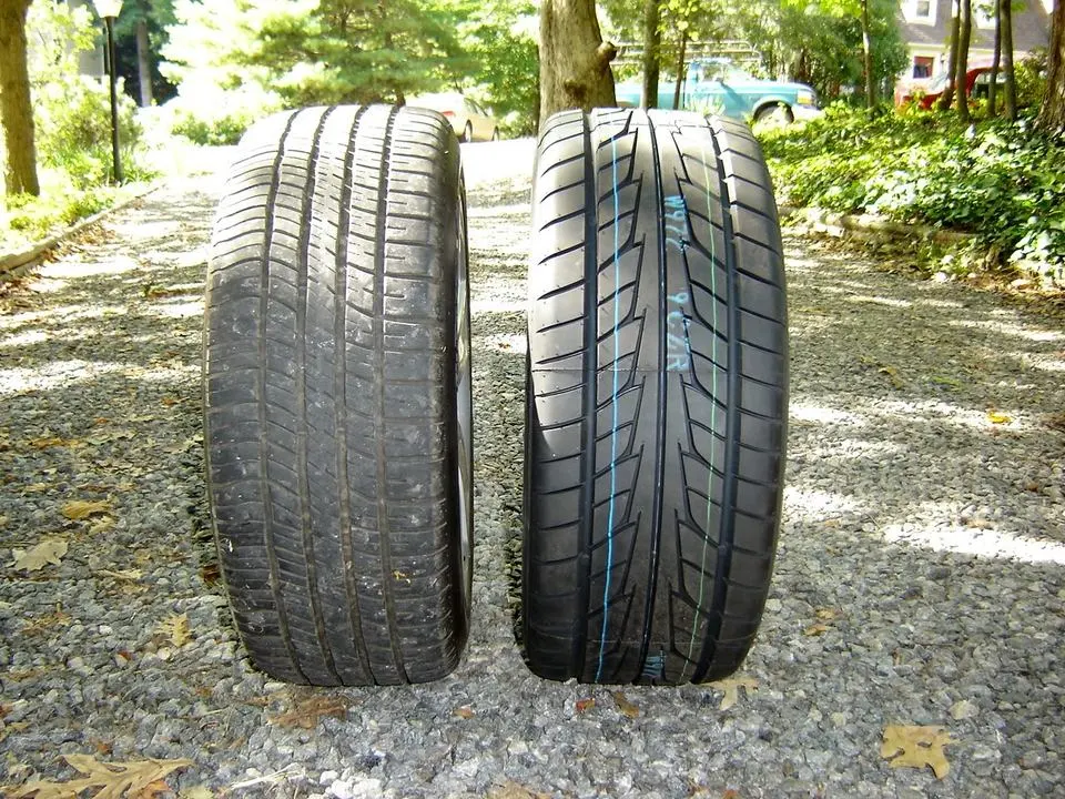

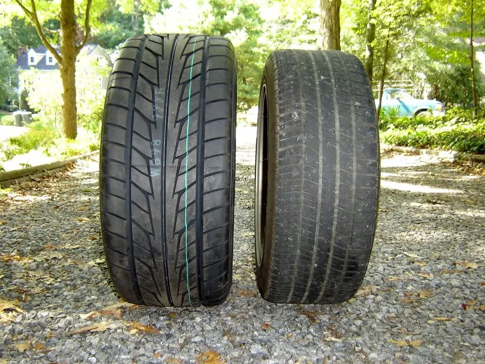

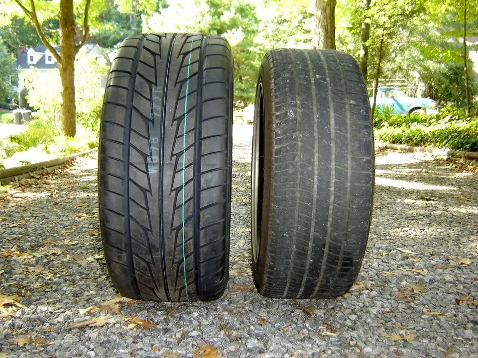

I never rotated my fan blades and still had a bit of tread left on the rear(even after several burnouts at work and 17 passes at the drag strip)and plenty on the fronts after 30K miles.
Front
Rear
What tire to put on your 18x8.5 "Fanblades"? Depends on how you use the car. Mr TireRack.com shows 255-45 as recommended, I presume that is for "normal" daily-drivers. There's a plethora of brands and performance levels available.
My case is: fun driving and one or two autocross and one or two drag racing events per month; a car pretty-well-balanced for under- and over-steer on same-size front and rear tires; no big power mods; distaste for changes in tire diameter and effects on speedometer readings.
My answer was: Bridgestone Potenza RE-01R 245-45s. 140 treadwear, top road/track compromise in the Tire Rack test, first street tire to exceed 1.0 G lateral on the Tire Rack skid pad. They are directional, so rotatabilityness is front-to-rear, without remounting them. 780 tire rpm per mile vs 768 standard, a 01.0155% difference, less than a mile per hour difference on the speed o meter.
