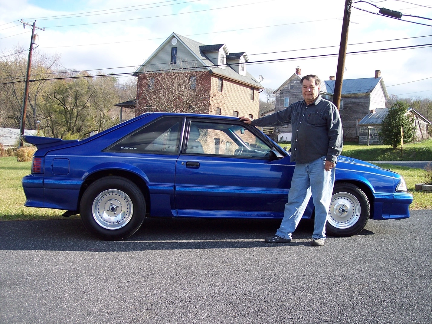

thanks Dave, I took off 245 x 45 x 17"s on 9" wide rims and with the car being lowered 2.5" they would rub the bottom of the wheel well on a big dump.
Yeah, 2.5" is a lot. To make that much work you would have to do a full mini tub. But 1.5" shouldn't be too bad though.
Remember to measure for the proper backspacing on your vehicle, once you have that, at least you know what to look for in a new wheel.
Yea, I'm going to pull these slicks and get some good street / strip tires (any suggestions) then deal with the wheel well issue, maybe drop the rear down some with a little redoing of my spring spacer.
But these slicks look soooooo kool!

Hey, thanks for chiming in. The 4 lug setup is fine and the rear disc brakes have to be much better with this t bird setup and I already have the 410 gears ?? It would be nice to be able to just go to a tire store and try every wheel and tire comb till you find that "just" right one but such is not the case. I really like these wheels and I think with a little smaller tire on the back I can adjust the ride height to fit and still look kool. don't think rolling the wheel well is a good option since the rear is extra wide ? and I do not want to take the chance with new paint. I think I can kind a tire that will give me good traction and ride. NO LOW PROFILE TIRES FOR ME.

That 2" lowering is the killer with the extra width in the rear. I'm not going to get new tires till after Christmas but I think I'm going with a 245 60 15 maybe a 255 if it fits good.
