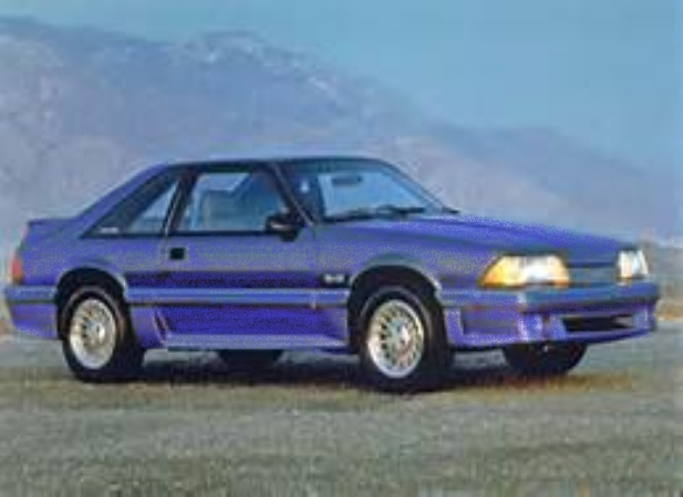

Nice looking car Mike but if that rear end suspension isn't stiff as a board "they are going to rub".
Here is the way it really looked in the 80's, plenty of room there.
If my car were sitting at the original height, tires size wouldn't be an issue.
The rear end is sitting close to stock height now.
But when I get some time I think I will take an 1" back out, I just took a shot with the 1.5" bracket.
