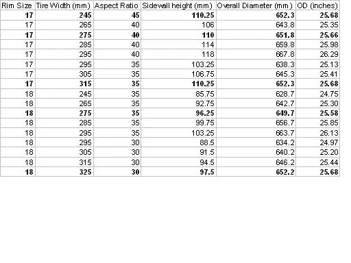

Just calculate it out. Width * Aspect Ratio /100
Dammit. I did it for you.
Good luck finding 4 tires for less than 800 bucks!:(

are you sure the sidewall on the front wont be taller than the rear

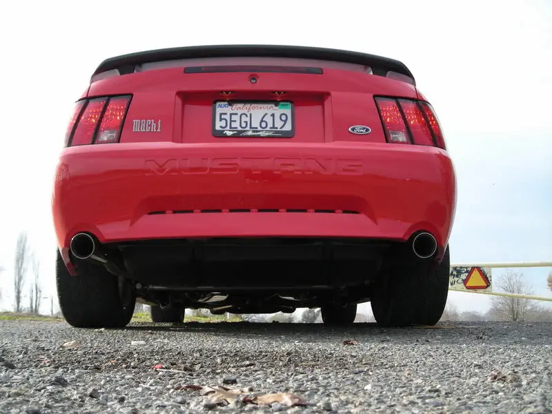

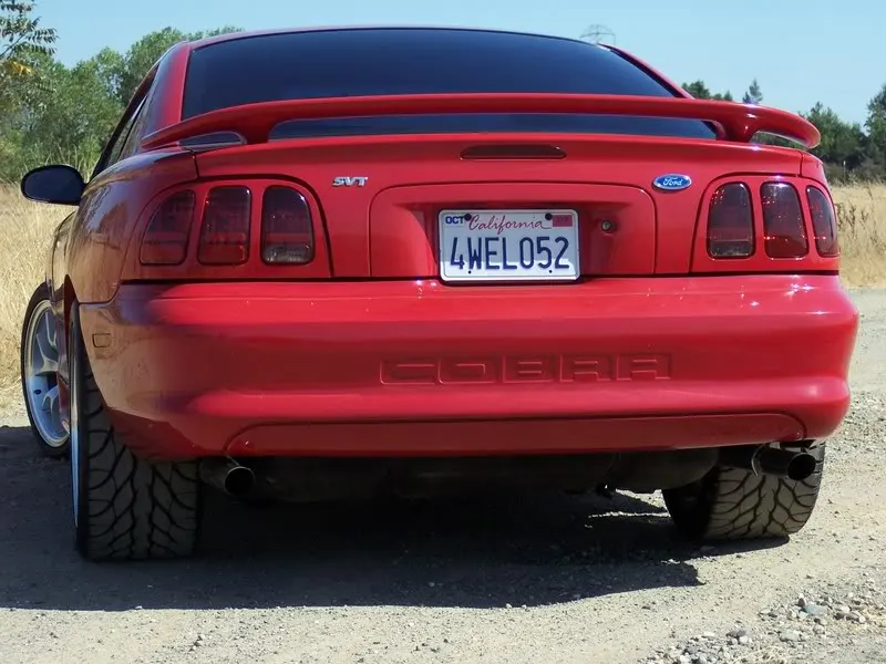

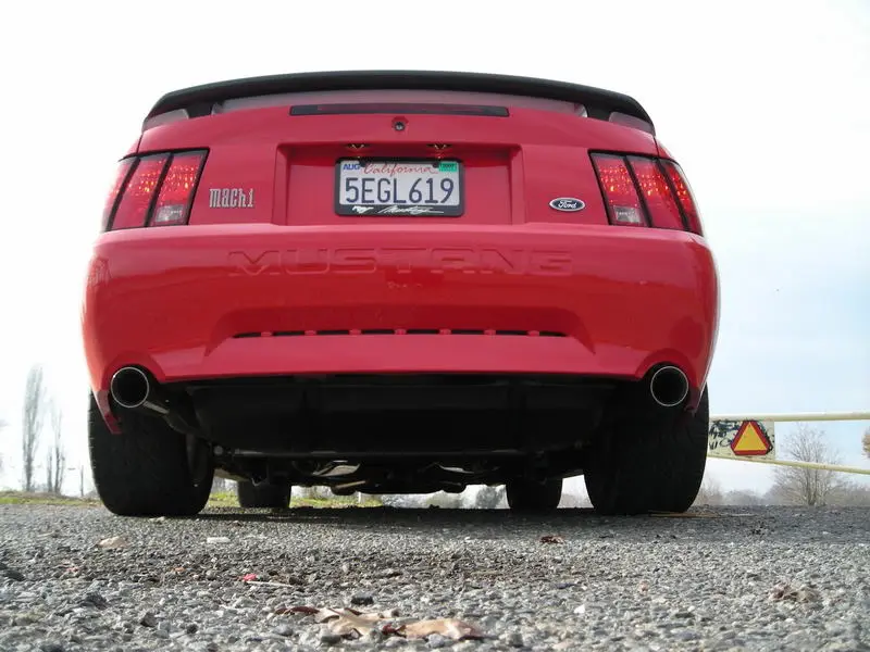

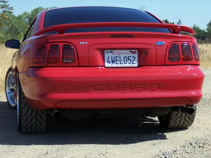

I dont think so. Look at all the Stangs in the magazines with 315's. All there cars have 30's on the rear & usually 35's in the front. Am I right? If it bothers you that much, just get 295/35 in the Back. There stiil pretty damn wide, cheaper, & easier to find. Plus your tread pattern will match front & rear. Only reason I want 315's is for looks & to say "I got 315's". 295's have more than enough grip, especially on a near stock stang. I got some pics to show u how wide 295's are. Not the sidewall, but it shows u they are still plenty wide
This is how wide 295's will look. thats my old 97 Cobra
Here is a crappy pic of the same thing on my Mach 1

Ok When I multiply this out....305/35/18 and 255/35/18 I'm getting a rear sidewall of 106.75 and a front sidewall of 89.25. If that is the case, I'm sold on these Nitto's.
http://www.discounttiredirect.com/d...cf=false&sw=false&cs=305&pc=40231&rd=18&ar=35
http://www.discounttiredirect.com/d...cf=false&sw=false&cs=255&pc=40148&rd=18&ar=35
and when I multiply this out...315/30/18 and 255/35/18 I'm getting a rear sidewall of 94.5 and a front sidewall of 89.25. So which pair do you guys prefer? The 305 Nitto's ^^? Or these??
