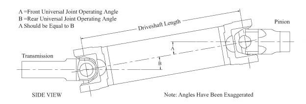

Here is some more info on drivline angle and vibrations.
Operating Angle
Operating angles in a driveshaft are the angles between the pinion, driveshaft and transmission centerlines. The optimal angle for any driveshaft to run at is 0 degrees, where many vibrational and frictional problems are non-existent. In order to minimize power loss and vibration in an offset configuration, the pinion centerline and the transmission centerline need to be parallel. In general, the largest angle for racing applications should be 2 degrees and the centerlines should be parallel within 1/2 degree. If the centerlines are off too far, the u-joints travel at different speeds causing vibration (this is the same problem induced by poorly phased end yokes). This vibration is hard to distinguish from an unbalanced driveshaft.
