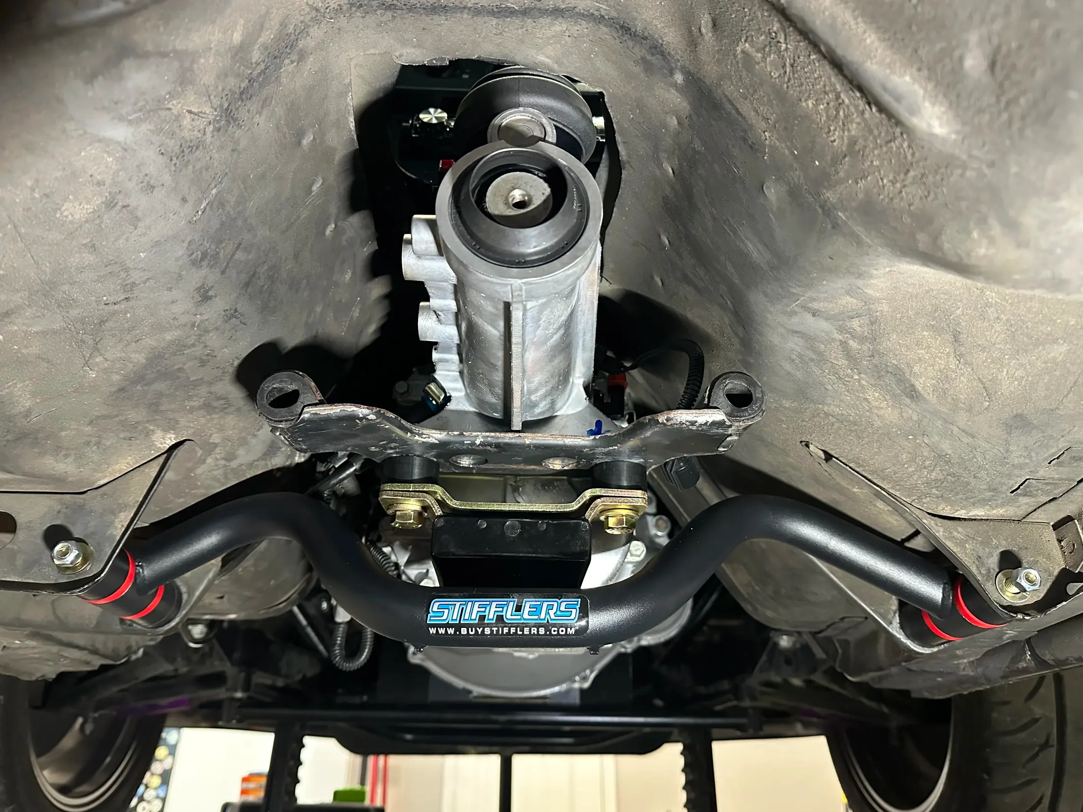

From my install thread:
I am running stock motor mounts and a Prothane trans mount which is about the only differences. To me it looks like our shifters are sitting at the same height.

thanks for checking! hard to tell from the pic but thats reassuring!

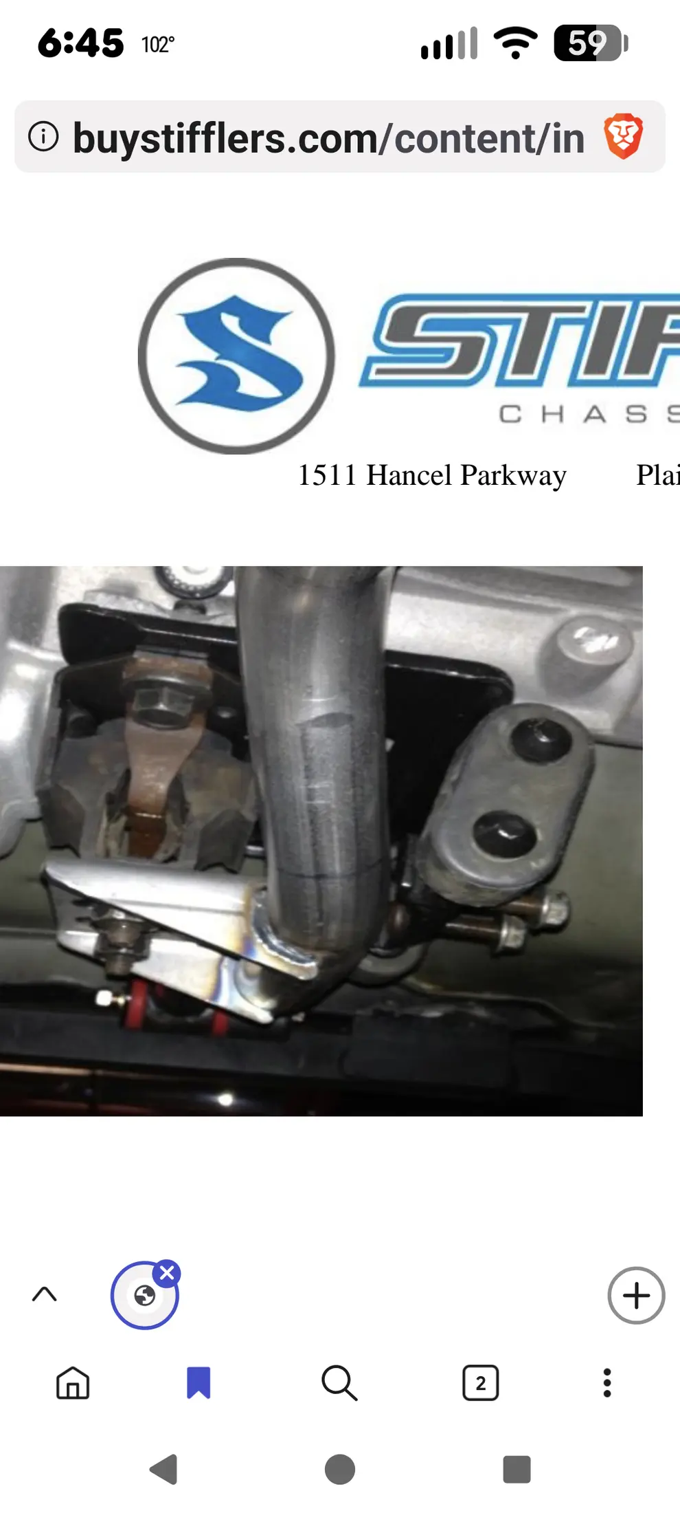

Stifflers SN directions show a pic with exhaust hanger plate installed.

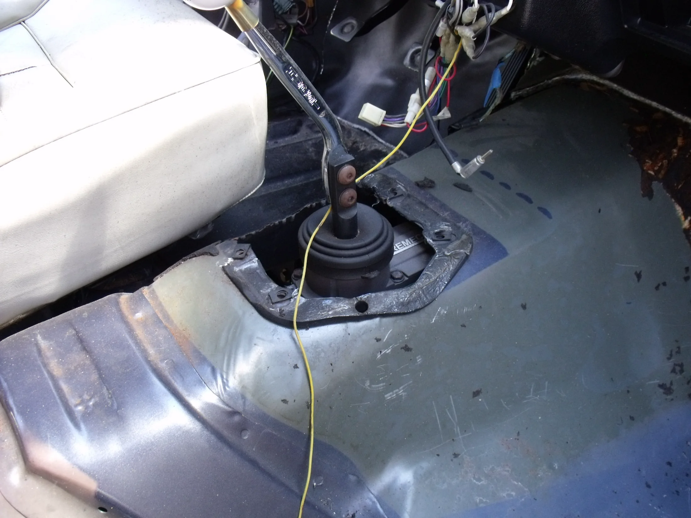

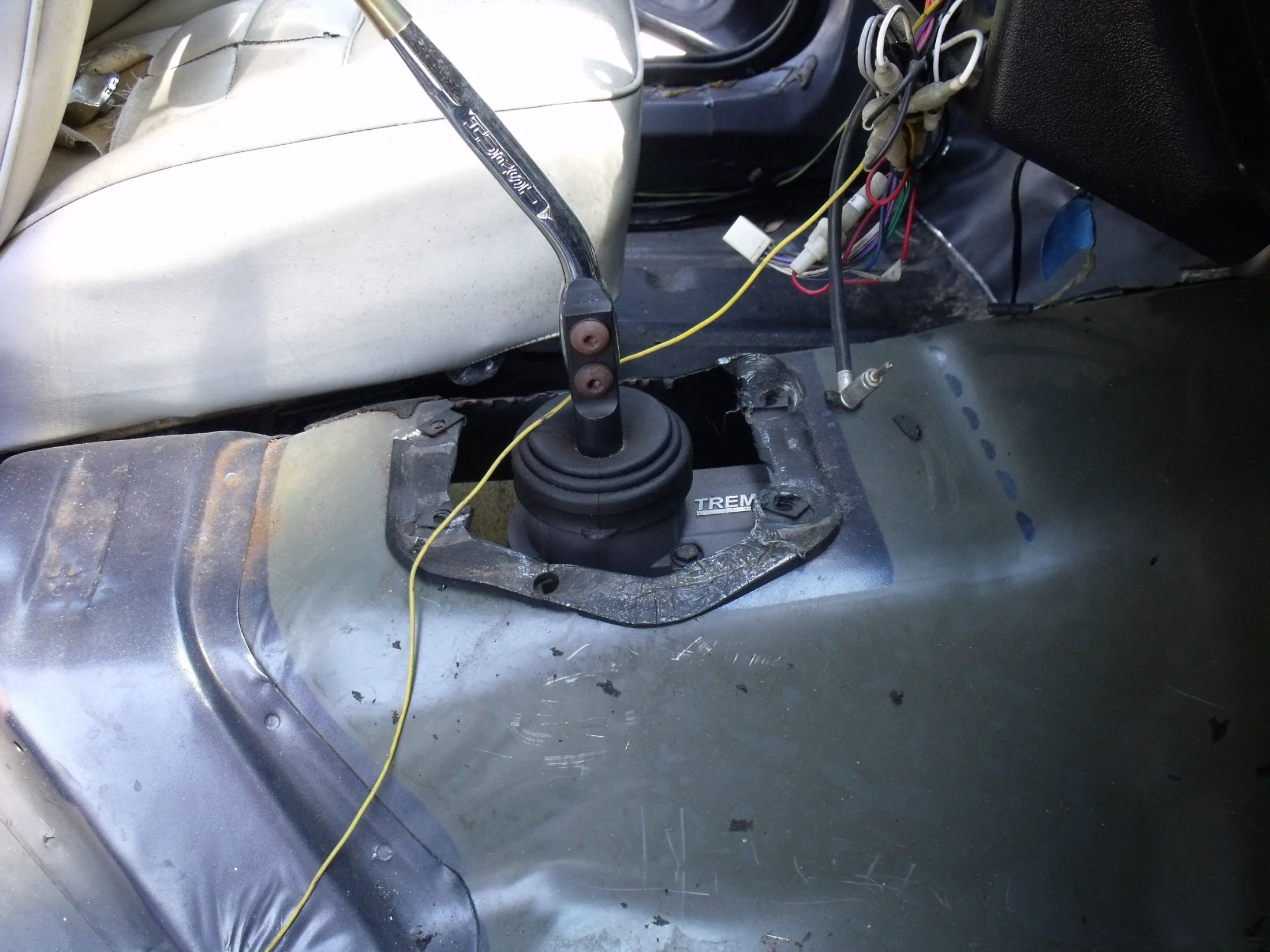

Two pics from my 83 car with the TKX installed on a Stifflers Crossmember using the two large plastic spacers recommended.... Hope this helps
