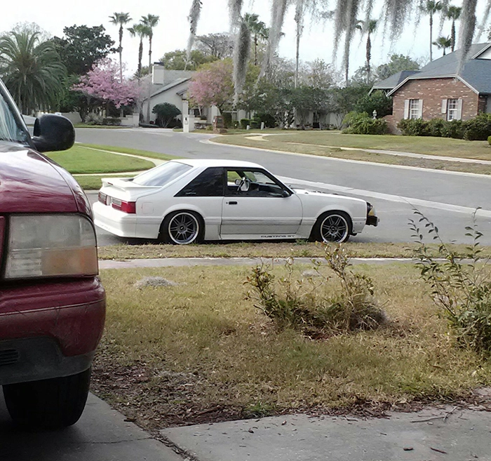

All you guys get is a bad picture for now. The rear is not set in its final spot. I have a lot of messing around to do with where exactly I want the LCA, shock, and which spring I want to use, but this is temporary get it functional on the road for a show this saturday. I've also now got the issue of the front being higher than the rear...

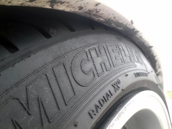

Definitely going to need to be rolled! But barely any rubbing on my rock hard springs.
even rolled you might have an issue in turns I had to raise my car up because I once hit a small bump in a turn and the rolled lip cut big chunks out of my side wall. Make sure you have Upper adj control arms and get the axel centered best you can. if your bushings are worn replace them.

Wuzzup with your front bumper cover? Also I would jack the rear up a bit to keep the QP from cutting in to the tire until you get it rolled.
Yea that is when I first dropped it down i am running it a little higher now until I get it rolled which should be tomorrow. I am putting a Saleen front end on it so I am waiting for it to get painted.
