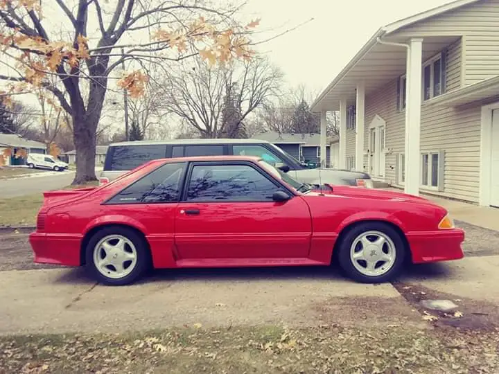

I have a 1991 GT and want to do the top end. Does a set of AFR 165's or 185's with a F-303 cam and an Edelbrock Performer RPM II intake seem like a combination that would work well together ? Eventually would like to add a Procharger down the road. Would like to keep it in pump gas as it will be mostly street driven.
