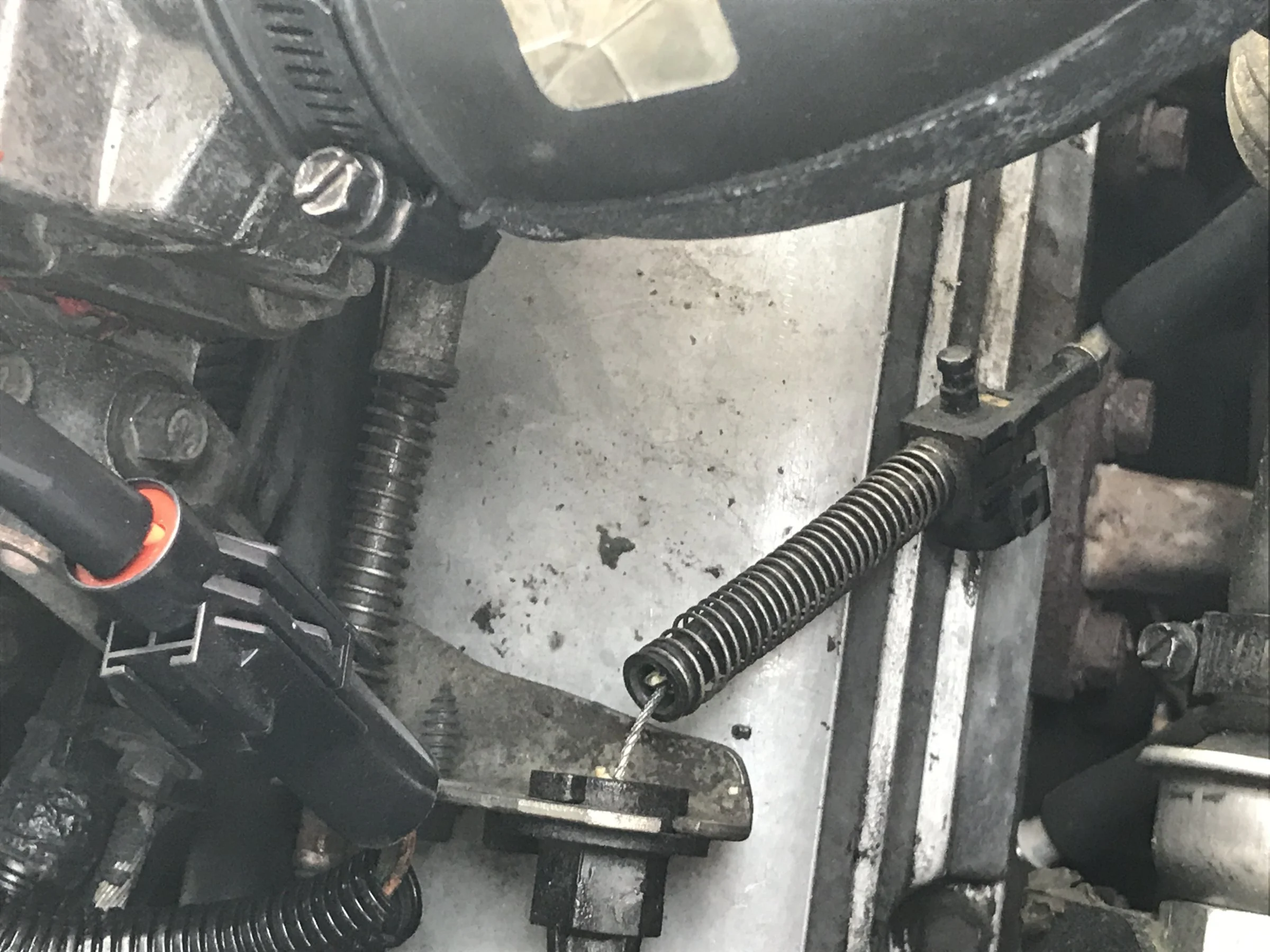

Well guys, I bought some Lucas additive but have yet to add it. I think I found one of the culprits , like you guys said the throttle valve cable holder broke off so it has been dangling for some time I imagine. I spoke to my old transmission teacher today and he believes it may also be the band.

Got some bad news for you,, If you;ve done any amount of driving with the TV cable disconnected, chances are the AOD is damaged. These transmssions operate off of line pressure and the TV cable is used instead of the traditional vacuum modulator. I've seen AOD's fried within miles of driving with an incorrect or broken TV cable.
Do not drive the car until you fix that, and I would recommend replacing the plastic bushing with a brass one. The plastic ones are prone to breaking, causing the TV cable to fall out.
Regarding adjustment, I strongly encourage you to bring the car to a transmission shop unless you can adjust the line pressure accurately. To get the setting in the ballpark, you can follow this video.
