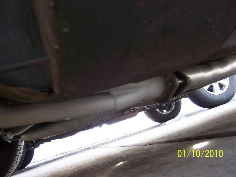

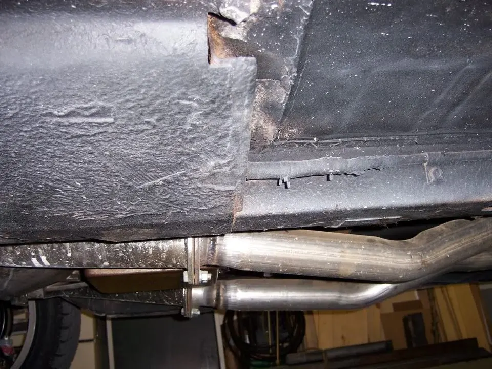

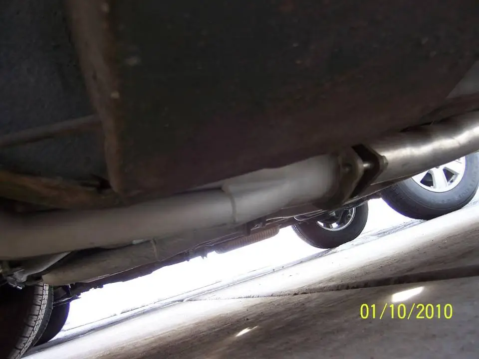

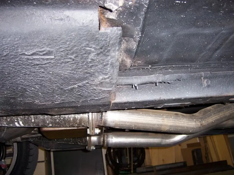

Have you looked at the Mac long tubes? I have them on my 67, no ground clearance issues and no issues with the clutch cable (my T5 is from a 94 so the cable is lower, but it looks like they would work even better with the fox cable location).
I recall reading about problems with Tri-Y headers in general, with regard to Mustang Steve's clutch cable setup. Though I don't recall seeing anything specific to the Doug's version, you might try searching Steve's FYI Ford forum. The late-model bellhousing determines where the cable must pass, so even if your cable conversion is from another source, the info should all be pretty accurate.
it is some sort of thermal coating, but it is rough, it pretty much matches the color and texture of a cast aluminum intake. yeah my car is lowered about 1.5"
Like i say, they work with well my 94 T5, and look like they would work perfect with the fox T5s as well, but donno. If you are running stock PS they are swept back further than most headers so they clear the power ram without modification.

Gikort, nice ride - thanks for the pictures. The Macs really do have good ground clearance and sounds like the clutch cable clearance is not an issue either. OK, time to call Mustangs Unlimited. Thanks!
gikort, did you use the Mac H-pipe that MU sells as well? I'm considering a magnaflow 15816 exhaust system (with integrated x-pipe), I suppose I'd need to weld on a ball collector to the magnaflow system so I could bolt up the macs.
Zookeeper, you certainly ARE low. Do you have a t5? Clutch cable?
Sure, I'll try to get some pics off my camera tomorrow. I know I have some, but it's a bit past my bedtime right now. Just as a bit of reference, they tuck up quite nicely and are about the same as the front sub-frame rails. My car has been together about 3 years and the headers have only dragged once and even then it was on a high speed bump and the scrape was minor. Usually the pan on the C4 trans drug first.
