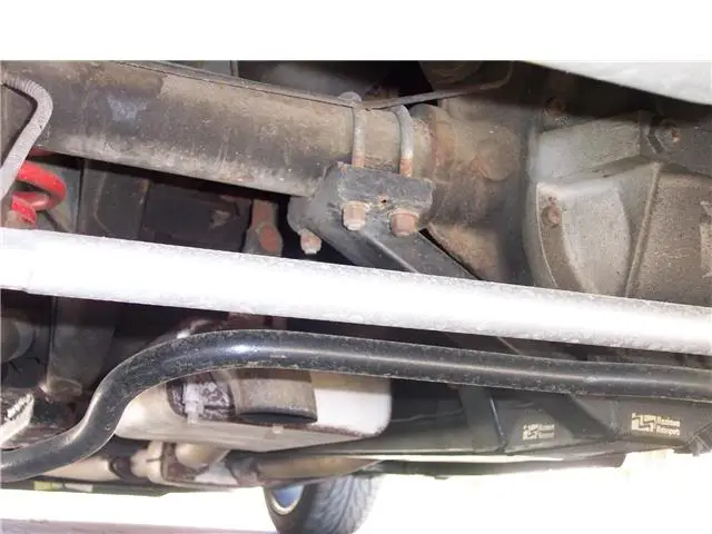

I'm not running it on a 99+....but I have lots of MM gear on my 92 LX and it handles like a dream.
MM torque arm
MM LCA's
Front/Rear strut tower brace
sway bar, front rear.
Panhard bar
Full length SFC
no UCA's.
For the money, I think MM is hard to beat. I'm not sure I've ever seen a comparison between products like you're asking...no true lap time comparisons or anything.
Good luck, nothing like a corner carver! :D
Here's a pic of my rear....again its not a 4.6 but MM products are solid IMO. Take it for what its worth.
