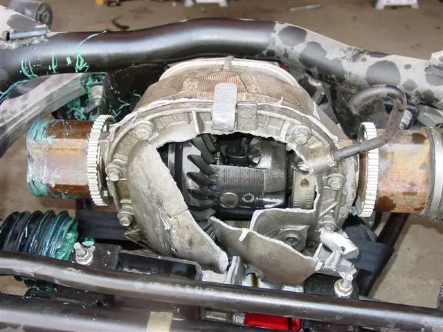

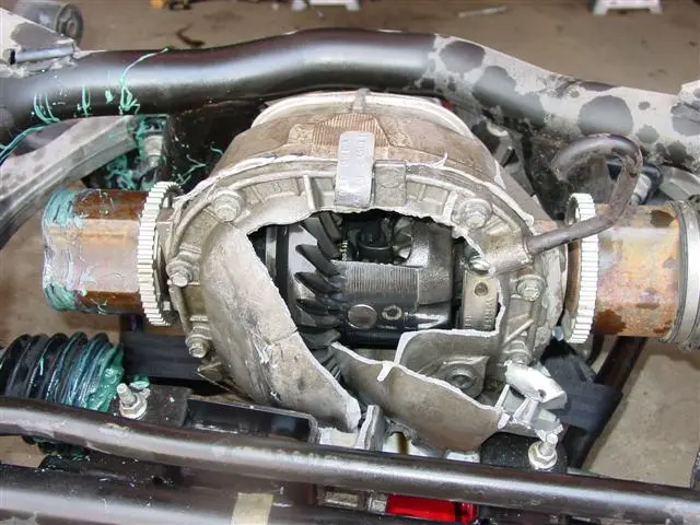

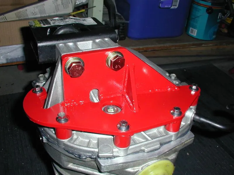

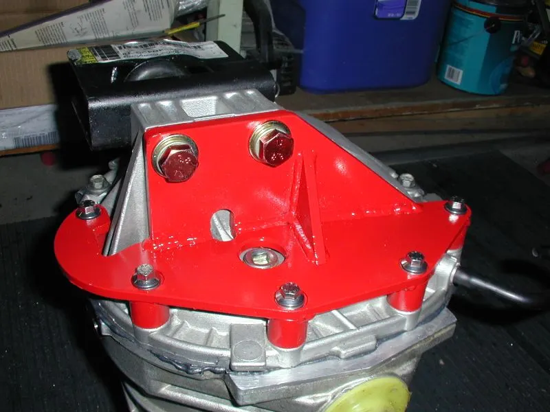

Replacing the rear seal on the pumpkin is a pain in the butt, but it can be done by a shade tree mechanic. It's not difficult, just time consuming because the IRS has just a few more parts you have to deal with before the cover on the center section can be removed. Wait until you try to install those bushings! :rlaugh: :rlaugh: :rlaugh:
Those will make the center section look like a piece of cake! I highly suggest once you replace the gasket sealer on the center section cover (there is no "gasket") you also add one of these: http://www.billetflow.com/irs_brace.htm
This will prevent that leak from happening again and will also strengthen your rear differential so this won't happen:

Yes, U.M. I planned to install the Billetflow IRS brace as well. I plan to tear into the rear end next week some time after christmas. I plan to do all the rear end mods (brace, bushings, sealer, and possibly the IRS brackets as well) all at the same time.
