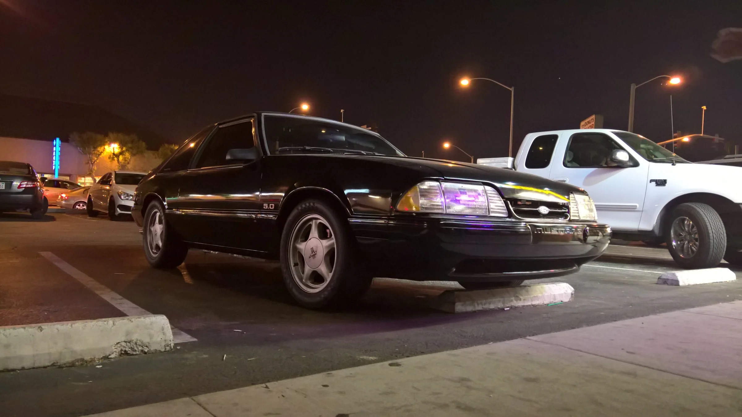

Literally just completely smooth as if there was never a door handle...
Without a doubt, finding two nice condition unmolested doors will be by far the easiest route.
Now, something to check, take off the inner panel and look where the original handle was. You probably will see the concave recess where the handle was originally. If this is the case, then you'll need to remove the plate they welded over the recess to "smooth" the outer door panel. This can be done without too much damage to the door, but you'll need to be careful cutting out the patch. Be sure to grind all of the paint off the area of the patch so you can see what needs to be done.
If the PO cut the original recess out and welded in a flat spot patch. I wouldn't even try to fix it myself. You can get replacement doors relatively cheap. Take your time searching for a set that is in nice condition.
