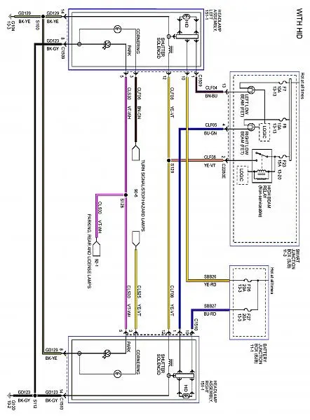

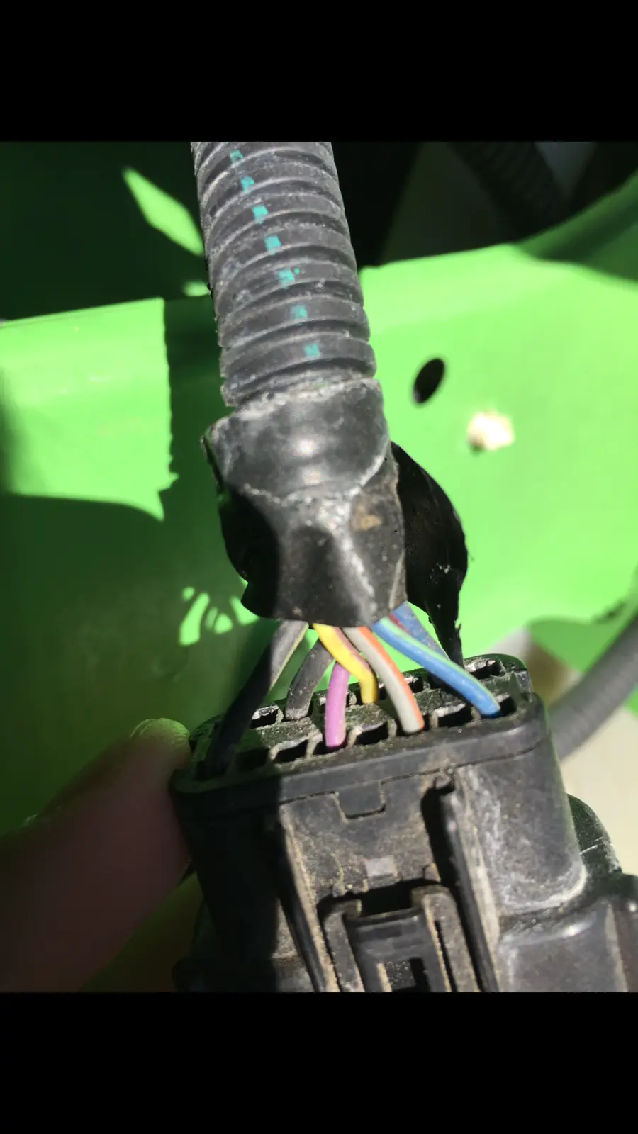

Hi, I currently am in the process of installing diode dynamics drl boards and demon eyes. But for the demon eyes it recommends installing the cut off wire to the low beam wire. I have looked everywhere on line and can’t find out from anyone what color the low beam wire is and where it is located.
Any advice or help is greatly appreciated
