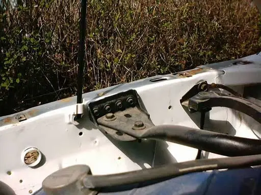

But I'm still not sure how the t-top braces look...
Are this the braces that are called t-top braces:
Or is it more something like the "torque boxes" on a early stang?
Greetings,
Bernardo
Hello,
thanks from my side too for this helpfull info.
I will order subframe connectors.
Greetings,
Bernardo
Yes, those are the T-top braces. Torque boxes in earlier Mustangs are an integral part of the body.

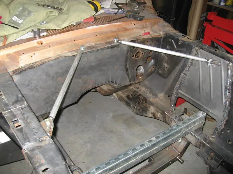

On the early stangs the "export brace" is something similar to the t-top brace. They also strengthen the car a lot, but they attach directly to the shock towers (which are missing on the MII).
I just have seen a thread about a 67 coupe, with removed shock towers and installed MII front suspension. He had a high increase of torsional stiffness (from measurement) with something similar to the t-top braces (Link):
I think i will also build something custom for my 74 hatchback.
