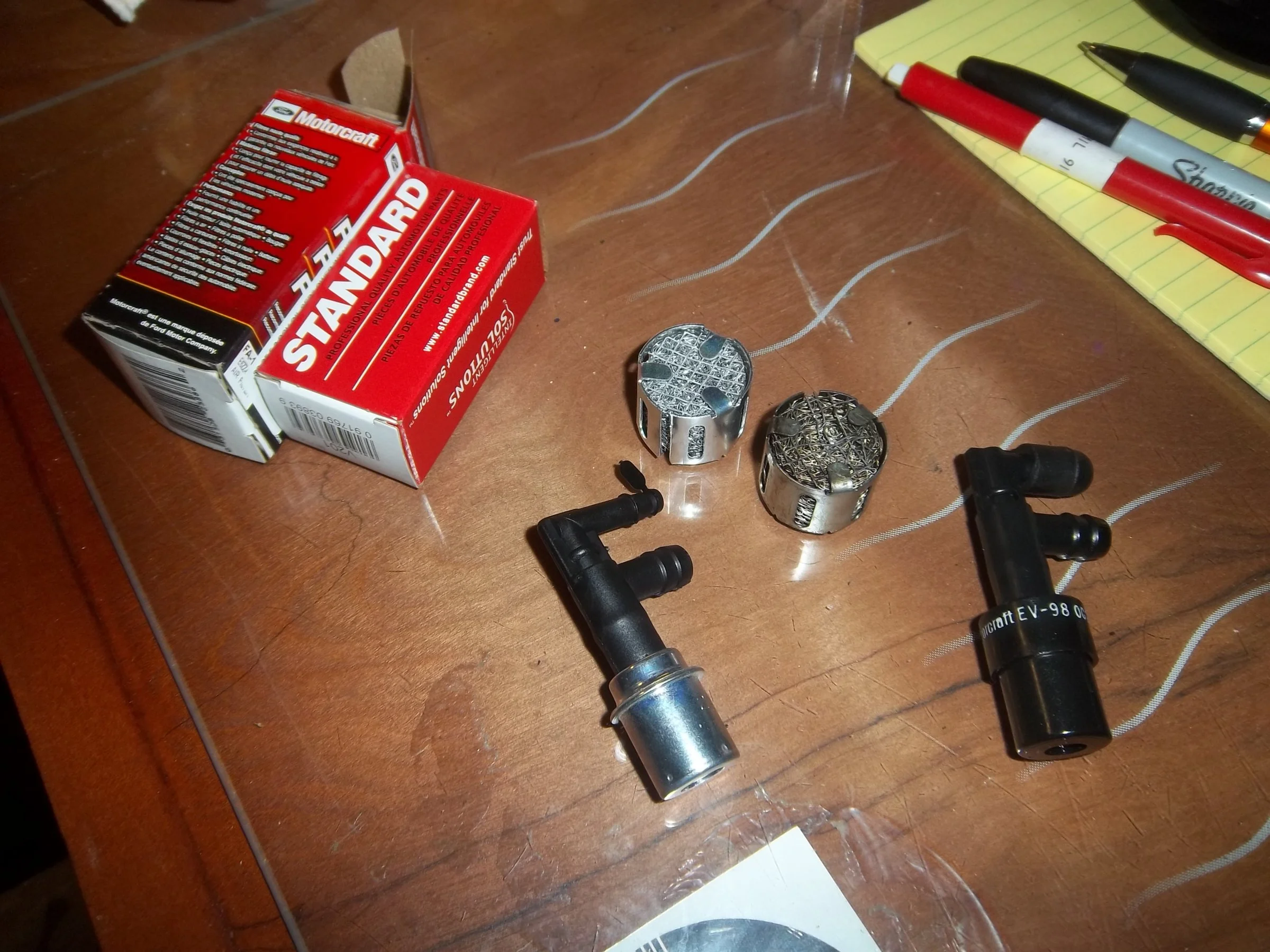

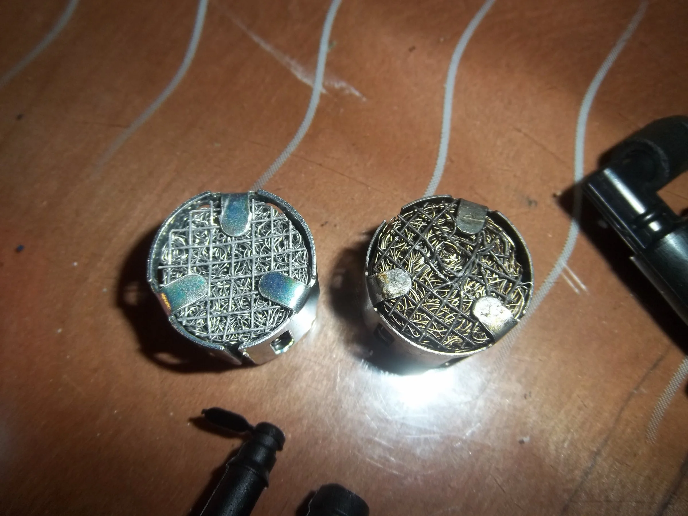

While your at it.Take a look at the PVC valve & wire screen under it.Old dirty one on Rt.(even after soaking overnight) And, New replacement on left.
