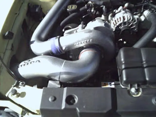

Here's a pic of my Steeda pipe.

I like them both. Sweet!
