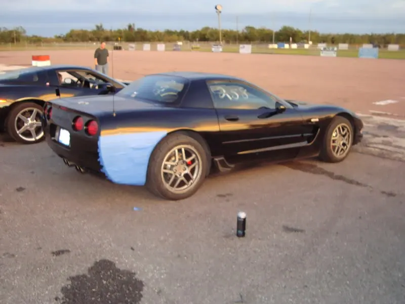

Should have gone 11.70's tonight with the great air. First pass, bamb! :rlaugh: I was going to to do the rear end anyways, so now I have a good excuse!

B, thanks for the input. After having a few Jack D's on the rocks tonight, I jacked the car up. There was no oil/fluid. I did not oil down the track either.
I did have a spec 3 installed last week. The car has been chattering, shaking a bit when there is not enough throttle. Normal for the c5 spec 3. However, 1st, 2nd, and 3rd gear is not there. I tried to get the car to move. It will not move forward, but reverse does move a tiny bit. It doesn't catch like it should, but the car will inch backwards in reverse. So, I am against my first impressions of cracking the rear end, or breaking an outshaft/half shaft. As you mentioned, the car hit real hard. I am used to cutting high 1.7's to low 1.8's. My 18 inch drag radials at my power level, should be good for low to mid 1.6's with good track prep. As I texted Maddox(D98gt) this would have been a 1.6 60ft and a mid-high 11 second pass if I hit my shifts.
I'm thinking it has to be the tranny, or the gear in the rear end broke off, and the teeth are just catching in reverse??????? Does this make sense.

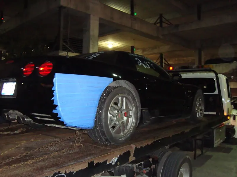

Damn that sucks,but like you said,good time to upgrade.Anypics of the carnage?
No Pics yet. I just ordered a stage 2 RPM completely built rear end. Comes with stronger c6 z06 right and left output shafts, and beefed up internals. It should be here in 2 weeks. I am also getting rid of 18 inch Drag Radials. They are just too hard on an IRS car because of the lack of sidewall.
