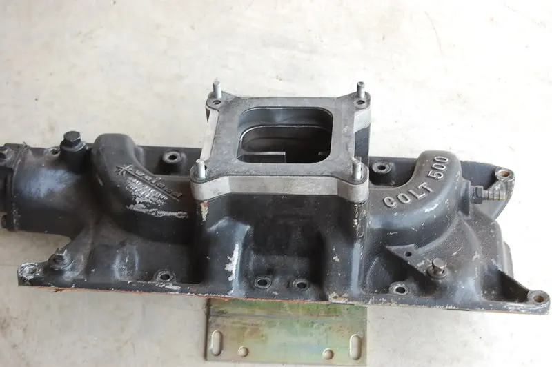

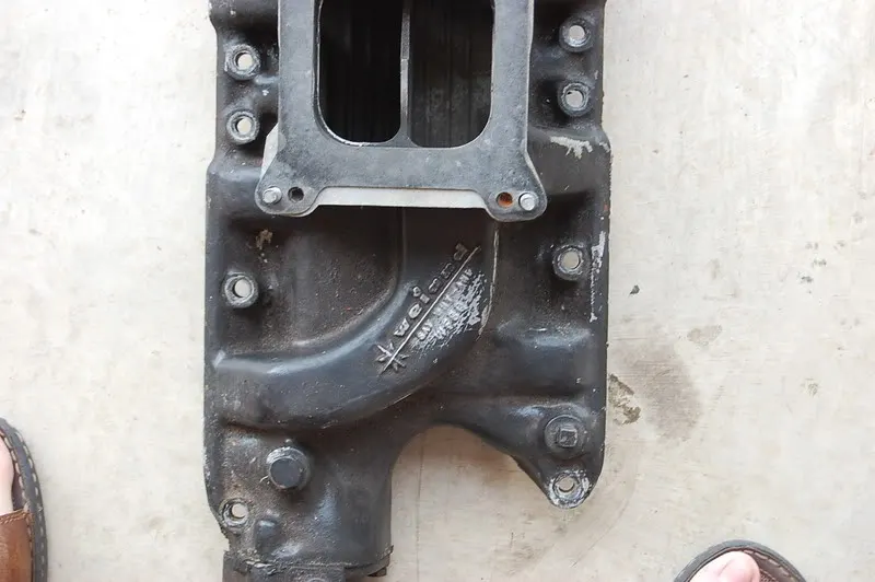

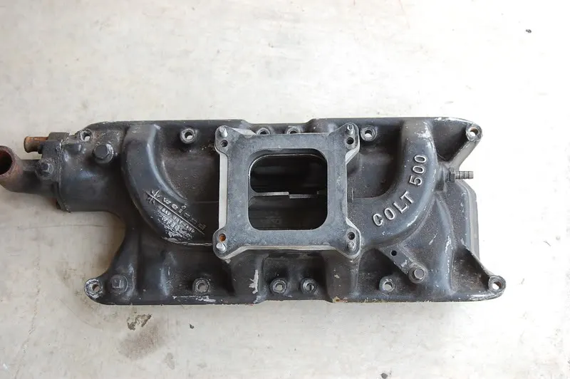

I found a guy in my area that has one of these intakes that he'll sell me for $50. Any of you guys have information on this intake? I have a 5.0 engine I plan on putting it on. From what I hear it is comparable to the Edelbrock Performer.
Got some pics from the guy

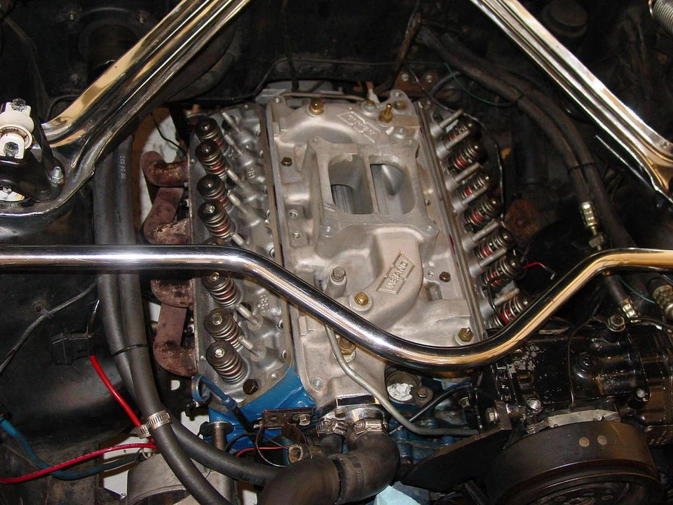

there are two versions of the Weiand Stealth. one is like ours, the other looks more like a performer.
the one you have is probably just like mine but in different skin. its very close to the shelby style, but is a mirror image.
id take off the spacer. you shouldnt need it on the 5.0. The wall between the left plane and right plane (intake is dual plane) isnt goping to do its job correctly if you have the spacer.

other style:

I had this exact manifold on my 289 and I felt little difference between it and the cast iron 4v intake it replaced. I upgraded my cam to a "torker plus" grind and I thought I had gained gobs of power. Swapping to a Torker intake yielded me better performance all around, including off-idle. So anyway, I wouldn't use the Colt manifold on anything more than a mild better-than-stock cam. To get your car running since you don't have a manifold yet anyway, then you can't beat it for $50.
