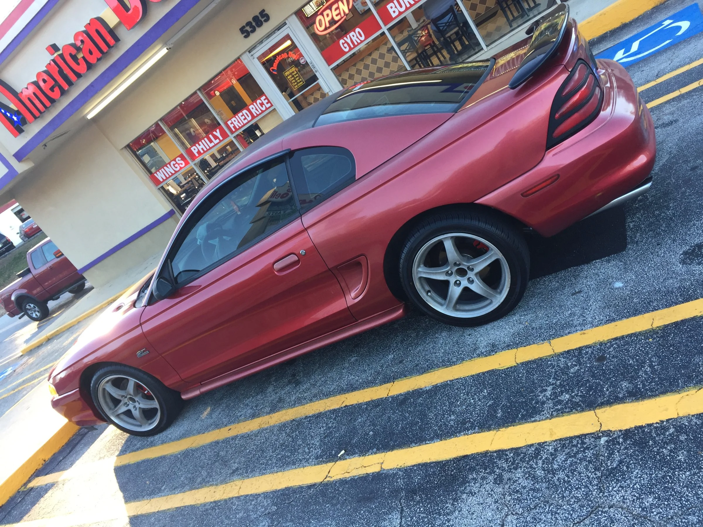

Hey guys again... I've done my research and I came up with nothing so I need the stang family to help me out with this.. I have a 1994 mustang gt 5- speed it's has a completely re done suspension from front to back you name it i did it (now I was being lazy and didn't put the pinion snubber on. Oops ) .. anyhoo after doing all this work I noticed a noise coming from seeming directly underneath the car like a scraping/grinding noise.. at first I was like well maybe it's the dust shields because I moved them but it wasn't that.. this weird noise happens whenever I accelerate and boy let me tell you let someone sit in the passenger sit it gets WORST and louder BUT if I do into neutral and coast the noise is gone!! Then when I accelerate its back...(my clutch feels fine and nice and grippy it was also replaced recently but not buy me the other owner of the car did it BUT WHEN I FIRST GOT THE NOISE WAS NOT THERE ITS BUT MONTHS INTO MY OWNERSHIP) I've kind of narrowed where it's coming from down BUT I could be completely wrong.. seemingly it sounds like it's coming from under the car almost like the drive shaft is rubbing the underside of the car... kind of towards the back of the gearshifter area and the hand brake.. (if I put my hand on the e brake it's almost like I can feel the grind/scraping) which is why I don't believe its suspension related.. all in all I'm not sure.. let me know what you guys think
