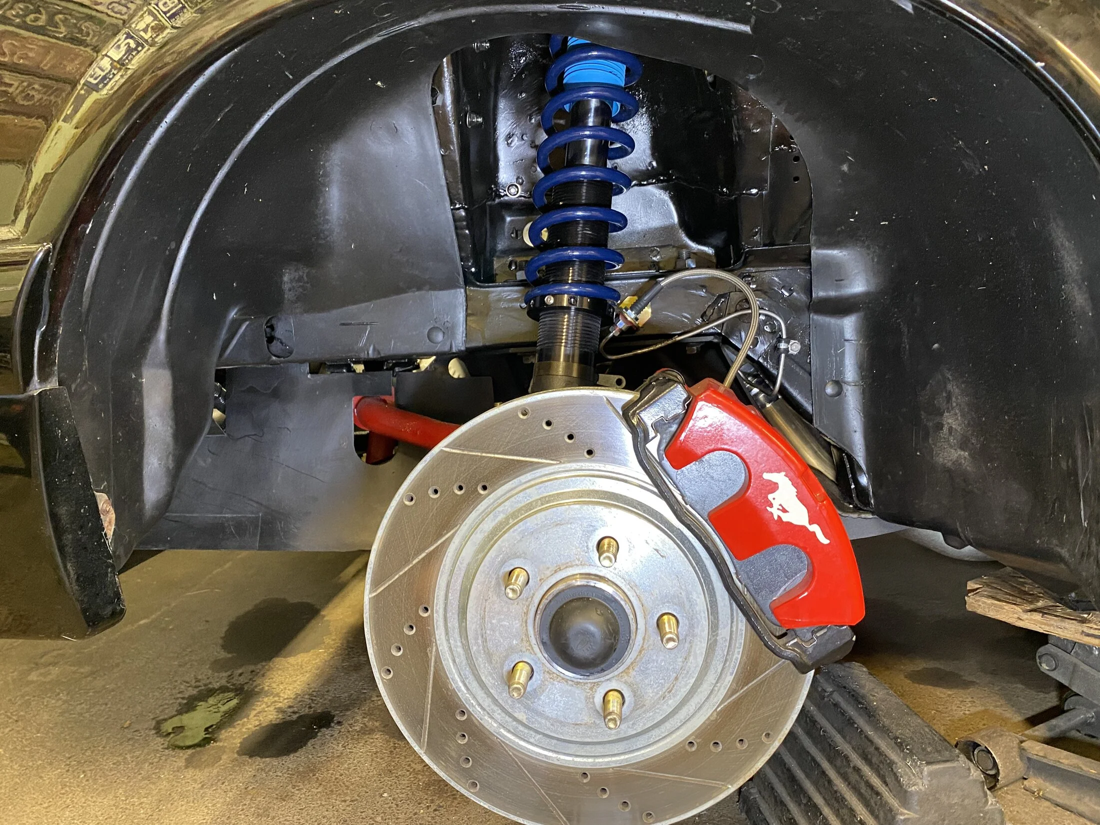

5 lug, 99-04 brakes, 94 spindles, on my 83

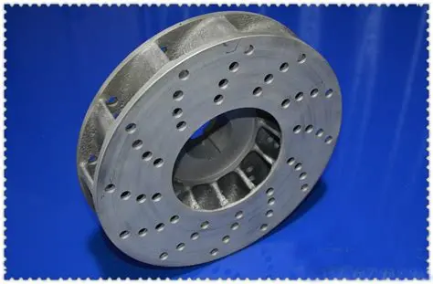

Depends on the brand. They don’t do it consistently
For example. I get told all the time my rotors are on backwards. But they are not according to the internal vanes.
Need to install them based on this. The cooling vanes trail from the direction of rotation. meant to pull cool air from the center hat and sling it outwards. This is the primary cooling method. The holes and slots really don't do much.
I've seen manufacturers do them both ways
Reactions: Noobz347
Yeah, I knew it was about the vane direction but I had in my head that what's in your image is backwards:
Largely, because on most aircraft systems, the vanes cut [into] the direction of air. On this image, it is reversed.
I do see though, that the vanes are the opposite of the hole pattern in the above image whereas they follow between the rows of the hole pattern on this application:
I guess this is the new thing (or they are just not limited by a drilled hole pattern):
It probably doesn't matter which way you install this type.
