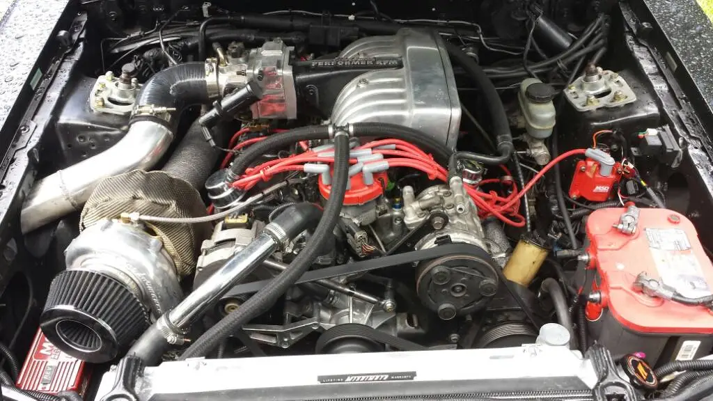

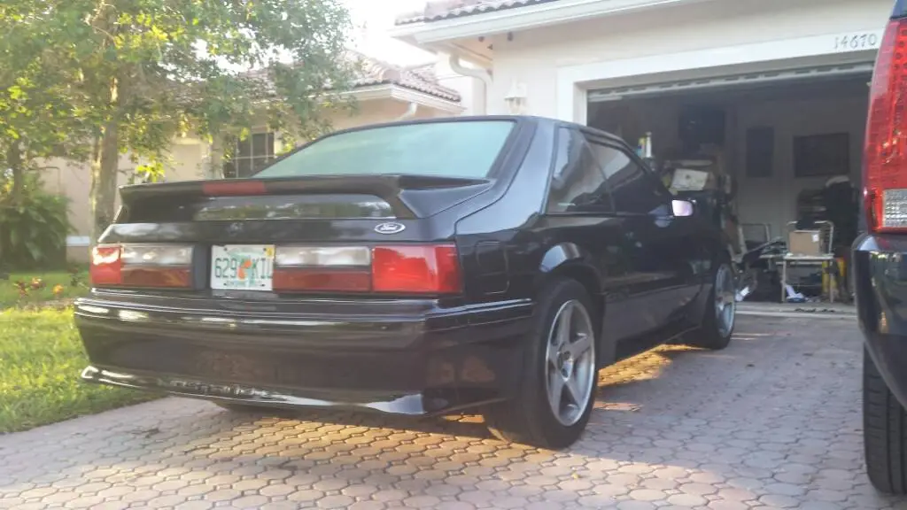

So here are the latest. The car has a wicked exhaust leak at the downpipe vband right at the turbo but other than that the car runs great. A/F at full throttle sticks around 11.0 at 8psi which I am fine with.
The only issue is after cruising for a bit the car will get into the 220's. It is a 50/50 mix with Water Wetter, 190* thermostat, stock but new water pump, Mishimoto aluminum 3 core radiator, Mishimoto electric fan that comes on at 205*, and a removed A/C condenser. I know lowering the fan cut on temp or lowering the thermostat won't help and the Edelbrock water pump failed on me in 20 miles so I refuse to use another. Anyone have any idea where to go from here? I will be adding a cowl hood and a cobra grill insert soon so that should help slightly, but I doubt it will completely resolve the issue.

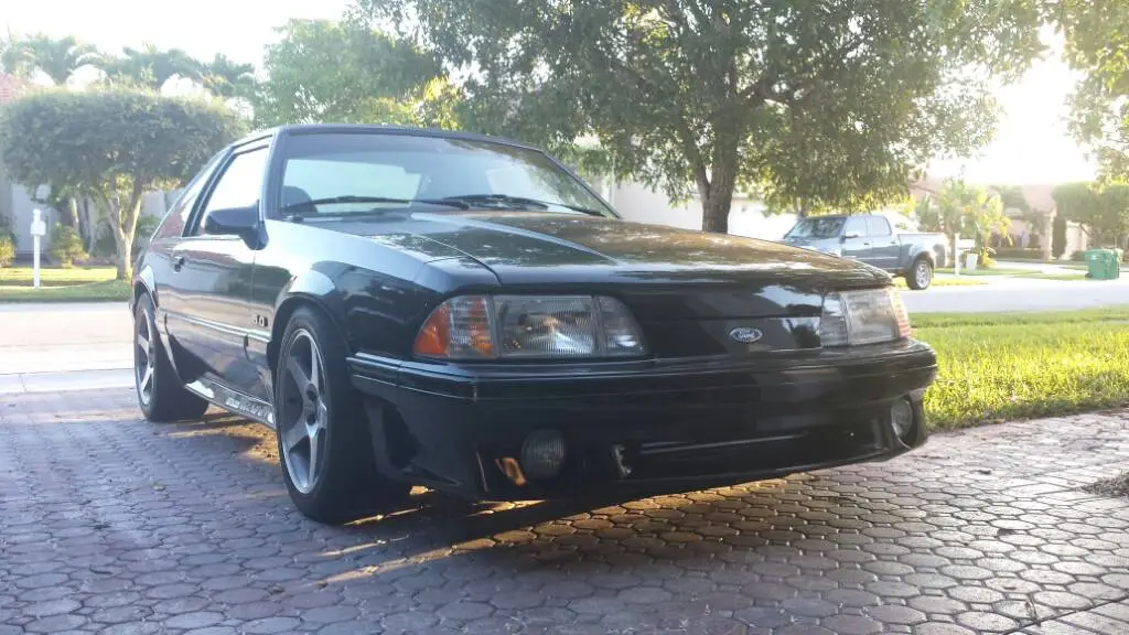

do you have the deflector under the nose? I cant tell in the pics posted, I know that helps a good bit
Actually it looks like it is there.
Yes, it's there and for being about 22 years old it is in surprisingly good shape. We talked about fabricating one out of sheetmetal that is a bit more directed, but aren't sure if it will be enough to rectify the issue.
Does it cool down while driving at a constant speed and not just putting around town? Are you sure you have air bled out? Where is the temp sensor located for the fan?
The exh leak isn't helping dumping all that extra heat under the hood.
