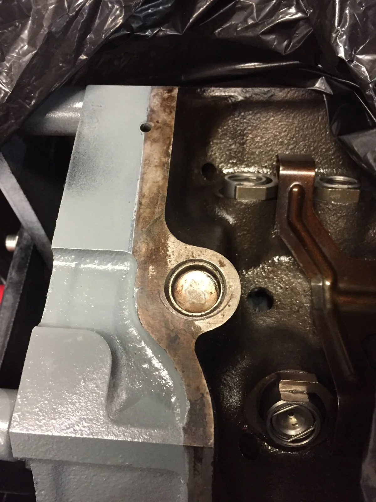

Guys need as help here on this. What goes in this hole? I can't remember and no pictures
My memory tells me it's for a sending unit of some sort but can't find it anywhere
It's just to the right of my finger!
Looks like you’re pointing to a hole in the block right above where the bell housing bolts up. In Foxbody cars that hole has a plug in it. On later model Windsor based applications it might be a location of a knock sensor.
Drat well right now I got nothing that I can find that goes back in there.
I did read a thread where someone mentioned it was a knock sensor for the 5.0 trucks and some mustangs had it and left from factory with nothing in it.
Am I crazy?
That freeze plug would not be visible with the intake installed. Which is what it shows in his picture. Your block there in that picture is not drilled or tapped for the knock sensor. But you can see that flat boss where it would be.
The knock sensor hole is a threaded hole to nowhere. I don’t even think you need to put a plug in it. The hole is there on my 92 block. No plug
