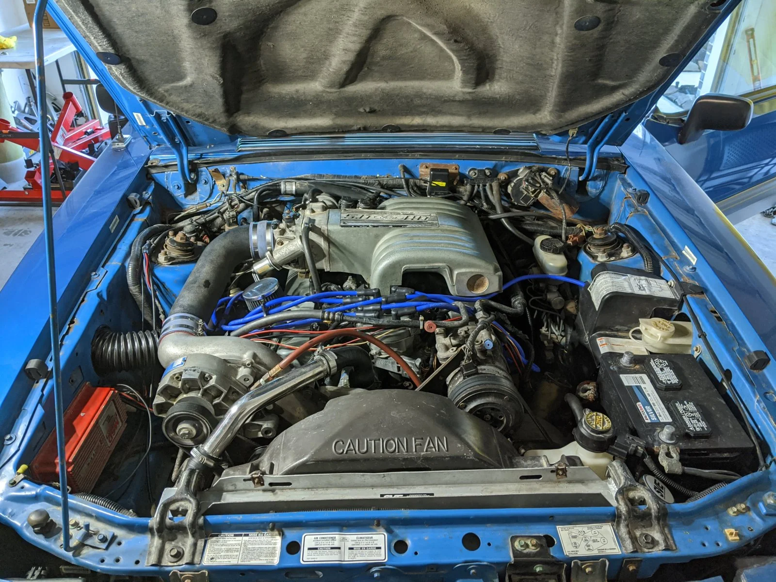

It finally lives! Kind of.
Started it, back fired. Obvious sign if timing not begin set. Now I had to kind rush this but I found the compression stroke of cylinder 1 and put it in the the mark where we have been considering it as TDC. You see all the machine marks then there is one mark that is painted yellow.
I reset the rotor in the distributor to cylinder 1 and I triple checked before I fired it up that it was set to fire on number 1 cylinder and it was.
So it cranked, did it's classic 3k rev then died. Then I made adjustments both CW and CCW and when j kept going CW the only way to keep it going was throttle but it was very rough and sputtering.
The battery was connected to a 200amp engine starter.
Gunn's start by getting a new battery. I may not have been at dead on TDC. But I figured j had enough adjustment to get it right with the distributor.
Also I did tried removing the spout connector on all this and no dice
yeah we already have a timing light. My gut tells me something else is up....I was pretty close to TDC on compression, it should have started and it did, but something else is killing it.
It has around 30 lbs of fuel pressure if i recall correctly.
It lives. It was the throttle body it wasn't tightened down.
Setting the timing, I have it on 14 degrees right now. Father in law cent remember if he pumped 93 octane in it for now.
It runs well. But it's got a loppy idle. It's at 640 650-660 670 after it's warmed up.

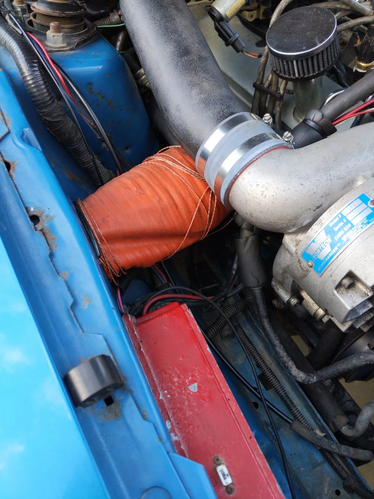

Our accordion style duct is collapsing when going WOT.
Need to find a replacement. :(
It runs on 87 right now Gunna see what happens on 9

I ordered a Spectre 4inch flexible duct on Amazon and hopefully that will replace the crappy vortech one. I still have no solution for replacing the shop-vac sized air filter.

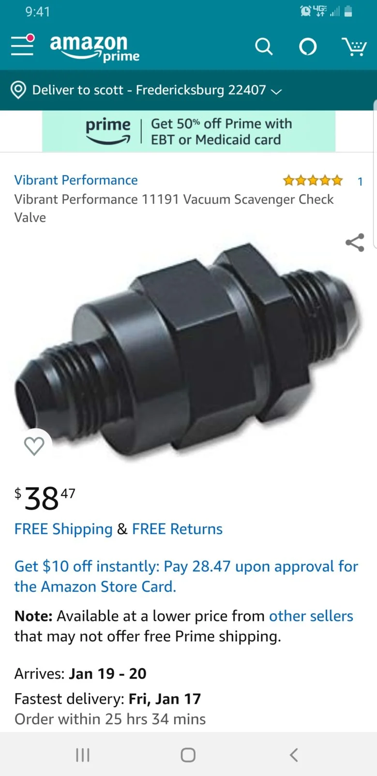

The pcv being missing won't tend to cause a serious driving issue...and could be tuned around. The way it is it's vented to atmosphere. Probably makes the car a little fumed up. I run the pcv with a catch can and a one way check valve on my turbo car. The other side from the valve cover runs through a breather separator tank and to my turbo inlet. My car is speed density so no MAF.
A bunch of companies will void the warranty on turbo and supercharger systems if the engine isn't open to atmosphere. That's weird to me but I guess people plumb stuff wrong and cause issues.
I used a cheap harbor freight air compressor oil/air separator at first. It worked great. The junk yard is a good place to find boost capable check valves in the 3/8 size needed ( I used them for my vacuum pump ). I ordered one of these.

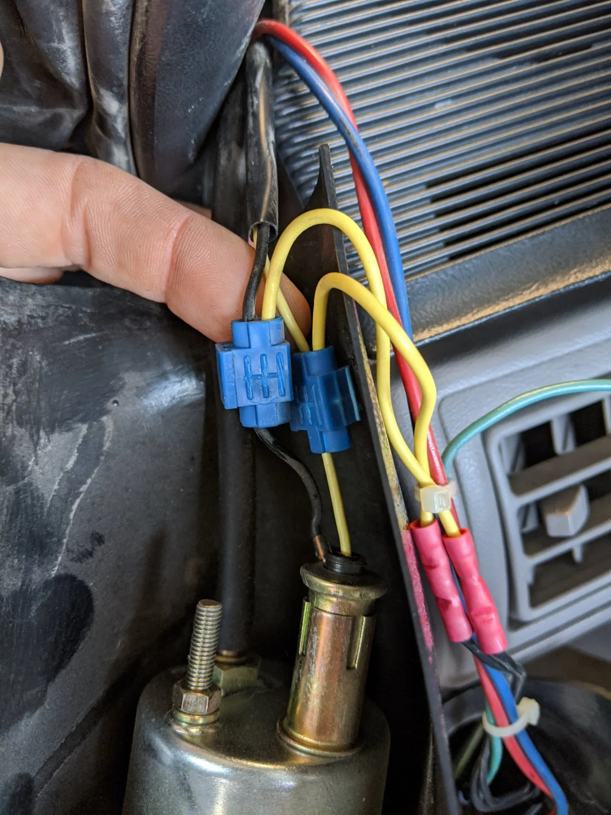

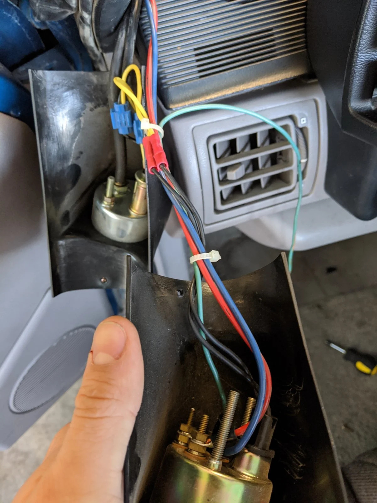

So I'm trying to remove the fuel pressure gauge from the interior. Since we ditched the sending unit from engine bay.
They used vampire clips for all this crap.
I'm pretty comfortable with wiring and setting up electrical stuff with relays....but this is interesting
Some how the fuel pressure gauge and mechanical boost gauge are tied together somehow.
PSA for the love and all that is holy never use vampire clips. If you have to revert back to stock or you want to change it later you can not reverse the damage done by clipping into the harness which is what they done.
They tapped into a constant 12v to the interior light.
That wire that tapped into the OEM harness had gotten damaged (the sheath was ripped in one section) so I went to go and removed the damaged sections out and solder a new wire in but then I got to thinking I might as well remove the (fuel pressure) gauge since its not working. Well I got here lol I've never seen gauges Daisy chained like this. Probably won't make any sense to anyone just wanted to share where I'm at.
